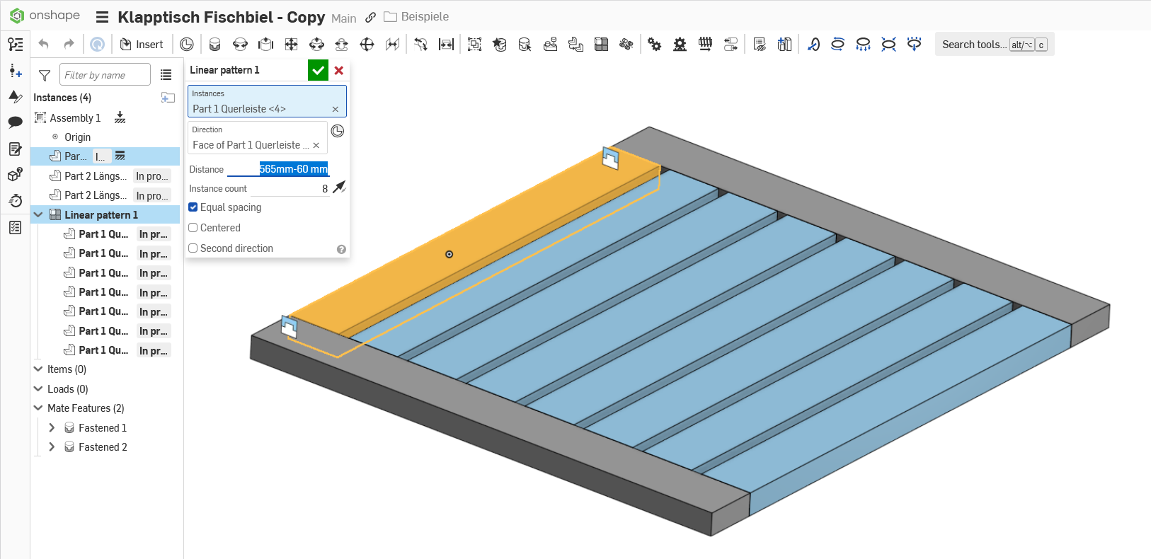

    If you use mate connectors and want a gap between parts, look into the "offset" options found in every mate connector's edit box. If you have copies of identical parts and want gaps between these, use the pattern feature and make the distance larger than the width of the boards:
    https://cad.onshape.com/documents/2bb3c1fca231235c5617d527/w/2d967152bd510609a078a7bf/e/f7a5b4cce551149a09a1ca9d?renderMode=0&uiState=68ca78b9a58df618d08b22d7
    Always fix the first part in the assembly FIRST THING. Use instances instead of creating the same part time and again. The model will become much simpler, then, and much easier to handle. In the above sample, we have but two parts, two mates and one pattern - done! :0)

    I found the offset and continued with that, but the linear pattern method is of course easier and faster. It also has the advantage that the interval between the boards is calculated automatically.
    Another problem I encountered: the central part does not move, so I fixed it. The left part that is adjacent to the central part can be folded down, and I don't know where to attach the revolute mate connector (?). I wanted to copy the left part to the right to be symmetric to the first one, but even though the boards are connected to each other with mate connectors, they can be moved separately. How is that possible? What am I doing wrong?
    https://cad.onshape.com/documents/f46893a8a14783a155638e77/w/7a46865500cd32d0a4412de8/e/0f27d485e8546aafeee29592?renderMode=0&uiState=68cb12e02d0e5ef69a0096f1
  • martin_kopplowmartin_kopplow Member Posts: 1,217 PRO
    I see you did not use patterns in your assembly, and no subassemblies, but instaed made lots of identical new parts again. Before you go on: Fix that. It is never going to work out this way.
    Create subassemblies of everything that stays together rigid and make sure the subassemblies (Folding Top, Center top, Center Scaffold, Folding leg, …) are all fully constrained internally, before you go on. Else, parts will start moving on their own in higher level assemblies. Only then (when nothing moves any more in the subassemblies) assemble the subassemblies in a top assembly.

    You're right. Assemblies can be nested within each other. I have restructured your design a little bit:
    Note there are no "parts" on the top level any more and very few mates. The folting part of tze top is identical left and right, as well as the support frame is. Everything is re-used, there are no duplicates. Now, If you'd not name every part "Part1" there would be even less confusion inside the subassemblies and in the Bill of Materials (Right side).
    You may want to look into the file and compare.
