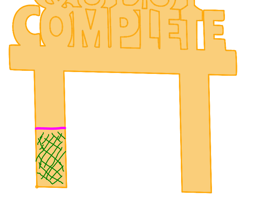

Hi guys i'm very new to OnShape. I had a jpeg, exported to dxf, imported in OnShape. Now I'd like to edit the sketch…for example creating the new pink line of the image removing the green part. Is it possible? I can select the points, but it seems i cant move them. The sketcth is derived because importing the dxf directly into the main sketch, it says that was not fully defined. Thank to who will help!

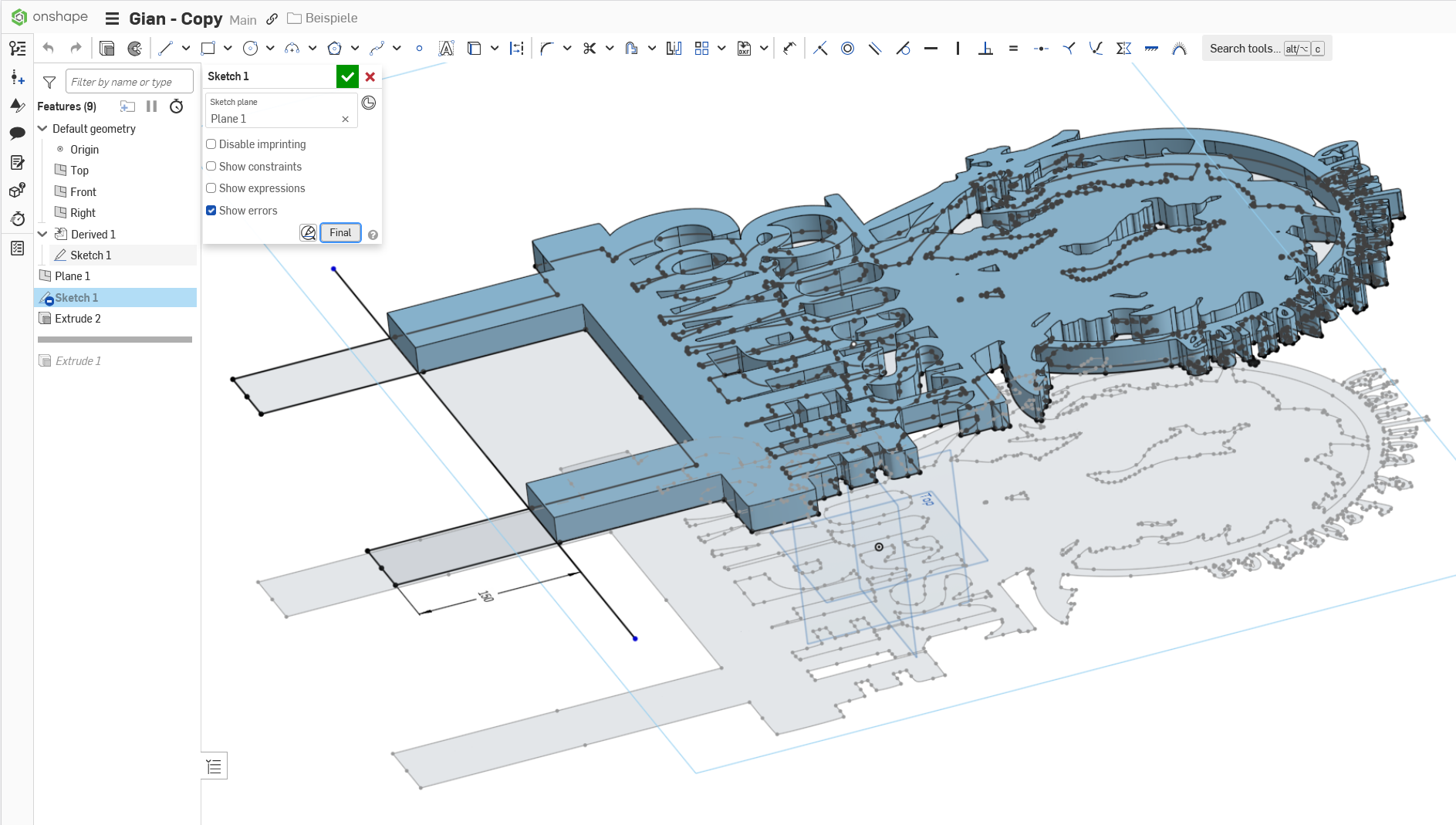

    Well, yes: Derived is derived. You can't change a derived sketch, but you can build a second sketch over it, by means of the "use" tool, and then edit that one at will. In the sample I did that in an offset plane, just to demonstrate.
    https://cad.onshape.com/documents/9c8db44f78f96111d8520c42/w/3d032429748d2c376c489836/e/628a21e9af0f479f6d68cd5d?renderMode=0&uiState=68ca7309ba00771a3ca54fc2
    You could, of course, also extrude the derived sketch and then cut off the parts from the solid. ;0)
