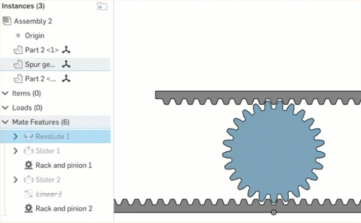

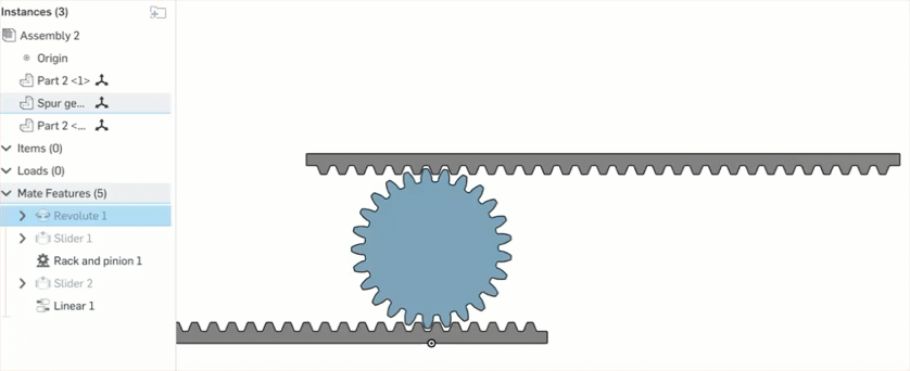

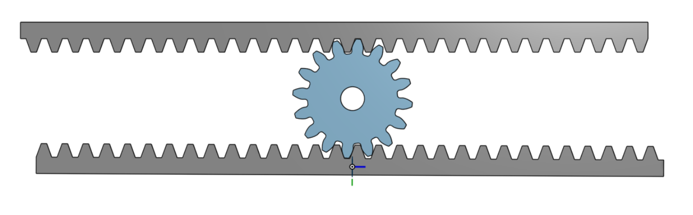

Greetings, can anyone help me with this:
I can get one rack mated, but have tried all sorts to mate the second rack. Any hints, suggestions are much appreciated.
  • Matt_ShieldsMatt_Shields Member, Onshape Employees Posts: 862 PRO
    A second rack and pinion should work. Or a linear between the two racks.
