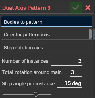

Feature script: Circular pattern + Torrodial rotation by steps around secondary axis.
Code by clause on preplexity, I helped .

  • MichaelPascoe
    Hi @nitai_ierushalmi,
    Do you have a specific question or are you just showing off your feature? It's hard to tell from your post.
