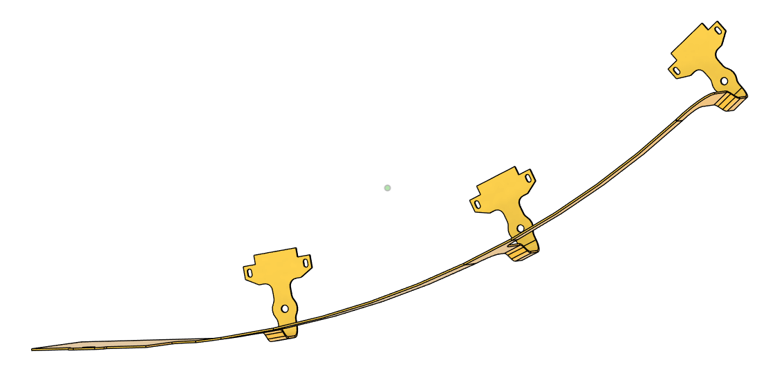

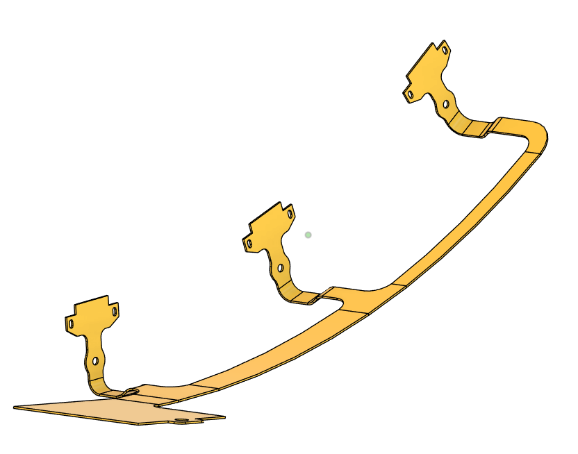

Hello all, I have a part here that I am trying to create in sheet metal. Its actually a flexible PCB but in Fusion I used the sheet metal tools to model it and get a useable flat pattern from it.
I am in the process of trying to figure out how it can be done in Onshape and I'm just wondering if anyone has any suggestions on a workflow.
I got the main big cyclindrical bend in it using extrude in the sheetmetal tool to creat a rolled part however the leg tabs are proving diffucult.
Thanks for your time, images below.
Paddy
  • Derek_Van_Allen_BDDerek_Van_Allen_BD Member Posts: 220 PRO
    You'll need to make sure there are flat spots where the circular arc transitions into those T junctions. Onshape's sheet metal can't currently support doubly curved geometry or lofted transitions.
