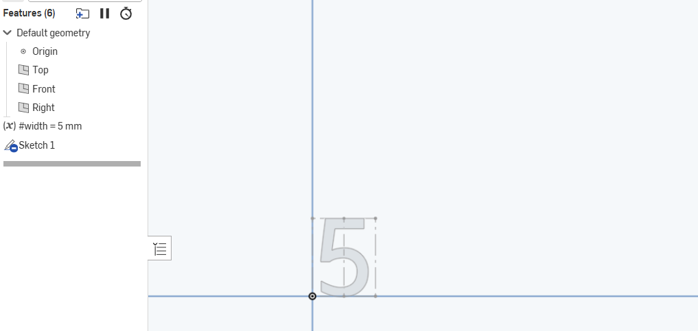

If I have the following Part Studio with a #width variable:
Is it possible to have the text linear pattern, say, to the right, to create a total of n text instances whose text string is the value of #width with, say, 0.1 increments? e.g., in this case the resultant linear patter would be:
5, 5,1, 5.2, 5.3, 5.4, …

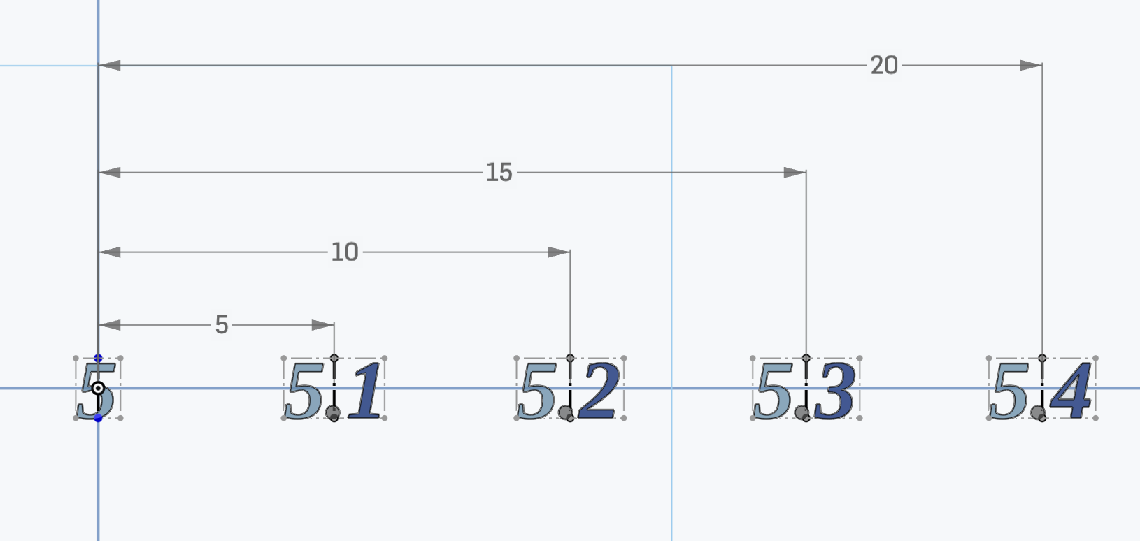

The Text custom feature distributes values along a path. So if we want 5 numbers spaced at even intervals 5mm apart, we first draw a line segment (5-1)*5mm = 20mm long.Then, for your fractional increments we would just use a comma separated list "5, 5.1, 5.2, 5.3, 5.4". Obviously it gets very tedious but it does the job:
You are right, the Text feature doesn't support fractional spacing. I can change that for sure, but then I also have to introduce precision controls so you get the text "5.1" instead of "5.10000000000001" (as sometimes happens with floating point and double precision numbers).
Here's an example of how I set that up:
https://cad.onshape.com/documents/7e50219d014943e502feaddf/w/3df70b775e74fb839ffb208f/e/54958cc277214f7971d7b395
