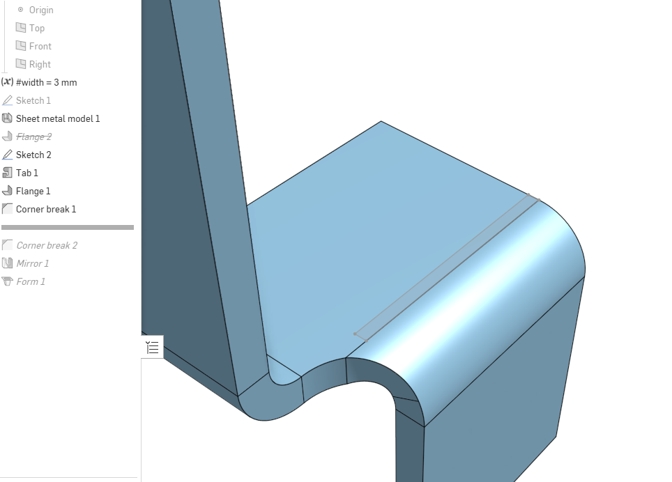

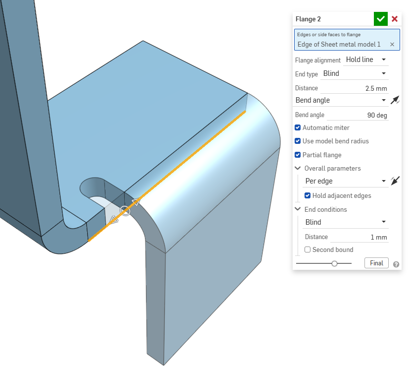

How can i make a (partial flange) without bend relief?When i use the 'hold line' setting, I'd expect it could work without, but it always adds it.
At the moment i'm using a work around. adding a 0.1mm tab, put the flange on that and then I can even add a 'corner break':

    Hey @jelte_steur814,
    At the moment, the partial flange will use the bend relief setting from the initial sheet metal model feature. You can change/overwrite this to a "tear" with the "bend relief" feature. Afterwards you are also able to add a corner break.
    Let me know if it is clear or if you have questions about this. Cheers

  • jelte_steur_infojelte_steur_info Member Posts: 642 PRO
    Got it, thanks
