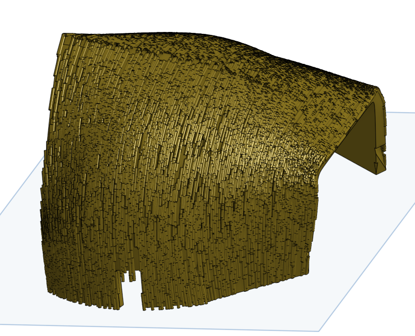

I looked in the previous threads on surfacing and surface effects but could not really find something that is random enough. What I want to achieve is for a flat panel which gets printed flat on the bed to have a thatched roof effect on the top with some similarity at its ends that show the reeds it was made from.

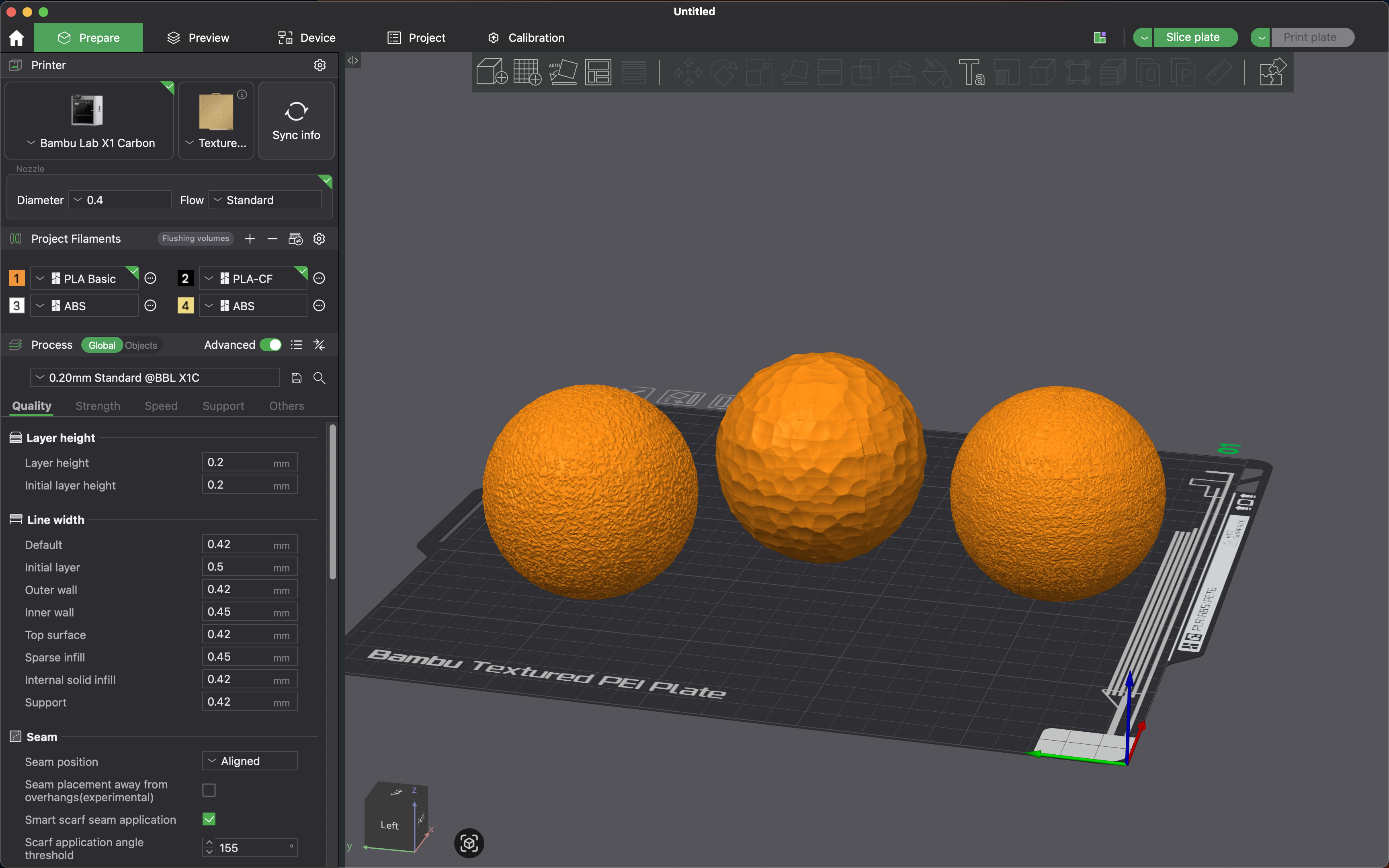

    That sounds more like something you would do in the slicer, maybe some "fuzzy skin" although I'm not sure if you can get that effect on the top faces.
    Using "attractor pattern" FS or "texture FS" would likely be extremely slow but might be an option?

    I tried both your suggestions and thank you very much for them.
    Texture is not resulting in something that is doing what I want so I tried Evan Rees' attractor pattern.

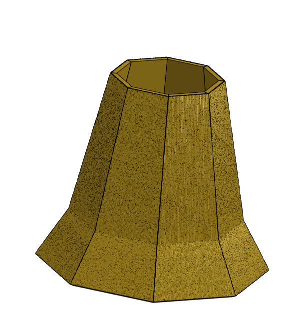

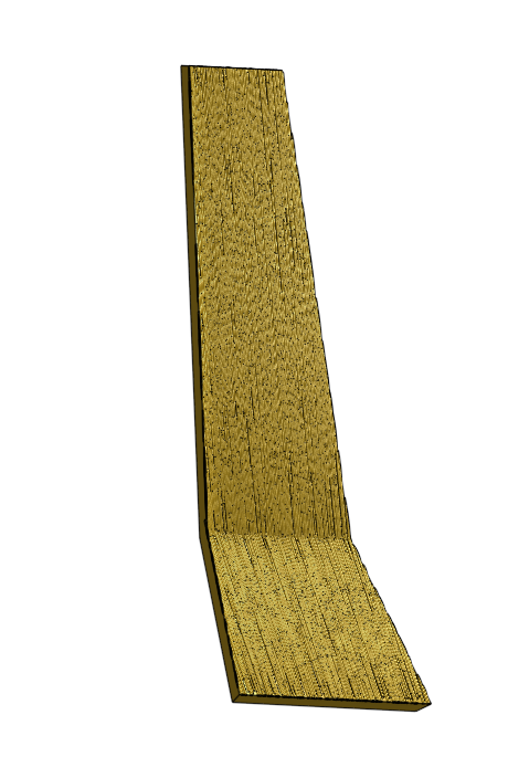

    I started by creating one reed, a simple cylinder of certain length.
    I made the pattern and chose random with orientation of the reed in the direction I wanted. Then up the count number, in my case 2000 for the large surface up the top and 1000 for the small surface below. I then split with the sides of the real part to get rid of the overhanging edges.
    In the part studio it works really well, visually it is totally what I was after. We will see how it prints.
    Stunning effect
    Many thanks to @eric_pesty and a special thanks to @EvanReese for making this thing work easy enough that even I can do it. 😁

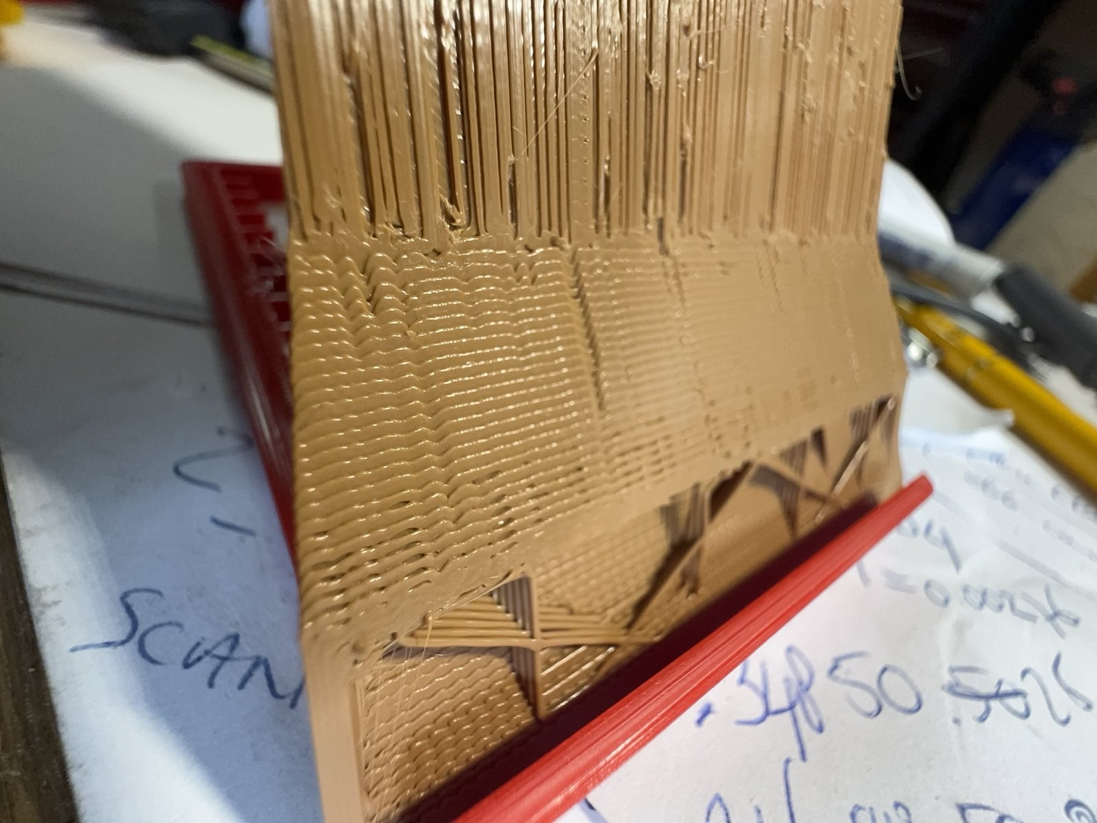

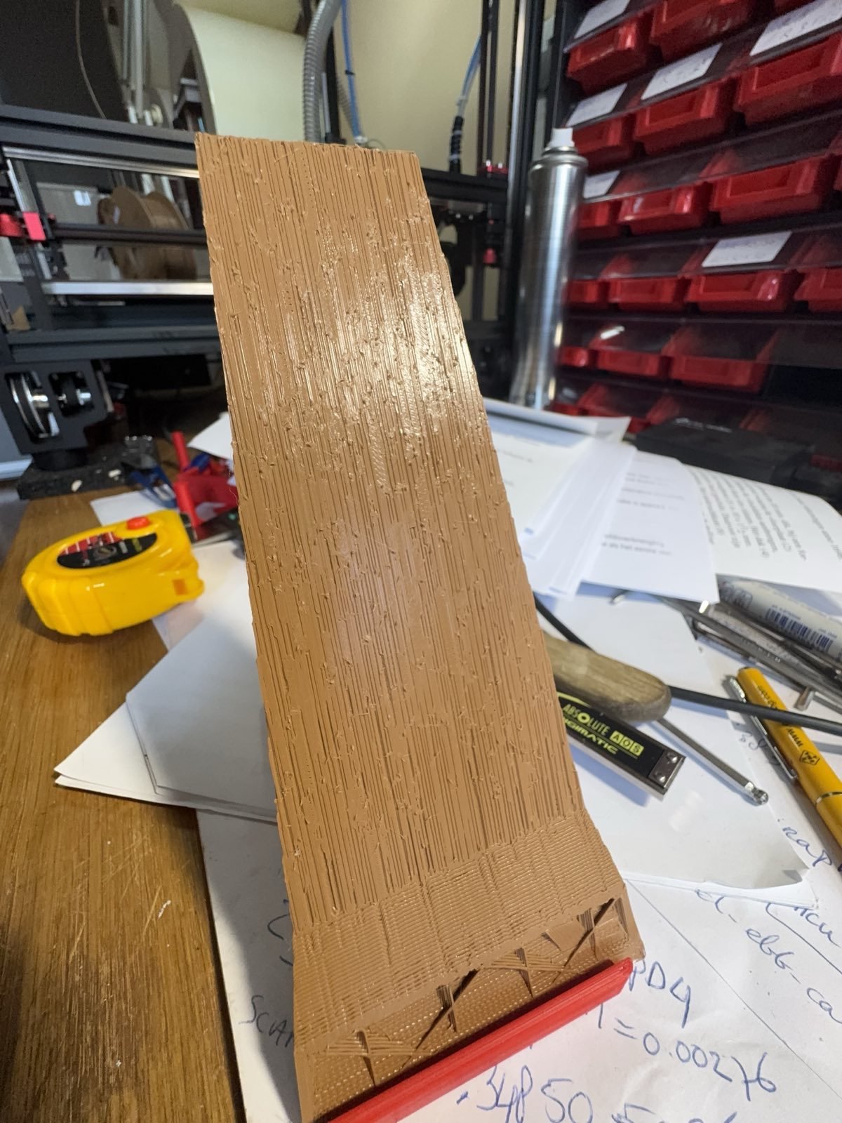

    The blender route did not result in conclusive evidence that it would print something better so I decided to exploit the attractor pattern to the max and optimise it as much as I can.
    From the first test print it is clear that as long as the textured surface is flat, it will work.
    On the bottom photo you clearly see that layerlines completely eliminate the effect and ruin the part. I stopped it early because there is no way this will be useful. So I will split the part and print both parts flat.
    This leaves me with a new problem.
    This part is the rooftop, which will be hard to print flat. I will see what I can do with splitting, but not sure if it will be succesful.
    But very happy with the flat results sofar.
    What I forgot to mention is that layer height affects the result dramatically. The slicer rounds things up or down of course and on some layer heigths the effect is almost gone while a small step from 0.2 down to 0.16 suddenly exposes all the lines from the cad model.
  • EvanReeseEvanReese Member, Mentor Posts: 2,826 PRO
    Cool to see so far. I'd crank the layer height as low as possible and look into adaptive layers height too. If you can use a resin-based printer I bet it would come out great!
