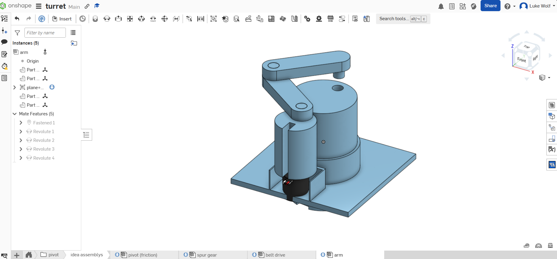

how to mate this?
luke_wolf964luke_wolf964 Member Posts: 2 EDU

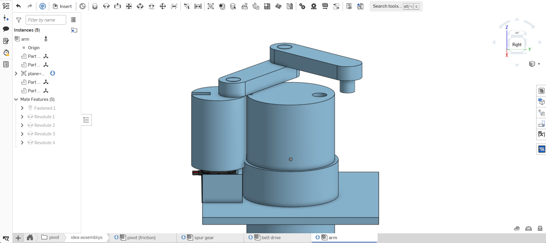

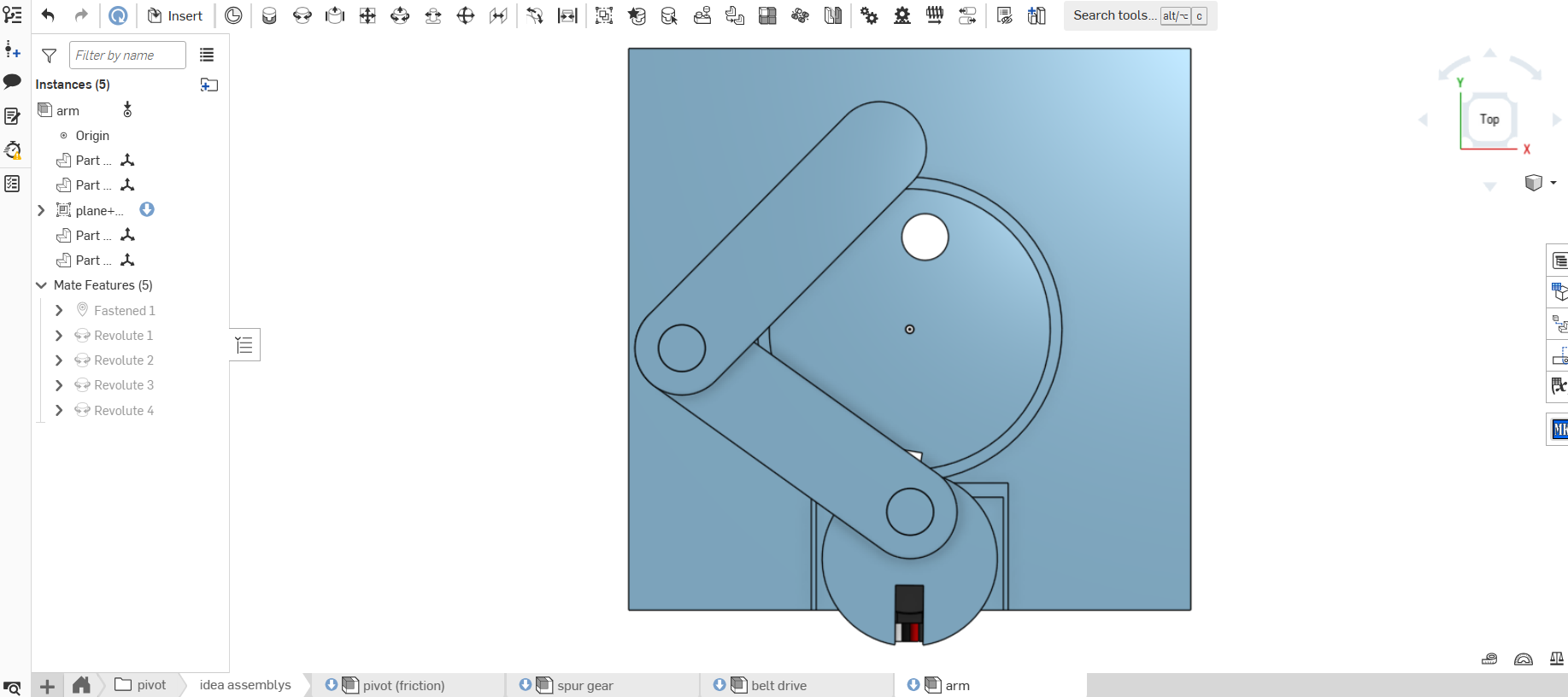

hello, i am doing a project for my robotics club of making a turret kind of thing. my specific role at the moment is to create ideas for the base of the turret, while i have already made a couple i am struggling on this one design with an arm kind of mechanism to transmit the rotatinal force from the motor to the pivot base. i think this would work in my head but onshape will not let me mate all of the parts together. i can mate most of them, just not the final peice. i have all joints as revolute mates, i can not use one arm because the distance between the holes changes.
Screenshot 2025-09-26 192920.png Screenshot 2025-09-26 192855.png Screenshot 2025-09-26 192251.png
if anyone can give advice or knows if this wont work pls let me know. thank you!
  • glen_dewsburyglen_dewsbury Member Posts: 1,266 PRO
    Make the final mate cylindrical will be allowed. Then extend the pin to needed length.
