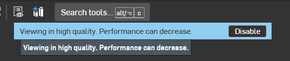

Hiding "Viewing in high quality. Performance can decrease" bar to prevent misclicking Disable?
skelobonesskelobones Member Posts: 25 EDU
Is there a way to hide this bar so i can work on my PC in high quality without having to worry about misclicking it, 'worrying' moreso a distraction taking me off my workflow… I understand that it's here, but can i hide it?

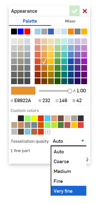

    You can manually set the parts view quality to high quality when you set the part color. If you do this, I don't think you will need to force high quality mode.

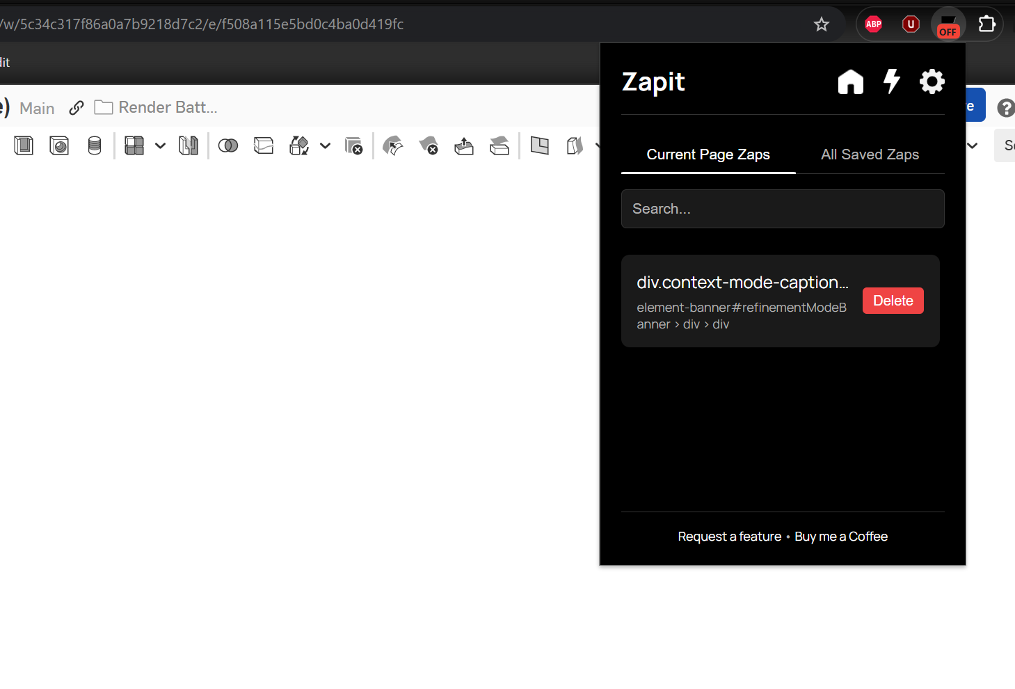

    Alternatively, you could zap the browser element to remove it, like this:
    https://chromewebstore.google.com/detail/zapit-click-to-remove-ele/ojgbipkkmfaiafopdfopmkjpeppdpkec?hl=en-US&utm_source=ext_sidebar

    I have high quality enabled in the "Camera and render options" menu. I like it, and performance is great!
    This is annoying— I don't want or need this constant reminder.
    I don't want to use a plugin to disable the item: it should not be there IMO.
    This looks like a bug to me.

  • jmsaltzmanjmsaltzman Member Posts: 20 ✭✭
    Is the lingering nature of it intentional? What purpose does it serve? It's impertinent.
  • MDesignMDesign Member Posts: 1,326 PRO
    I don't know the purpose of keeping it open. But it's location could be better placed for sure. For those with limited screen real estate it sometimes overlaps other important buttons/info/ and other messages that would be nice see/interact with. Not sure if it's possible but it probably should only be displayed when performance is suffering to serve as a reminder that it's on. Having said that none of it would define as a bug imo.... Merely a desired change in behavior. Make an improvement request. I'll vote for it.
