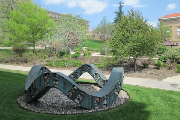

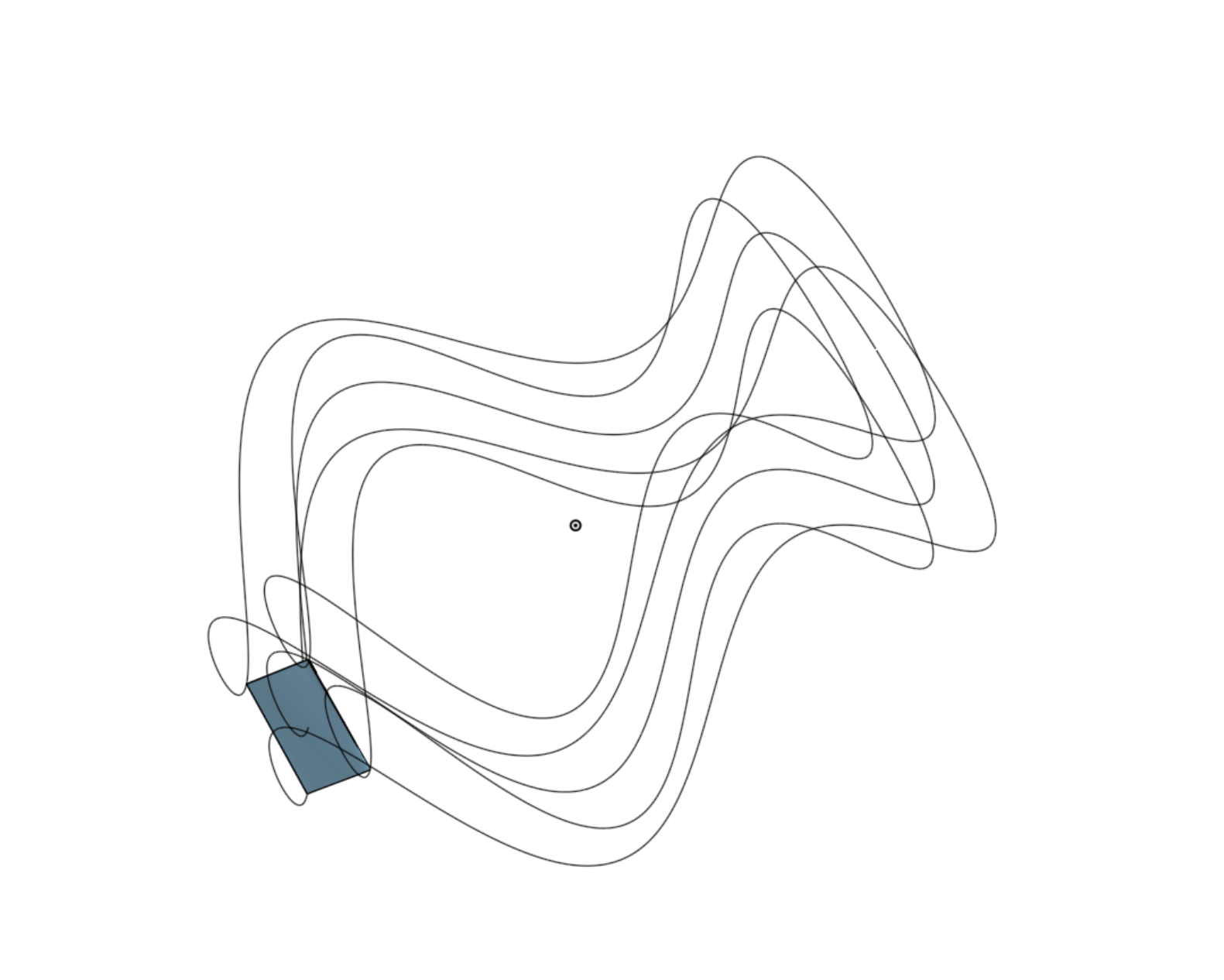

I am trying to create a surface using equation driven curves to specify a boundary condition in a physics problem. I have a curve and I created four other "guides" as well as a cross section. I am trying to loft the features to create a singular surface. I am new to CAD so any feedback would be appreciated. the overall goal is to create the boundary for this shape "the wave." I will post what I have so far below.

    A link to your document would help, but from the screenshot it looks like you could use 4 separate loft features (set to Surface) using the edges you've already created (ignoring the center one) and get the shape you want with a rectangular profile.
