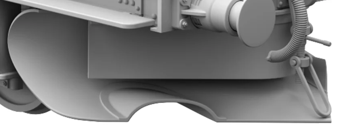

Hey Folks,
I'm trying to wrap my head around (no pun intended) applying an extrusion feature to a non cylindrical shape. In my document i have created a plow shape with spline curves and extrusion directions which I need to cut out a shape (simple) and apply an extruded frame around it (not so simple) to recreate the part shown here.
In my head I had through the wrap tool would help me, but didnt know that it was limited to cylindrical surfaces only, so that pretty much stopped me in my tracks (Ok that was a train pun)

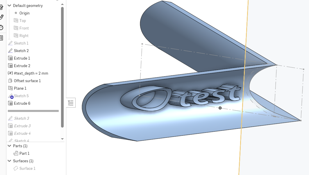

  • glen_dewsburyglen_dewsbury Member Posts: 1,211 PRO
    I reset the offset surface to a variable to make easy changes. The depth reset just makes this easier to see what you're doing. Make extrude of sketch from face to face. When satisfied with how it looks, just reset the variable 'text_depth' to what is needed and hide the the offset surface..
    https://cad.onshape.com/documents/5fb5a1fb76f3afe1a24a7924/w/1cab66686e6b5cbc5f5cca94/e/73903f54e566c5166e4d44bd

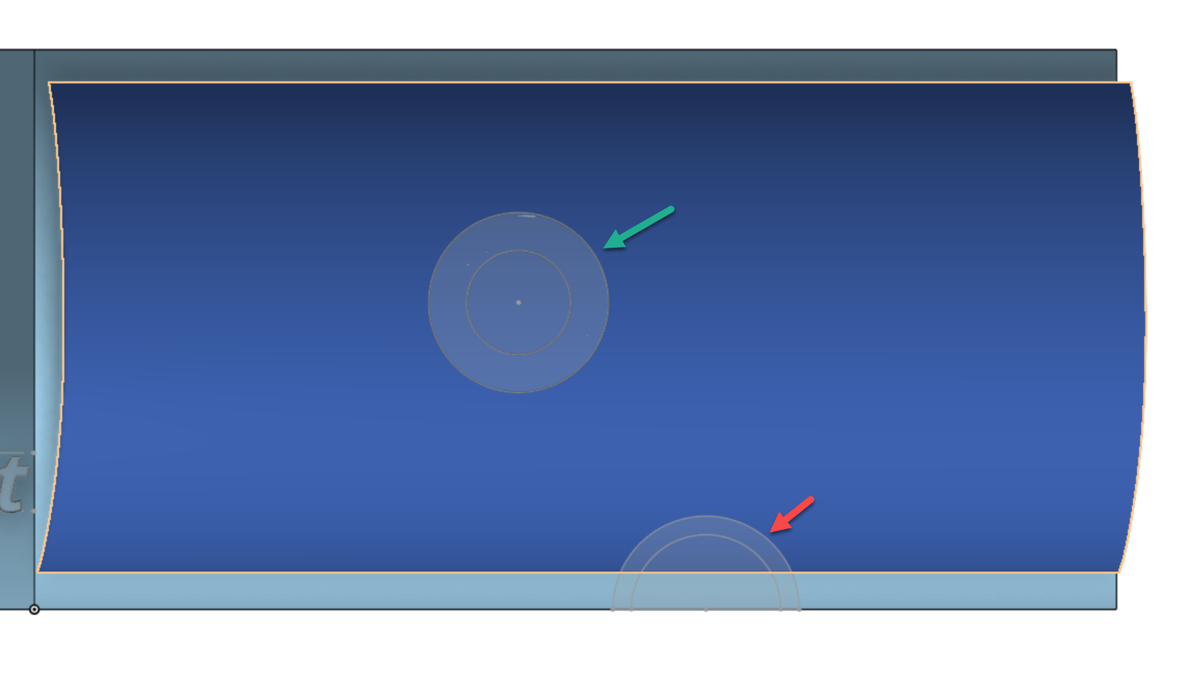

  • gary_smith251gary_smith251 Member Posts: 11 EDU
    Thank you for takting the time to do this, I learned a lot just following this example but im guessing this wont work for what I want to do based on how the offset surface works being 1mm away in all directions, making the offset surface smaller than the actual plow front face. When using your example to learn, I was able to replicate making an extrusion on the other side when the sketch was within the projected surface, but not when it was below it which makes programatic sense as it dosen't know what its extruding up to, but this is limiting me making the correct extrustions on the actual plow face
