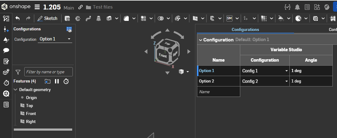

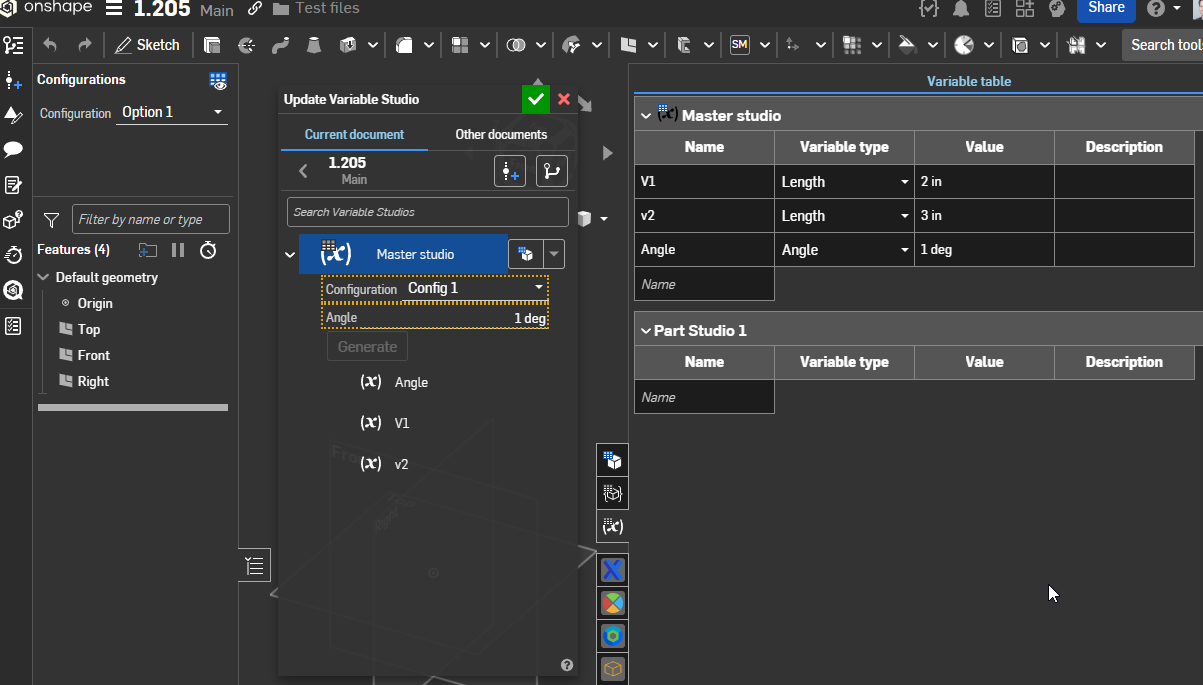

    I might be missing something but isn't what you are describing already there? Like this:
  • AsherAtSignalDesignAsherAtSignalDesign Member Posts: 34 PRO
    I don't understand what you're showing me.
    How does this allow you to change variable configurations at the time when you configure the part?
