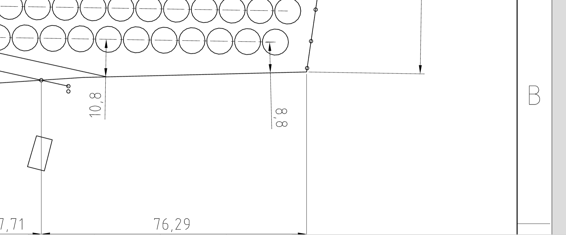

Why is the text of this dimension not in the right direction? (the 8,8) And how do I change this?
  • S1monS1mon Member Posts: 3,870 PRO
    The dimension is tilted slightly and therefore it's trying to orient the way that it should for an angled dimension.
  • d_b656d_b656 Member Posts: 3
    Thank you Simon.
    I made a point on the line and now the problem is solved.
