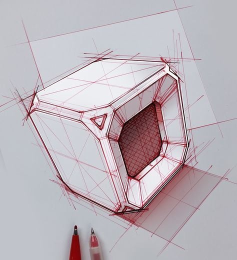

But why that Shap? Because i saw this on Pinterest which gave me the idea:
Also:
But i got this far:

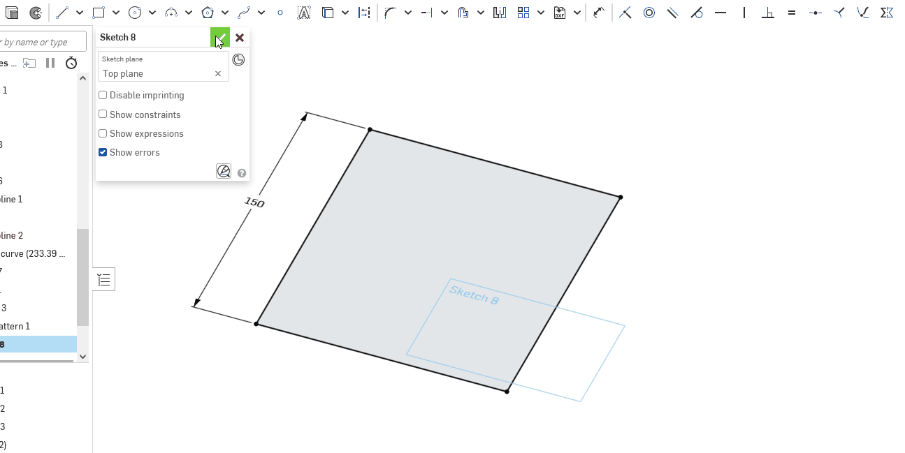

I can´t properly Connect.
Do you know a solution?

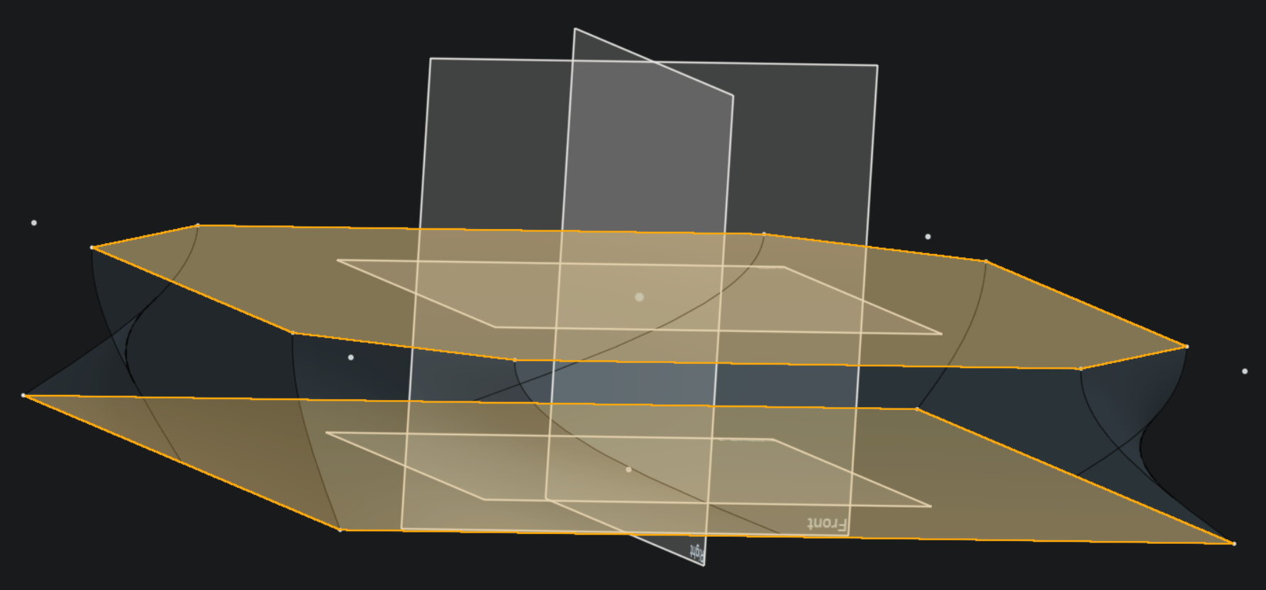

    Hey @klaus_iwik,
    Does this help you?
    https://cad.onshape.com/documents/b6e8fd3bb464bd5199ec15a3/w/b65c07bdb9552f3579b38328/e/e3bab9948f0bc871e4c57ede
  • MDesign
    Here's my take. Only used 1 sketch 😎

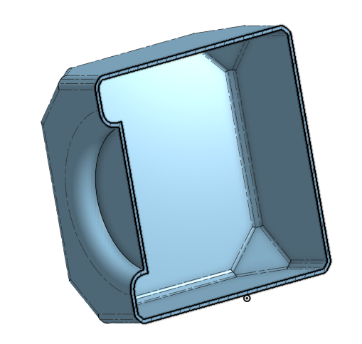

    But i need to do something with the inside. Make it Hollow so i can mount the Parts inside. =/
    Mabe i remake it and think how i can out it on a 235x235 printbed and can do assembling in it….
  • martin_kopplow
    edited October 2025
    @klaus_iwik For hollowing out the inside, you'll probably just want to use the 'Shell' feature: After specifying wall thickness and the faces to open (probably the three inner ones of the 1/8 cube, before mirroring), it will do everything for you. It may fail,though, in some cases, especially if the outer surface is already very detailed and it could come to self intersction of the inner surface. In these cases, it might help to apply the shell at some earlier stage and add the fine detail thereafter.

    @klaus_iwik Only after much fiddling for a year do ideas like that come to me. Well technically been doing CAD for waaaaay longer than that though. You will want to create some sort of place that will be open so that you can use the shell feature. Maybe split the cube where you want to create a sort of joint like a typical pc case. Also you have to watch the size of your fillets on the outside will effect whether you can shell at the desired thickness. You have some 1 mm fillets that will become an issue if you want the shell to be 2 mm or similar. Onshape will not like that. I surpressed that feature and got this at 5mm thick.
