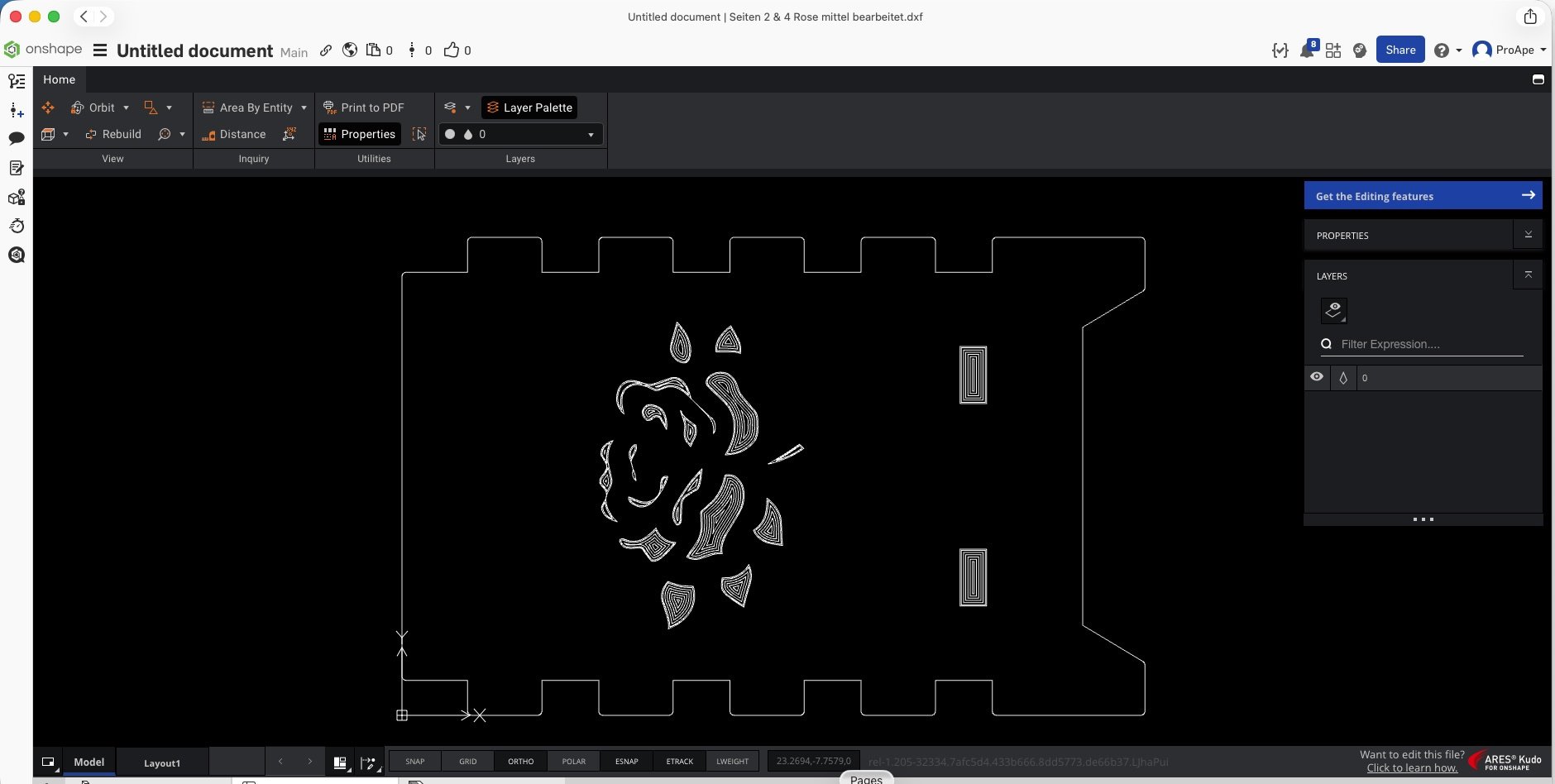

Hello,
When I import a DXF file into Onshape, it appears in a separate tab, and when I click on it, something appears that is completely unfamiliar to me. What is it?
Speaking of importing DXF files, I still haven't figured out how to restore the imported drawing to its original size. Which is the best and easiest way to do it?

  • MDesignMDesign Member Posts: 1,289 PRO
    The extra tab is the same for all imports. It contains what you import. Same thing happens for images and PDFs and more.
    To scale initial import place one dimension on known distance set the value. No other constraints or dims may be present. If other constraints and dims exist use transform tool. But you must calculate the scale factor prior or do the calc in the scale factor input.
