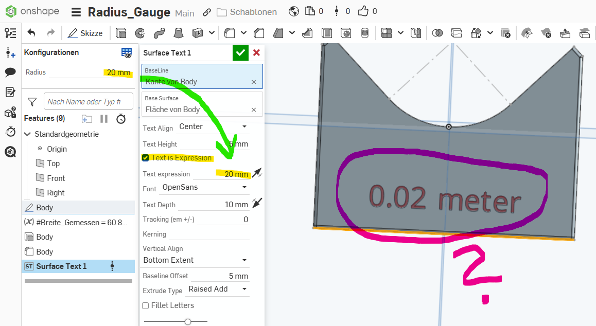

I am trying to create a set of radius gauges parametrically. Thus the radius should be engraved by a "Surface Text" feature, derived from the Radius, I define via a configuration variable.
How can I manipulate, that e.g. 20 mm isn't converted to "0.02 meter" (anyway: what a crap …), but is shown as "20 mm"? I tried string functions to no avail …
  • GregBrownGregBrown Member, Onshape Employees, csevp, pcbaevp Posts: 375 image
    edited October 2025
    The text expression is being evaluated using the system units (meters) but it's easy to make this do what you want. Just use:
    #x/mm~" mm"
    as the input (where #x is the variable name you are using in your case). As you can imagine this allows you to convert to further units should you desire:
    #x/inch~" in"

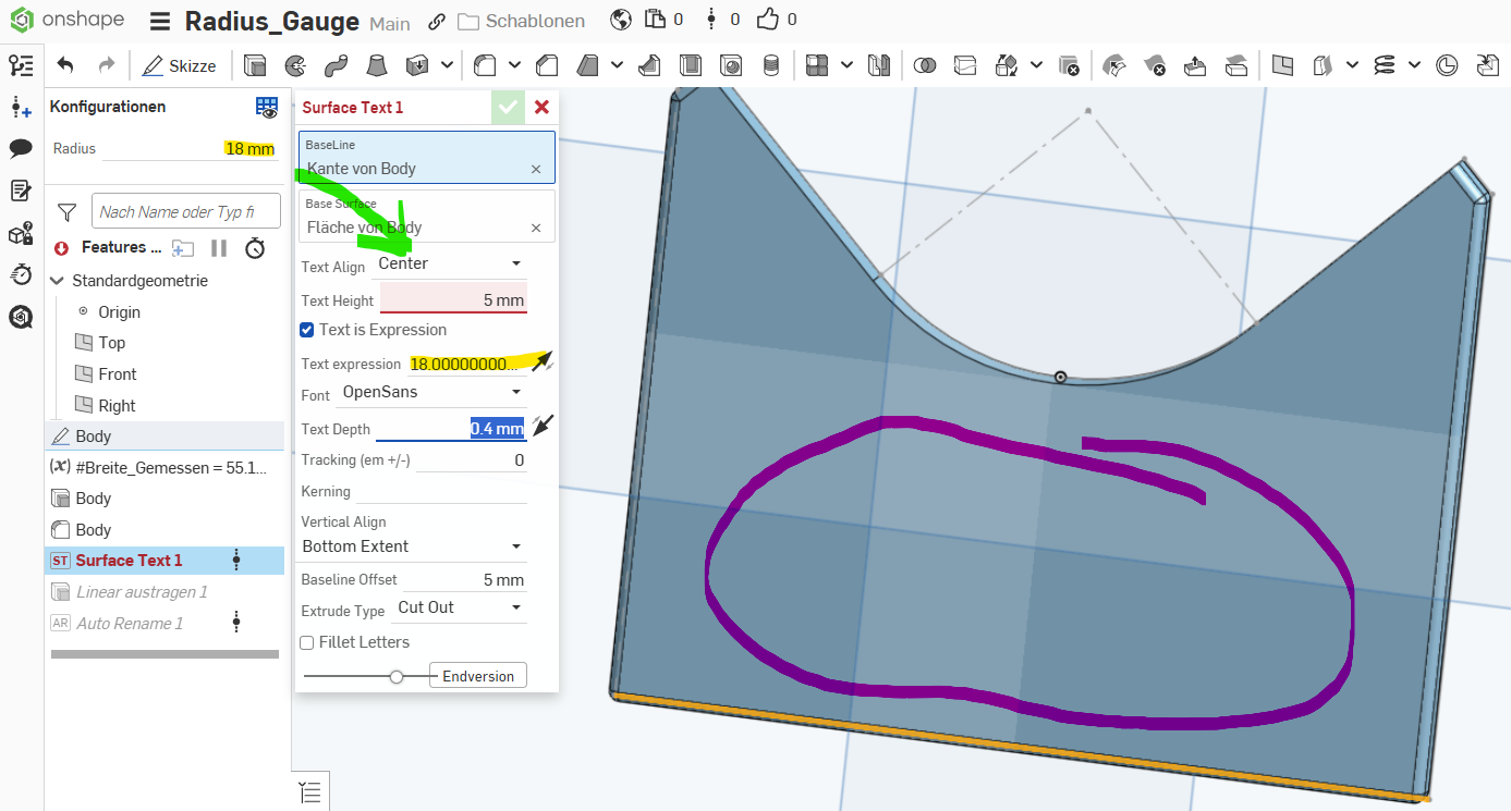

  • klaus_krämerklaus_krämer Member Posts: 92 ✭✭✭
    edited October 2025

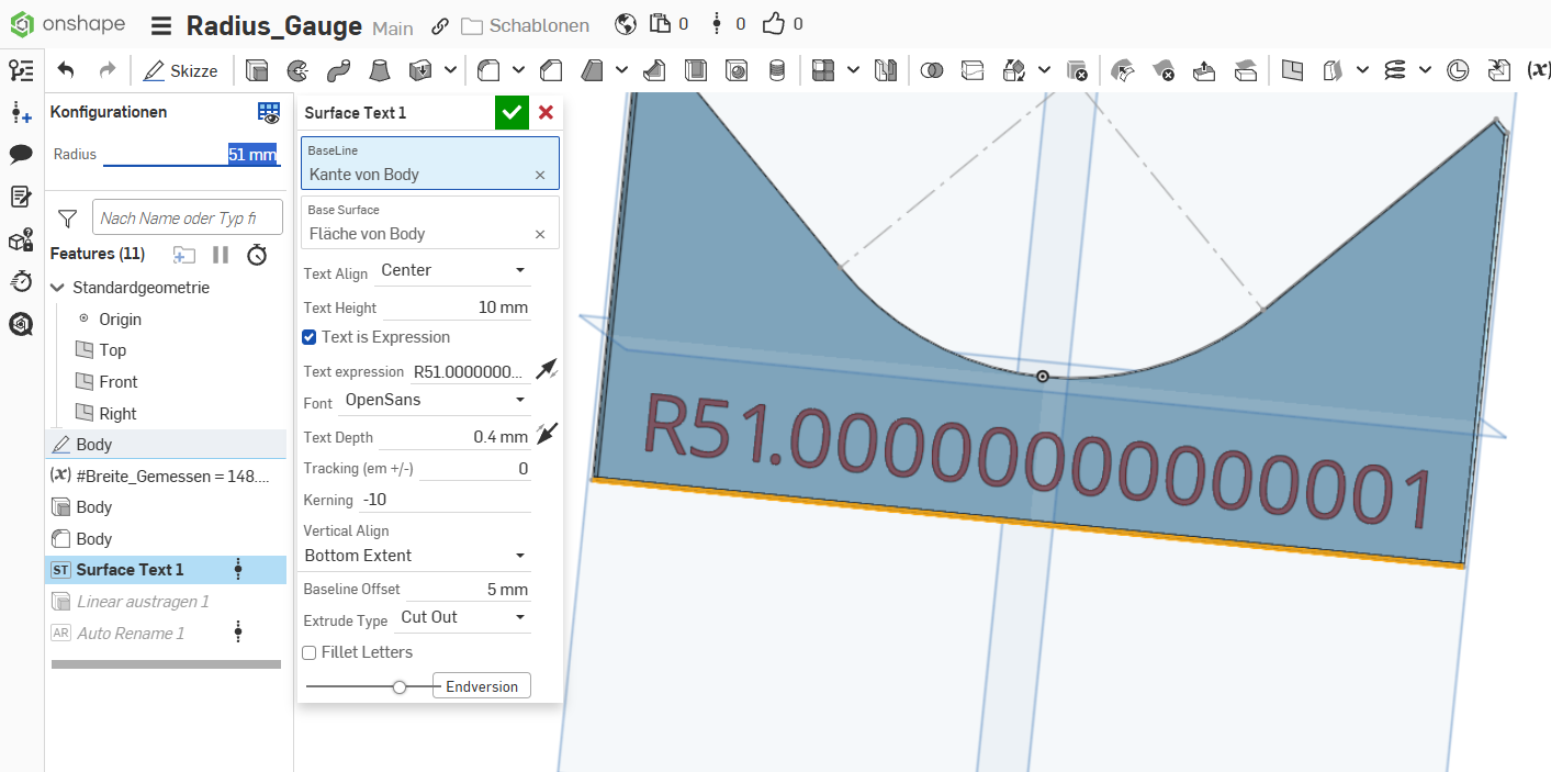

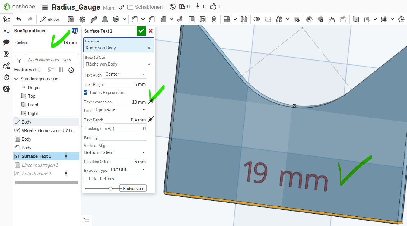

    Weird: All integers between 10 and 20 mm work, except 13 and 18:probably due to rounding issues? I tried usung the 'round()' function - but did not get it to work.
    Also not working: 9, 26, 36, 51, … (Using
    I'd classify this as a bug.(Using "R"~#Radius/mm now)
