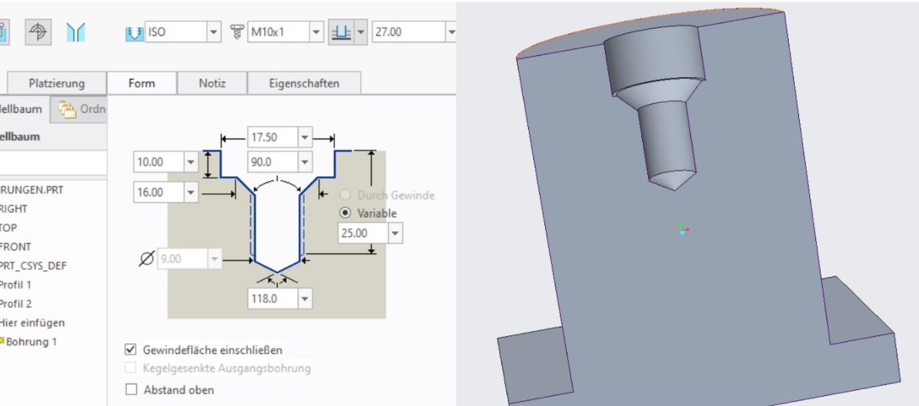

I wonder how you all handle this type of countersink:
It is a combination of the standard countersink and a small amount of counterbore. I makes sense in cases with little space at the surface, for visually pleasant appearance, or if the screws need to be recessed deeper for other reasons. Pretty common after all.
If modified manually, such holes don't get proper hole callouts in drawings, though:

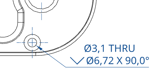

What's the best method to deal with this (except for improving the hole tool), so there are no misunderstandings triggered by actually reading the drawing?

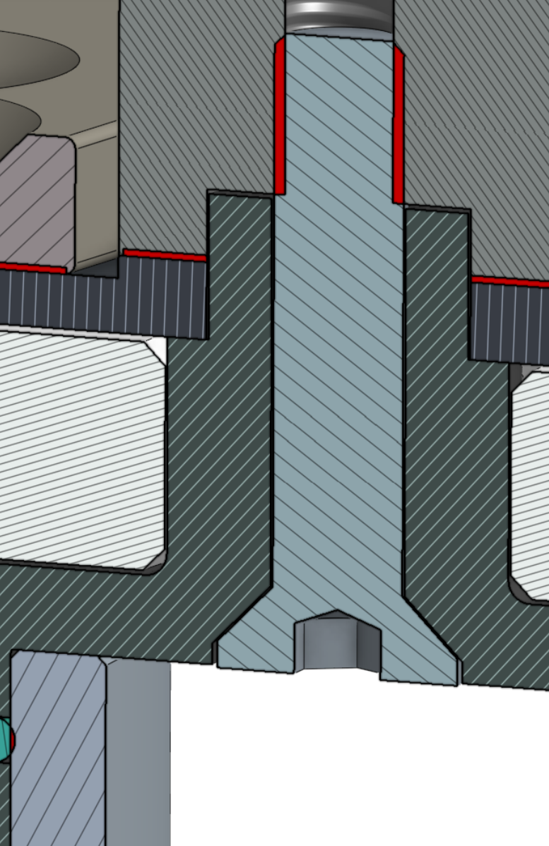

    It is common, though probably not fully standard, even if it uses all standard (ISO) elements. In this case, for an M4 countersunk screw, which has a 5.6 diameter head (as per ISO), the machinist would typically use a 6mm diam. countersink bit to achieve the desired result. These bits come in all diameters and a pro shop is expected to have at least the common ones. So what he needs to know is how deep the cylindrical part is to be.
    This was a simple example. The case would be much more difficult, if we were talking design of injection molded enclosures where the counterbore part might be deeper than the screw itself:

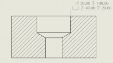

    Such holes were possible in my former CAD, even in drawings and callouts. They just require a combination of the counterbore and the countersink symbol, which would be fully consistent, if the hole tool allowed the use of both counterbore AND countersink on the same hole in one go.

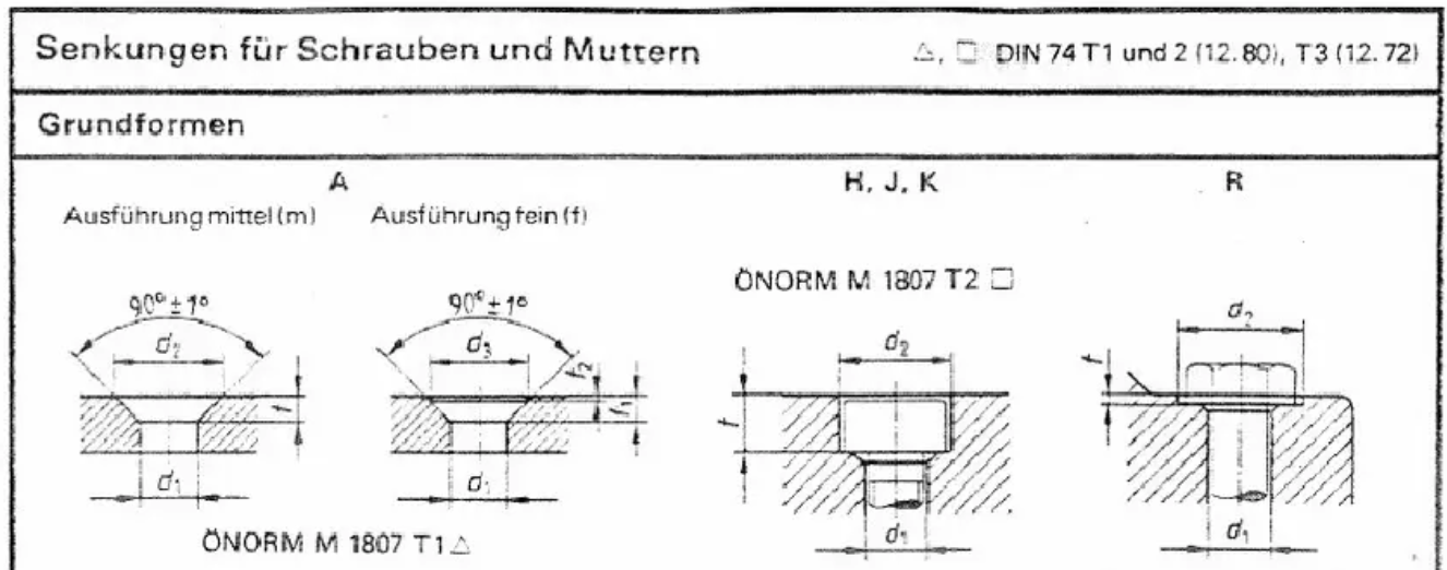

    And a definition on an older printed DIN standard book page:
    So, the latter one proves that it is a standard, at least in the metric world.

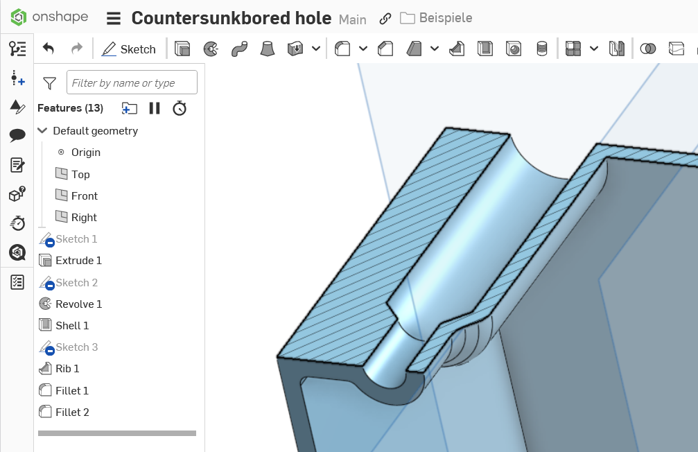

  • EvanReeseEvanReese Member, Mentor Posts: 2,867 PRO
    I've had clients who want this too and have done enough digging to know it's possible to do with a featurescript, including tagging the geometry with the correct hole callout for drawings, but I'm not aware of an existing feature for it.
