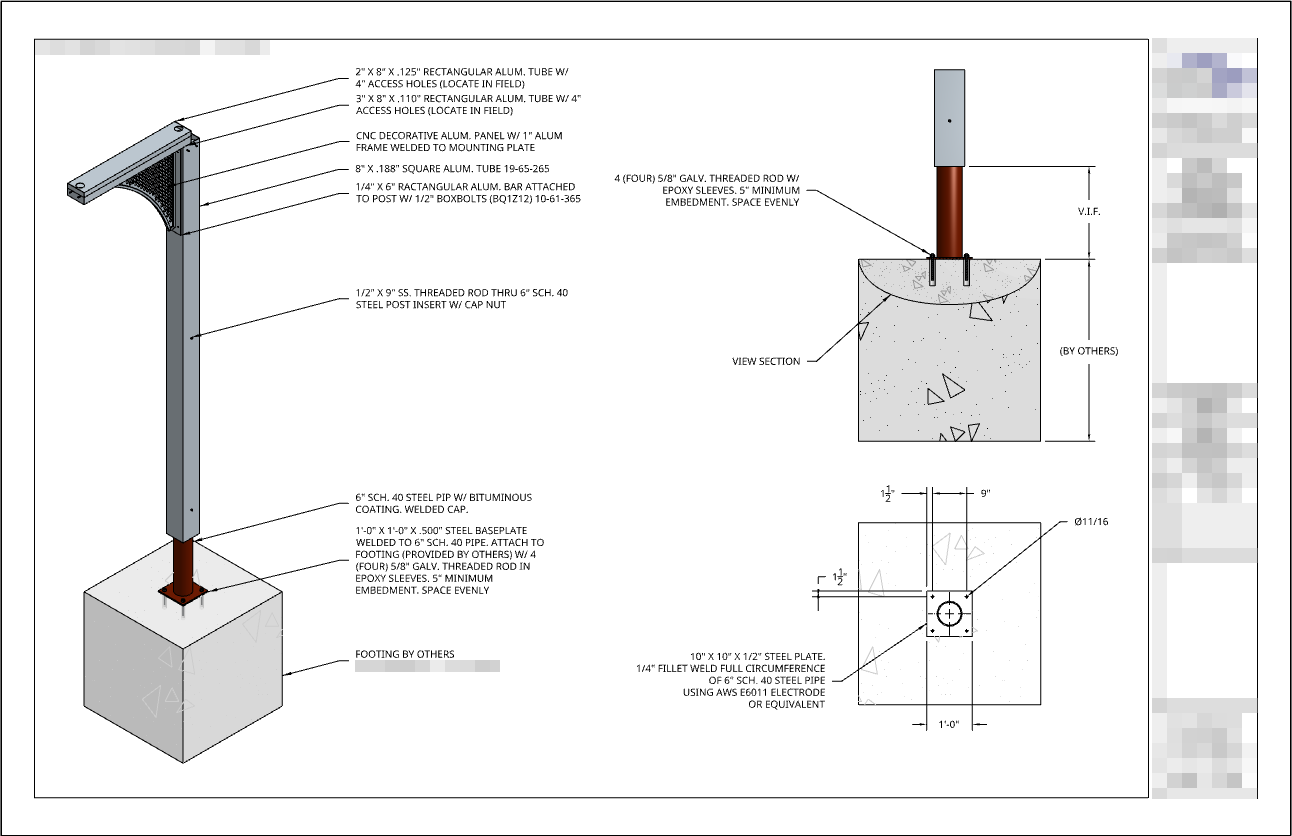

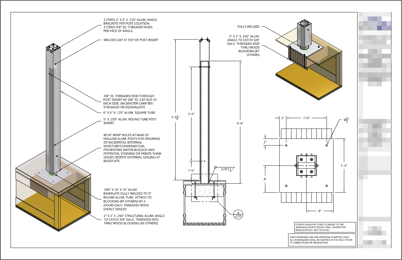

In the photos below, both structures use a post assembly that consists of a welded baseplate, a post insert, a post sleeve, and brackets at the top. They both have a different attachment at the ground level, the canopy on the red building is a more unique base design and is not something I plan to configure. My initial assumption is to seperate the post assembly from the top structure, make the post assembly configurable on its own because I may use it across many different projcets. This would include all of those parts mentioned + brackets in the top, different sized footings etc. Then I will make the structure up top depending on what it is.
If I build the post assembly in one part studio, how do I configure this to have views where parts are hidden without destorying the rest of my model? If I need to build each part in a separate part studio, how do I ensure that I can have holes for fasteners in the right place across multiple studios?
