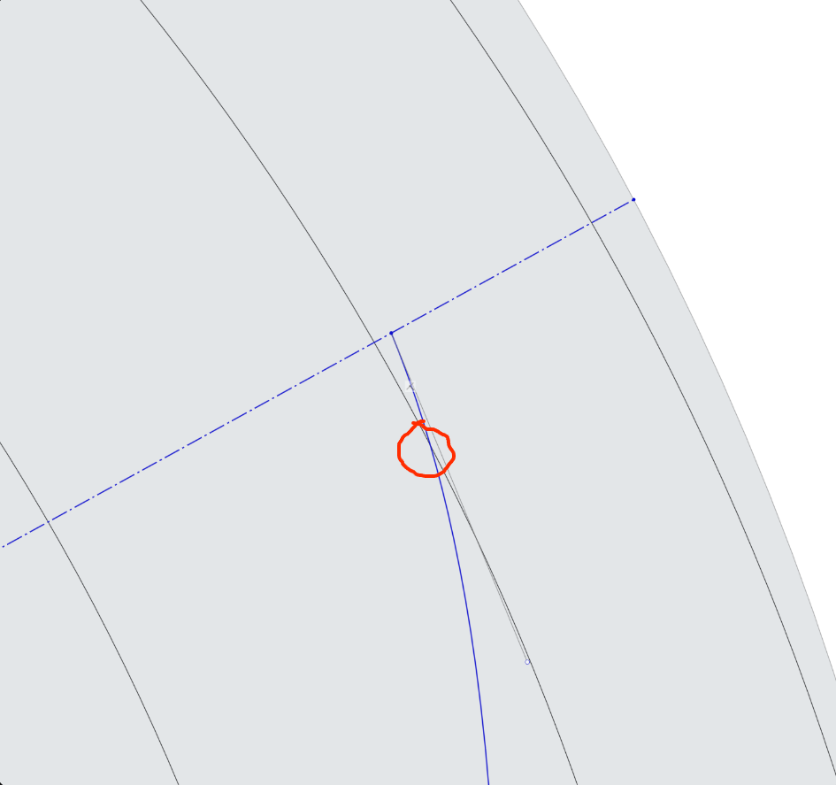

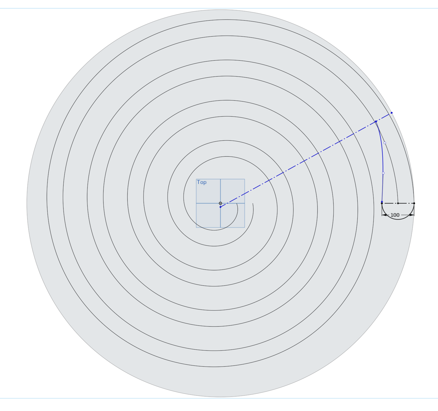

I have made a projected line from a helix on a plane and I want to intersect it with a construction line. How can I get this point?

    Use a "coincident" relationship?
  • rick_randallrick_randall Member Posts: 416 ✭✭✭
    Maybe the "pierce" command - or even "trim"? Just suggestions, because I'm not 100% sure if I understand your exact needs.
  • richard_theodorrichard_theodor Member Posts: 9
    I was able to circumvent my needs by making the curve end, then connect a line to the end point. Not my favorite solution, but it worked :) Thanks for the help!
    If you place a sketch point, you should be able to use Coincident on both your construction line and the projected spiral with the point, respectively.
