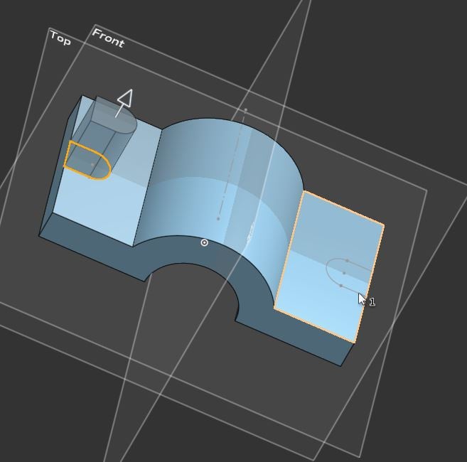

I have been learning ONSHAPE for a few days by watching Youtube videos and reading articles. I'm now stuck at a point where I don't know how to proceed. More importantly I'd like to understand what I'm doing wrong.
Here is the video:
at about min: 11:43 he extrudes the two shapes at the same time after he mirrored the one on the left. But I'm stuck here:
I mean, there is no way I can extrude them as shown in the video. The plane on the right gets selected along with the inner shape. I tried deselecting and then selecting the only two shapes again, but I got the same result. In order to get the job done, I avoided the problem by creating another similar sketch and extruding it on the right side. Of course, this isn't the right way.
Could you help me figure it out and fix it please? Thanks
  • robert_scott_jr_robert_scott_jr_ Member Posts: 744 ✭✭✭
    Hello. Planes can be hidden via the feature tree or 'p' on the keyboard. Otherwise, it could be that the sketch area to be extruded isn't an enclosed area. Please post a link to your document so we can take a look. - Scotty
  • john_torjohn_tor Member Posts: 19
    I got it eventually. The first shape on the left was open. My bad. Sorry
