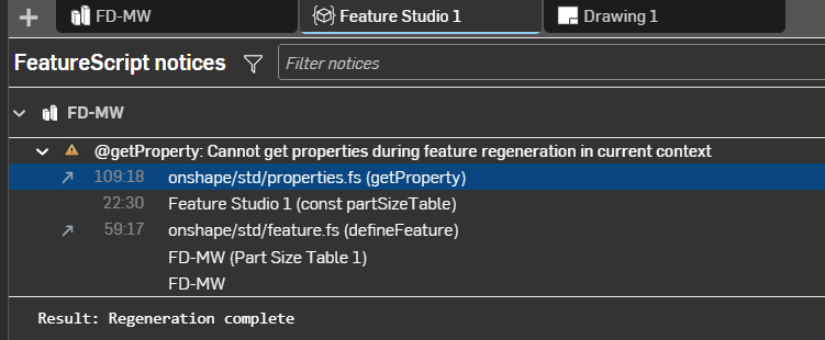

    can i rather show you what i have and why its not working and maybe you can guide me?

    FeatureScript 2780;
    import(path : "onshape/std/common.fs", version : "2780.0");
    // Feature name and description
    annotation { "Feature Type Name" : "Part Size Table" }
    export const partSizeTable = defineFeature(function(context is Context, id is Id, definition is map)
    precondition
        annotation { "Name" : "Parts to include", "Filter" : EntityType.BODY, "MaxNumberOfPicks" : 100, "MinNumberOfPicks" : 1 }
        definition.parts is Query;
        var tableRows = [];
        // Header row
        tableRows = append(tableRows, ["Part Name", "Length (mm)", "Width (mm)", "Thickness (mm)"]);
        // Loop through selected parts
        for (var part in evaluateQuery(context, definition.parts))
            const partName = getProperty(context, {
                        "entity" : part,
                        "propertyType" : PropertyType.NAME
            // Compute bounding box
            var bbox = evBox3d(context, { "topology" : part });
            var size = vector(bbox.maxCorner[0] - bbox.minCorner[0],
            bbox.maxCorner[1] - bbox.minCorner[1],
            bbox.maxCorner[2] - bbox.minCorner[2]);
            // Sort dimensions largest to smallest
            var sorted = sortDescending([size[0], size[1], size[2]]);
            // Convert meters to mm and round
                        partName,
                        round(sorted[0] * 1000, 2),
                        round(sorted[1] * 1000, 2),
                        round(sorted[2] * 1000, 2)
        // Create the table
        table(
            id + "table",
            tableRows,
            { "name" : "Part Dimensions" }
    // Helper function to sort descending
    function sortDescending(list)
    return sort(list, function(a, b)
    return b - a;
    so this is what i have so far but i dont seem to understand what im doing wrong

    edited October 2025 Answer ✓
    getProperty() can only be called from within Edit Logic or from within a table definition. It can not be called from within the feature body of a feature. This is one of the limitations of the way features are built in the tree atm.
    Looks like your rounding functions may be off as well. And the table definition.

  • Konst_Sh
    edited October 2025
    You using defineFeature template function while for table you need defineTable()
  • Aly_k
    Aly_k Member Posts: 17 ✭
    edited October 2025
    This one works for me so well thank you so much🤗
