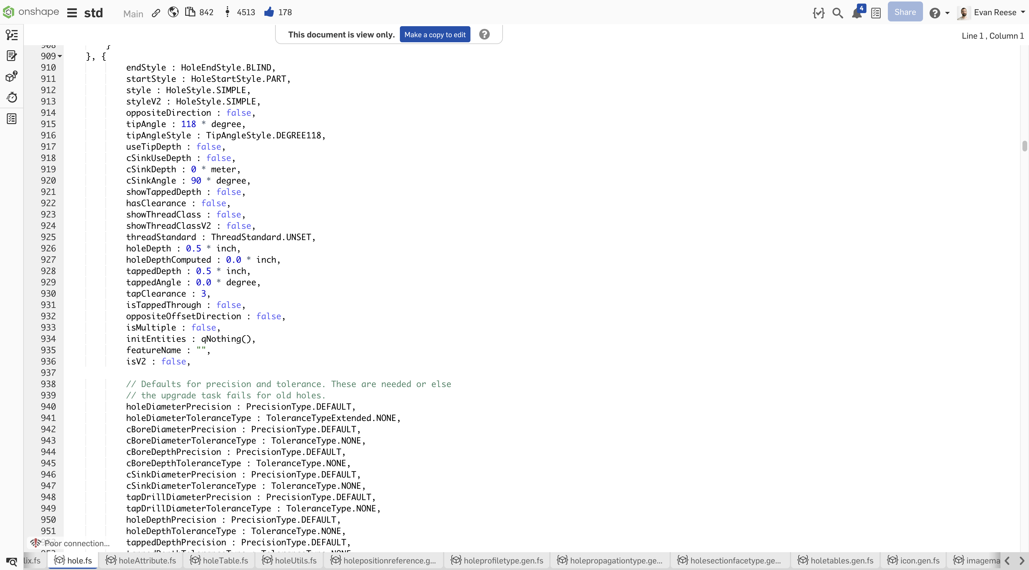

    @sebastian_theilenberg I don't think you're alone here. There is a Variable Hole feature by @Alex_Kempen that can set a hole spec, then can be used in all things downstream, and edited all in one place. The one thing I've not figured out with this custom feature is how to override just one parameter when using it, which makes it a little tricky to use. I've got half a mind to make a version of it for that use case, but not sure when I would.
    In the meantime, I would reiterate that you can absolutely make a modified version of the hole feature for your common custom inputs. Your feature can just be a UI with the right options (which you can copy and modify from the existing hole feature), then send all of that data (the "definition") to the hole() function, which is the native hole feature itself. You can still leave all of the geometry and tagging to that function. The business end of your feature could literally just be
    hole(context, id, definition);

  • EvanReeseEvanReese Member, Mentor Posts: 2,808 PRO
    edited October 2025
    @eric_pesty
    I was imagining replicating and modifying the actual UI, which is what writes everything to the definition. If you want a simpler UI with certain definition fields hard coded in, you can do that too. Remember that the hole() function is just looking for the feature definition (which is just a map of key/values). Normally the definition is set by all of the UI elements of the hole feature, for example definition.oppositeDirection is a checkbox, and will be set by the user. However you can just as easily not have it in the UI, and later in the feature execution write definition.oppositeDirection = false; to add it to the definition manually. The Hole feature code precondition also includes a whole set of "default" params starting on row 910 (as of now), which is a great starting point to know what fields must be set and what you might set them to.
    You could try not declaring them all, and seeing what error message you get from hole(), It should tell you what param caused the issue then you can fix them one by one till it works. Or maybe you just wanna do them all and give them a value.
  • eric_pestyeric_pesty Member, pcbaevp Posts: 2,540 PRO
    @EvanReese ,
    I was trying to avoid duplicating the hole UI as it's 100s of lines of code with lots of "ifs" so it's really not trivial to make changes to it!
    I think the hole feature has to be one of the worst for this! It does all sort of "weird" stuff with tolerances and I'm just generally struggling to figure out what's going on!
    I have been manually setting parameters as you describe, the challenge being figuring out all the ones I need for the type of features I am trying to make and just banging my head against endless "precondition fail".
    I'll see if this list of "defaults' is going to help! I was trying to do something "quick and dirty" but I'm already about a full day into it! I think I'm making progress but it's definitely slow!
