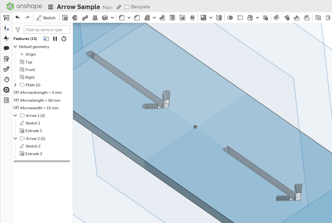

I'd try to define variables for main arrow dimensions, then:
- use three construction lines and three slot features in the sketch, then extrude the whole enclosed area of the sketch.
- only sketch half an arrow (it is only 5 points to click, after all), mirror that, then extrude-remove.

Thanks @martin_kopplow for pointing out the Slot feature. I didn't know about that. Logically I think that (or the ability to usefully Extrude > Thin multiple lines) is the feature that I had in mind. Nice.
Thanks @pcrov for gently pointing that out I could just Extrude > Thin the arrowhead and merge it with the stem. I'm embarrassed that I didn't see that. Somehow, I got stuck in a mindset of including the stem in all the Extrudes.
