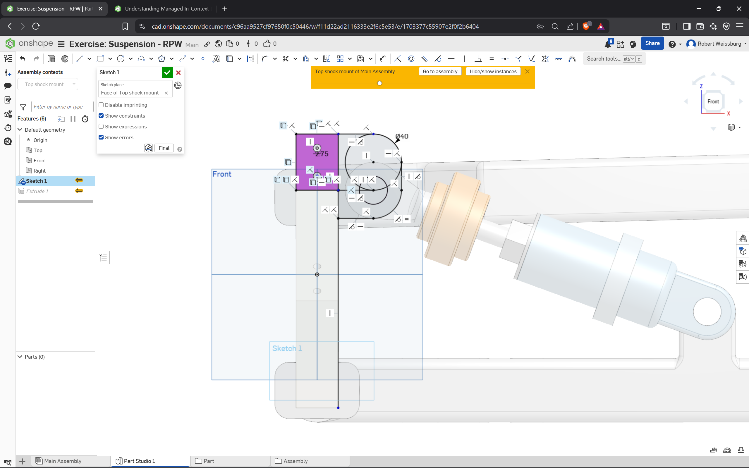

Understanding Managed In-Context Design, In context design within a doc, step 28
I have to admit (and hate to) that I'm stumped. I have spent 15 hours on this one step on 3 days, but can't get the bracket modification fully defined. All the lines of the sketch are black, but I need to add to dimensions to get that, which aren't present in the slide in the tutorial. The feature still shows not Fully defined. What am I missing? I have done every combination of constraints I can think of without improvement on this.

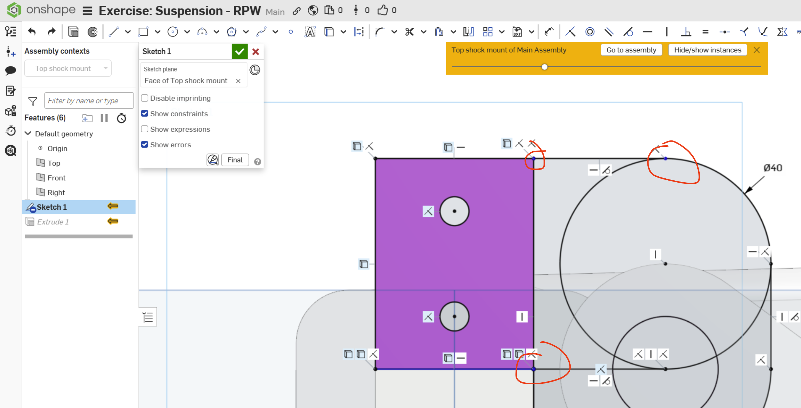

  • Matt_Shields
    The lines might be black, but look carefully for some blue line endpoints. When I did the exercise, I had two endpoints I had to constrain.

    I added a few more constraints, but that didn't change the error. One thing I notice in yours and in the tutorial picture, the line on the bottom that is the right side of the angled block, running off the bottom of the image above is not part of the sketch in mine (gray), but is in yours and the tutorial. I can add a line there, but it doesn't change anything. It seems in yours it is part of the Use. I would swear that I selected the two things for the use correctly and have no idea how to alter a Use post facto.

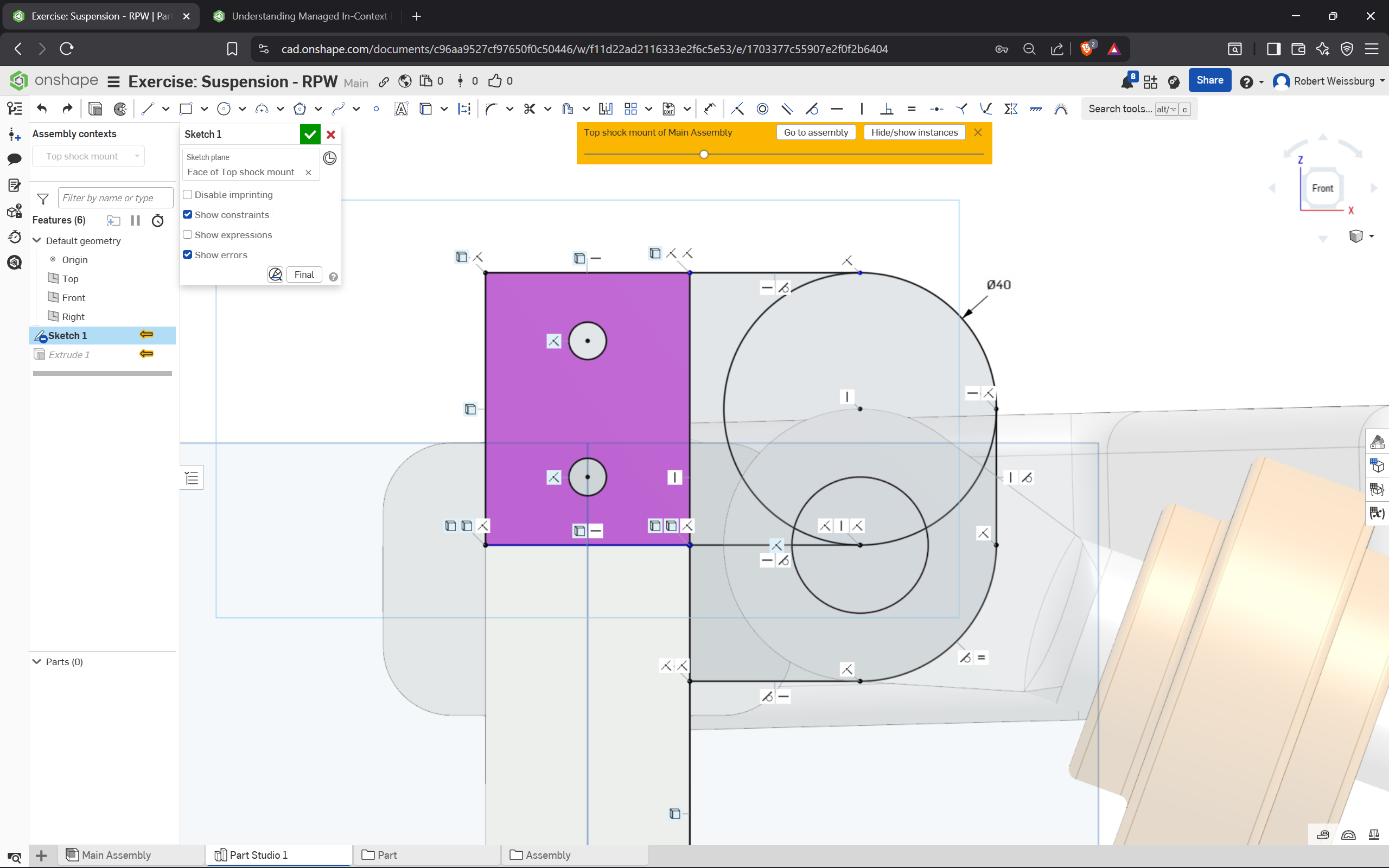

    Another version, with centerpoint circles over the two holes of the left. Still same error.

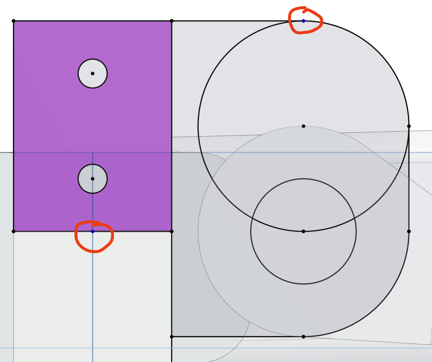

  • Matt_Shields
    These all look blue to me. Click and drag them to see what's not defined. Or share your doc.

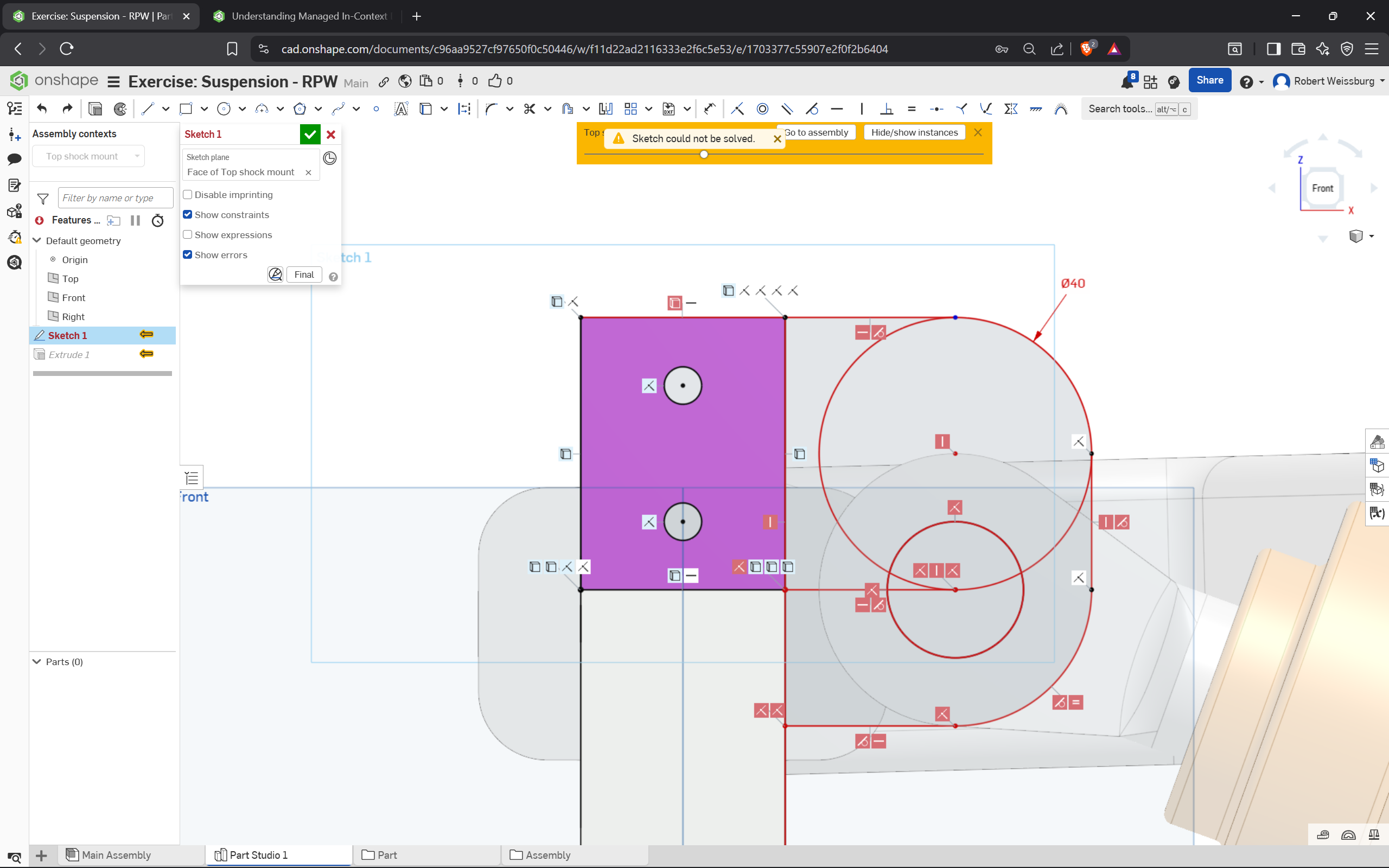

  • robert_weissburg
    robert_weissburg Member Posts: 33 ✭
    My doc is public. Don't know how else to share. I wasn't able to move the right and lower points you circled, but I could move the other. I moved the end of the left line to the right a bit and used coincident to attach them together and it couldn't solve, giving this.
    The right and lower points were black and now the right one is blue. Would have been nice if a better contrasting color was used than blue.

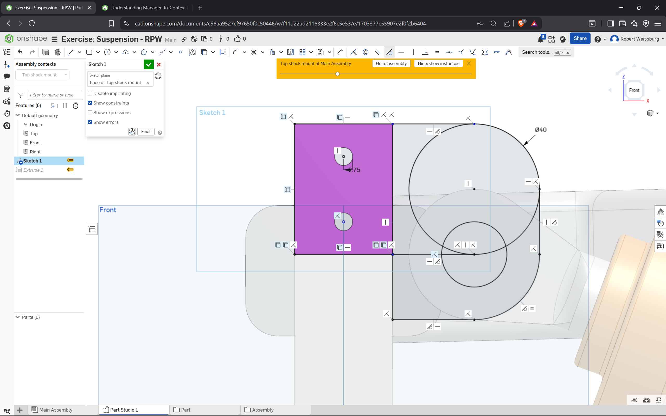

  • robert_weissburg

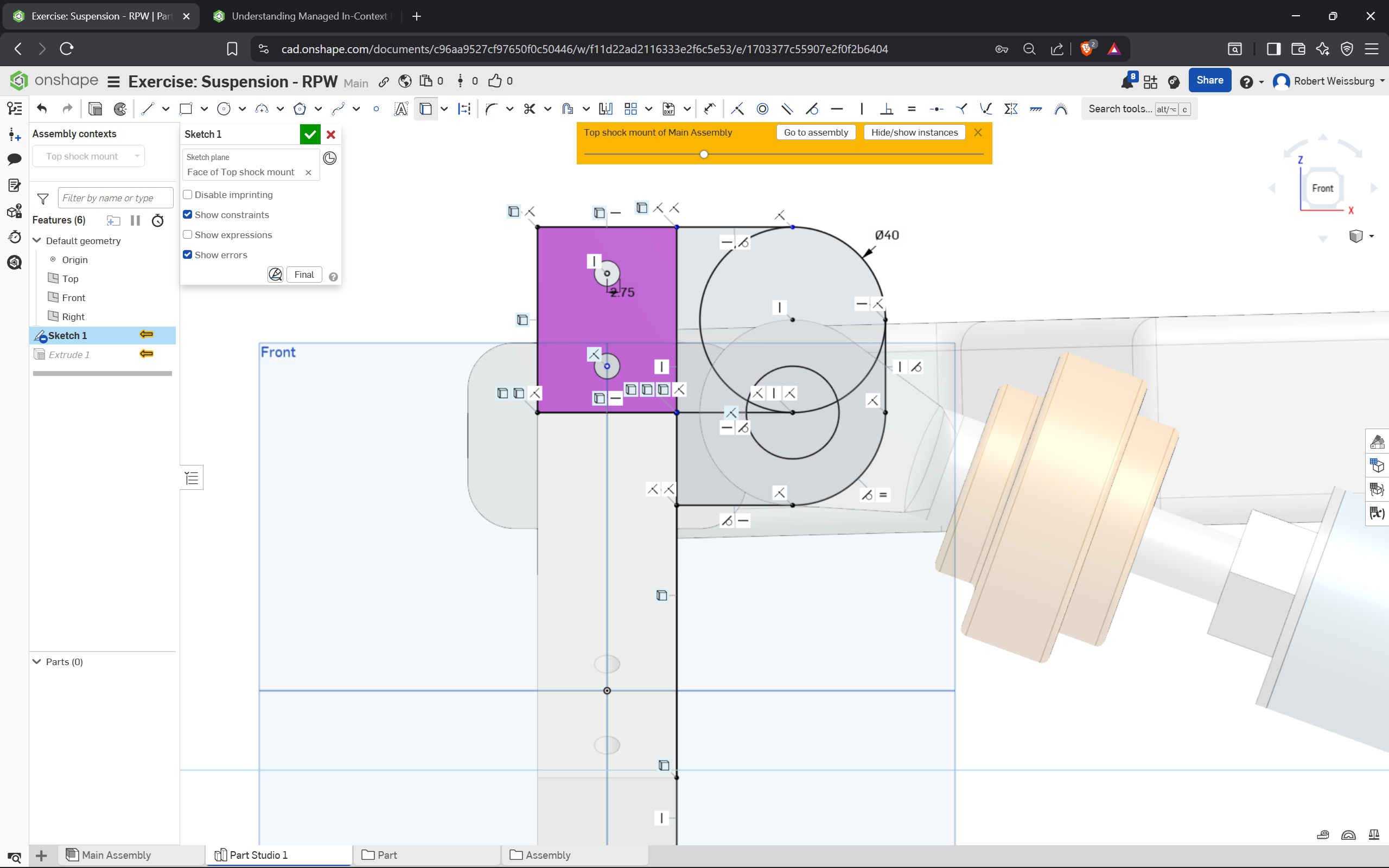

    I deleted the diameter dimension and everything looks black now, but still error.
    I found that the point on top of the big circle could now be pulled apart, so I coincident connected it to the circle. I tried pulling every point and nothing moves.

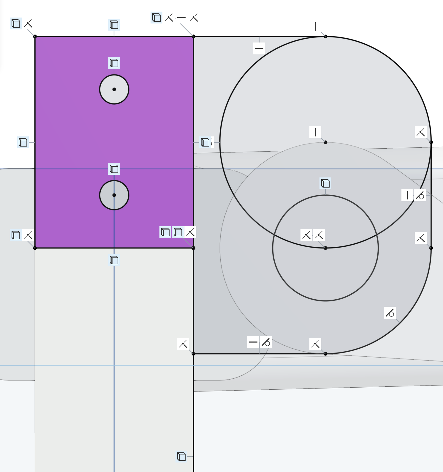

  • Matt_Shields
    It's subtle, but the size of these vertices is your clue. There is some underlying unconstrained geometry.

    That is very subtle. It's also crazy that I just learned this trick. FFS. It really should be a lot easier to find these sort of overlapping unconstrained vertices.

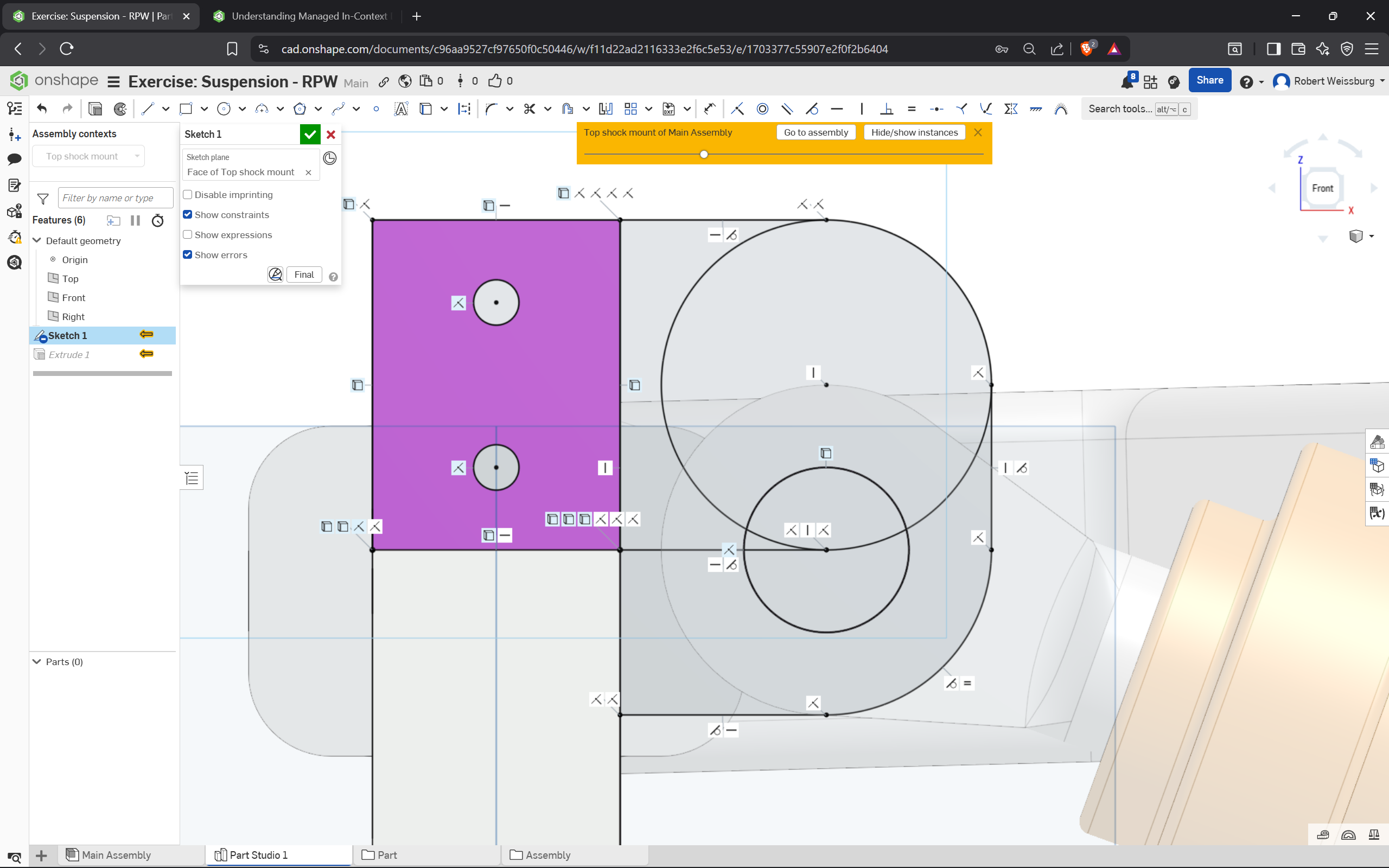

  • robert_weissburg
    I played with it for a couple hours and now have this.

    The "Profile inspector" tool is made to find these… I just wish it highlighted points that are "on an edge" as well:
    It finds these:
    But not these:
    Or alternatively a filter option in the constraint manager for "under constrained"

    The Profile Inspector. I've done many of the tutorials (2 dozen?) and no mention of this yet. I was trying to find such a tool.
    I didn't even know that part of the assembly was in "play", as it were.
    Thanks Matt!
