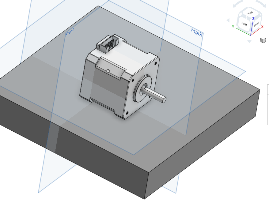

How do you keep it from moving in more than one axis using mate connectors? Like, lets say I have a cube that I want to move along the y axis, but I want to keep its position in the x and z axis. I have two points or mate connectors that are the correct distance along the y axis for the translation, but they themselves are not on the same y axis. if I move between them, then the cube will translate x and or z as well, which I don't want. I find this to be the case when I am importing parts that have filleted edges and odd geometry. Take this example I created for this discussion.
Let's say I want to move the motor on Y-Axis so that the end of the shaft is flush with the front surface of the box, but I don't want the motor to move from its z position. And I also want to move the left face of the motor on X-axis to be coplanar with the left face of the box. Any mate connector I place on the end of the shaft will move it down so that it is buried in the box. Same with the left face. Of course I can measure the directions I need to move in each direction, but those values might change if I edit something further up the tree. Or I can create measurement variables, but that is 2 variables and 2 transforms just to get it aligned and just feel clunky.
2 measured variables that go into 1 transform (translate by x,y,z) could do in this case.

Oh I understand now. Thank you for clarifying. Yes I've reached for similar functionality only to have swung and missed. Basically your asking for the program to do the math for you instead of measuring something and then using transform by direction. Doing an XYZ move after creating a variable or taking a measurement is limited to orthogonal intents and requires that extra step of taking a measurement. What if your object and references are skewed? Gotta enter all three measurements..
I agree it would be a nice addition. There would be a few ways I could see that implemented. You could create a feature request for it. I'd vote for it.
