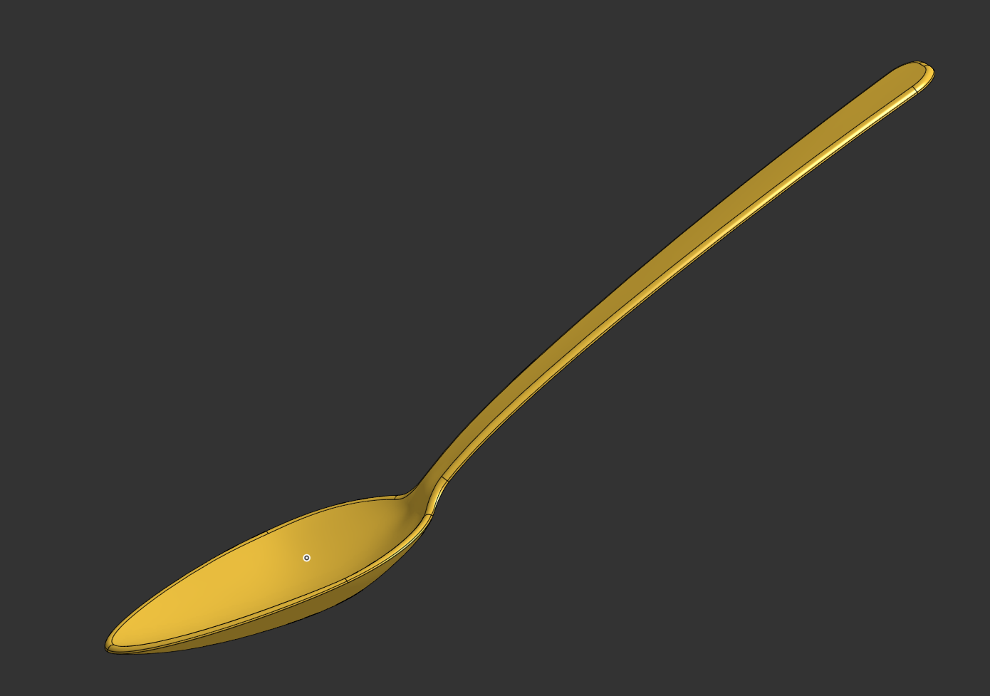

Hi,
Haven't been able to find anything to help me create a partline/splitline surface for splitting block to create a core and cavity for a spoon.
I've tried the Neil feature script no good for this.
I've tried ruled surface and others.
I haven't been able to work it out.
Any help will be so appreciated.
Refernce pic below.
thanks,
Corca
The built in Isocline tool will do it.
