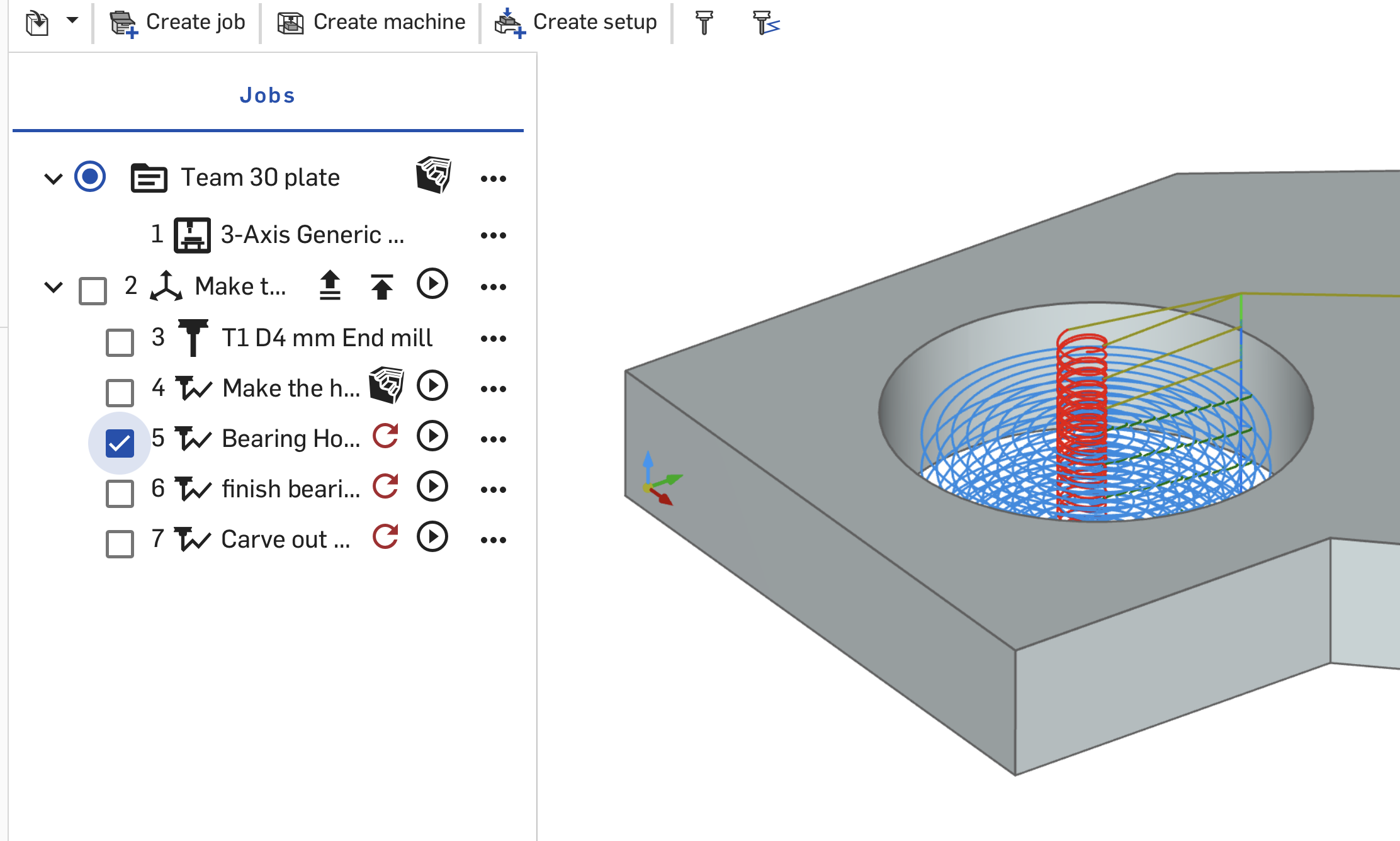

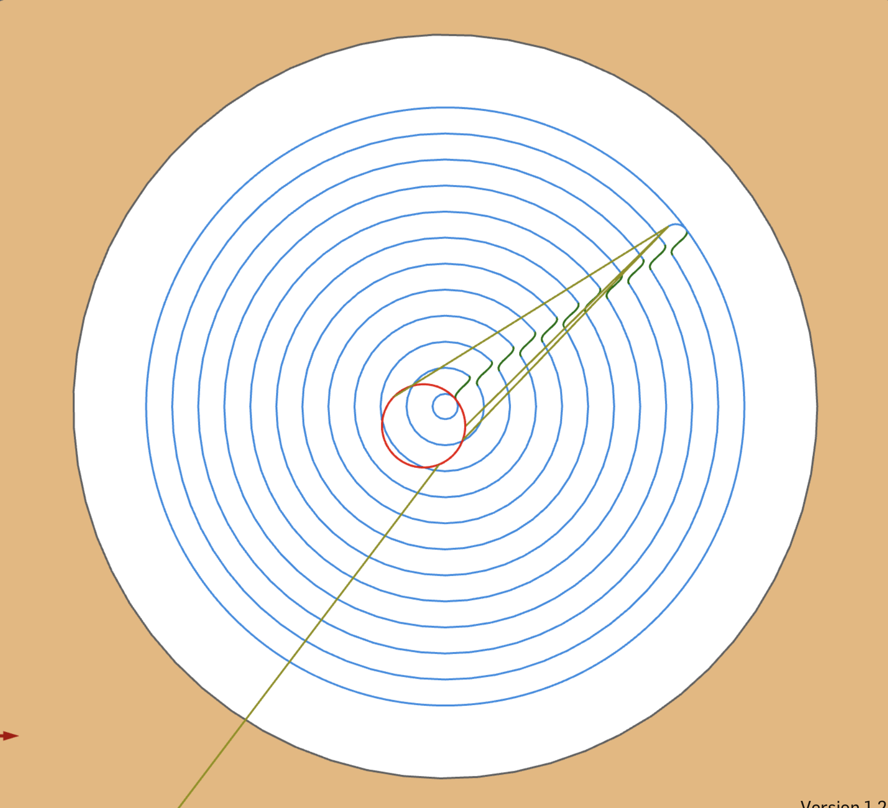

    I am really trying to get Onshape CAM to work for our team (2530) this year. There are quite a few hurdles in terms of both learning and a few functional gaps, but I think doable. One things I can't figure our is why when I'm doing something like a 2D rough to get a bearing hole it doesn't just do a spiral from the center (it steps over and then makes a circle)

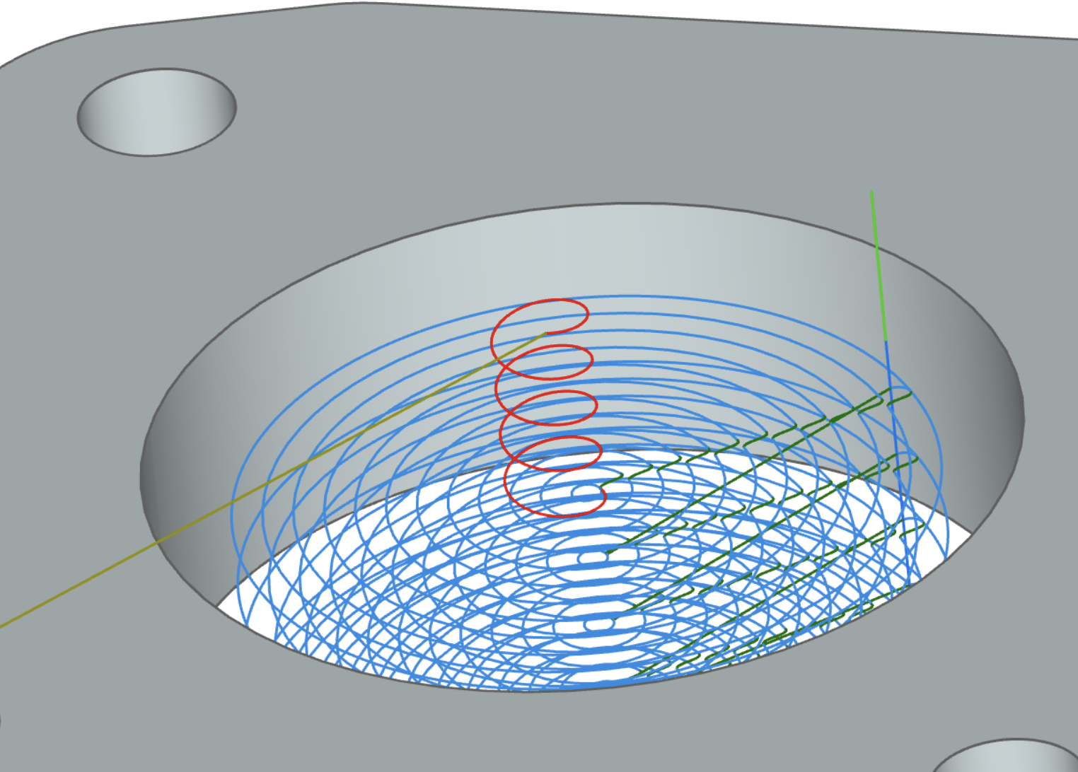

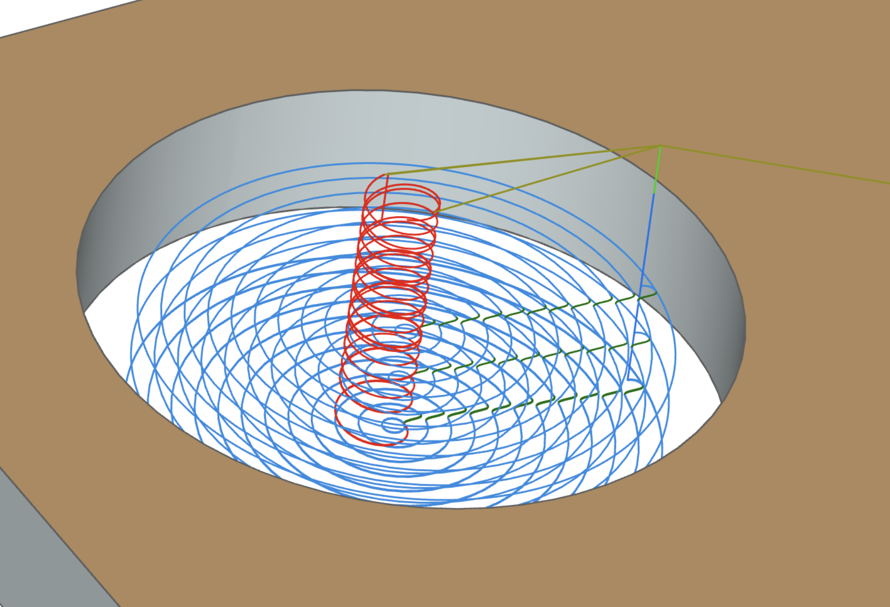

    and between each depth it retracts back to the clearance distance. I can make it stop going all the way back out by changing some of the "small links between passes" parameters to 'direct' or 'spline' but then it doesn't properly spiral in to the next layer—it just plows through to the center as a move/ramp. I'm sure this is something simple I'm missing…. The 'retract to feed distance' still goes up the clearance and slowly spirals back down.
    vs. 'Direct' or 'spline' where I'm sure to break a bit…

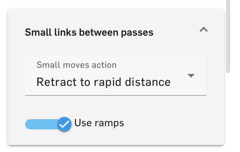

    Ok I think I figured out the second part.
    Mets select 'retract to rapid distance' in the small links between passes…. This looks like it will work.
    Nope. Actually that did look like better paths but is still retracting all of the way back up for each step down…. Argh.
