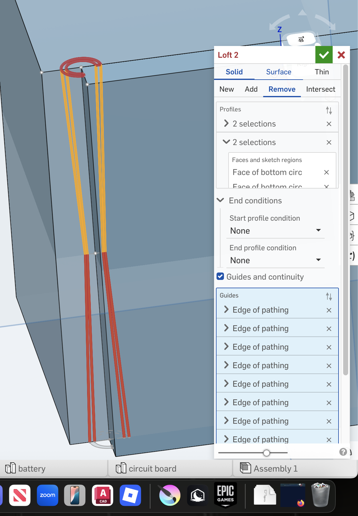

how would I make this remove loft?
colt_reichmancolt_reichman Member Posts: 2
I did this a couple days before but I dont have access to that version of this document because I didnt understand how saving history worked until just now. Either way I'm having the same problem. Everything is defined, I forget what I did in order to solve this last time.
I think its a probelm with my edge continuity.
  • MDesignMDesign Member Posts: 1,332 PRO
    Looks like your trying to remove a surface from a solid. Try switching it to solid remove.
  • robert_scott_jr_robert_scott_jr_ Member Posts: 762 ✭✭✭
    Posting a link to your document would enable members of this forum to clearly see what's going on. - Scotty
