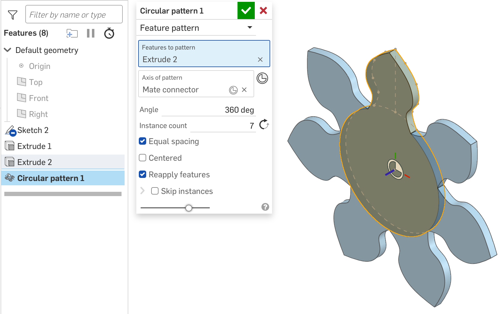

is it not possible to do that i need this spline 7 times around the circle for a cutter or should it be done another way
https://cad.onshape.com/documents/aacc59d55b4933f634b13168/w/4db8219cb3b80b4e6948857b/e/86d80f91cf453e4d90db2304
You can't pattern a spline in the sketcher, but you can pattern a curve, surface or extrusion with the pattern feature.
https://cad.onshape.com/documents/abb9cccd50ab34ff5ee30957/w/1f1a36f0c9e367929fcb3451/e/55f5ff2d98a9393239e1c77b
