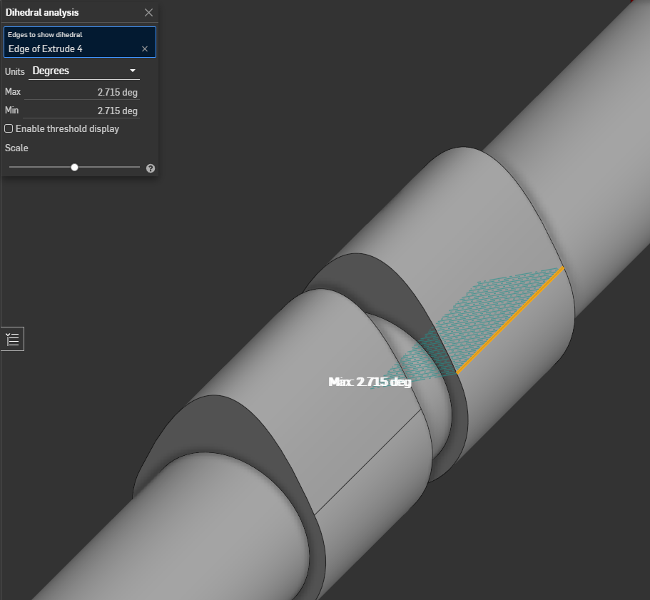

I think you'll find your cam lobe profile is not tangent to the main body. Once that is taken care of the tangent mate in assembly will allow tangent propagation. I've hidden a bunch of stuff to simplify maters for now. Animate revolute 1 on a continuous loop to see this work.
