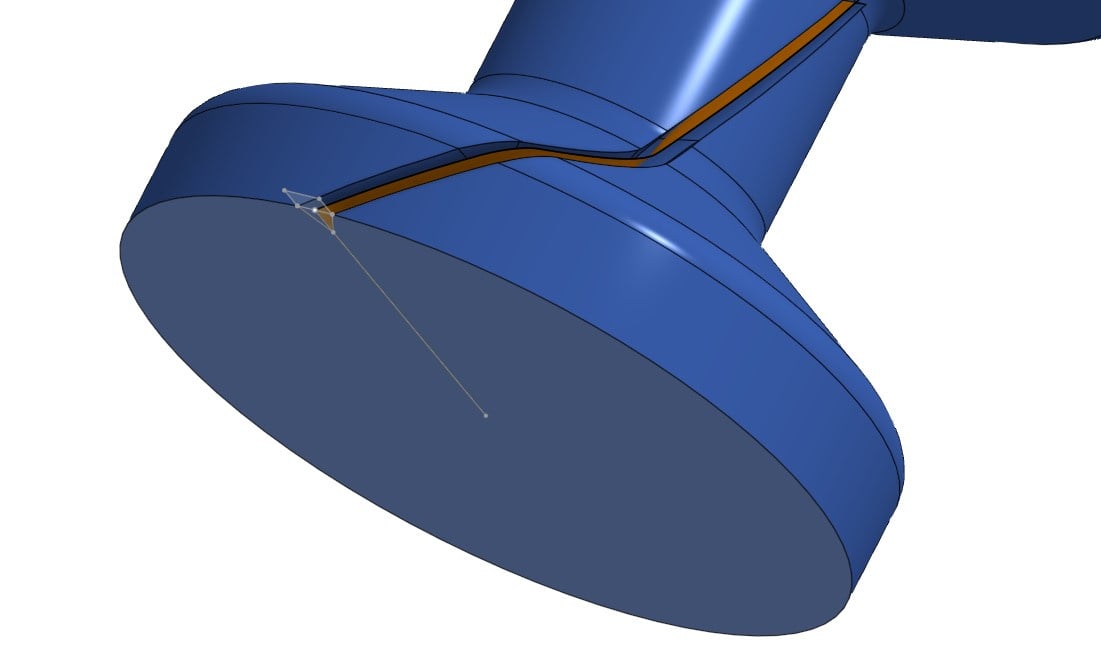

I can usually figure this stuff out but this one has me stumped. I have a revolved body (a spindle of sorts) and I'm trying to cut a V-notch the length of the spindle, while that notch rotates 3/4 away around the body. I've tried several ways, but none of the ways seem to get me what I need. I've looked around the forums and found tricks on intersecting curves, creating surfaces first to guide, etc etc, but none accomplish what I'm looking for. I need the sweep profile (the triangle cutting the notch) to keep the bottom of the notch always pointed towards the center/axis of the revolved body. I also need the profile itself (the triangle) to stay normal to the base/cross section of the revolved body. I can't seem to make both of those things true at the same time. Can anyone help me understand how I'd accomplish this? The fact the whole thing rotates around the face seems to be the complicating factor here.
Image of what I'm working with currently.

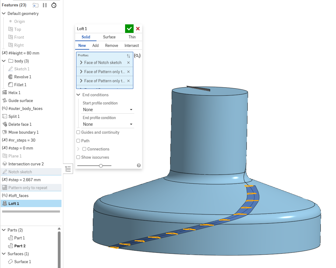

    My attempt: It's a challenge indeed.
    I've given it a few attempts. this is how far I got with a bit of a complicated way.
    The challenge with reapplied sketches like this one is that a tangent direction, or in this case the edge direction of the intersect curve, can flip and the sketch doesn't solve as intended like in this example.
    If you really only need 1/4 of the way around iso 3/4, thing may be easier (less chances of a flip of direction).
    Moreover I couldn't get the Loft to work with a query variable, so that will mean a lot of manual clicking.
    with the #nr_steps the resolution can be increased once you get it to work well, but I doupt this is what you want to end up with so I'm quiting for today.
    I've looked at ruled surfaces, but none keep the orientation of the 'triangle' flat.
    So I came up with this complicated solution:
    anybody with a simpler idea?
    at least you can see how narrow the slot will be in height, so I'm not sure you'll be able to get it to work this way…

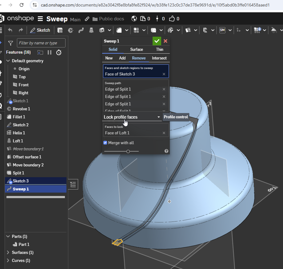

    Am I missing something or isn't that achieved with the "Lock to profile faces" on the sweep?

    On the full spindle, the curve (which was projected via a helix) goes 3/4 of the way around. this was just a snippet that shows the rough variation of radius of the body that I'm dealing with and is zoomed in enough to show the relative profile size and the curve I'm trying to sweep it along. It wasn't meant to be a complete view, so sorry for the confusion there.
    It's actually not a cam follower, it's much more simple. This is a spindle that will roll in the finished component which will be 3D printed. The goal of the notch is to provide relief for the Z-seam from printing. if the notch gets too shallow I'll have to deepen it which could weakin it or make it too deep elsewhere; and if I use a profile other than a triangle the missing flat can become too large. The reason it's rotated around the spindle is to avoid having a dead "flat spot" where the seams all align. By wrapping it 3/4 of the way around I can effectively make this perfectly round for the purposes of printing, eliminating any negative effect of the Z-seam on its ability to roll smoothly.

    Eric, if you look at the cross section of your document, you'll see that the profile gets pretty severely screwed. the profile doesn't stay clean, it gets warped.

    @eric_pesty the lock to profile faces, as well as ruled surface solution that specify an angle to the surface, both find a normal to the face (to measure the angle from that's not aligned with the top face as Tracey was looking for.

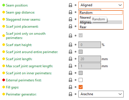

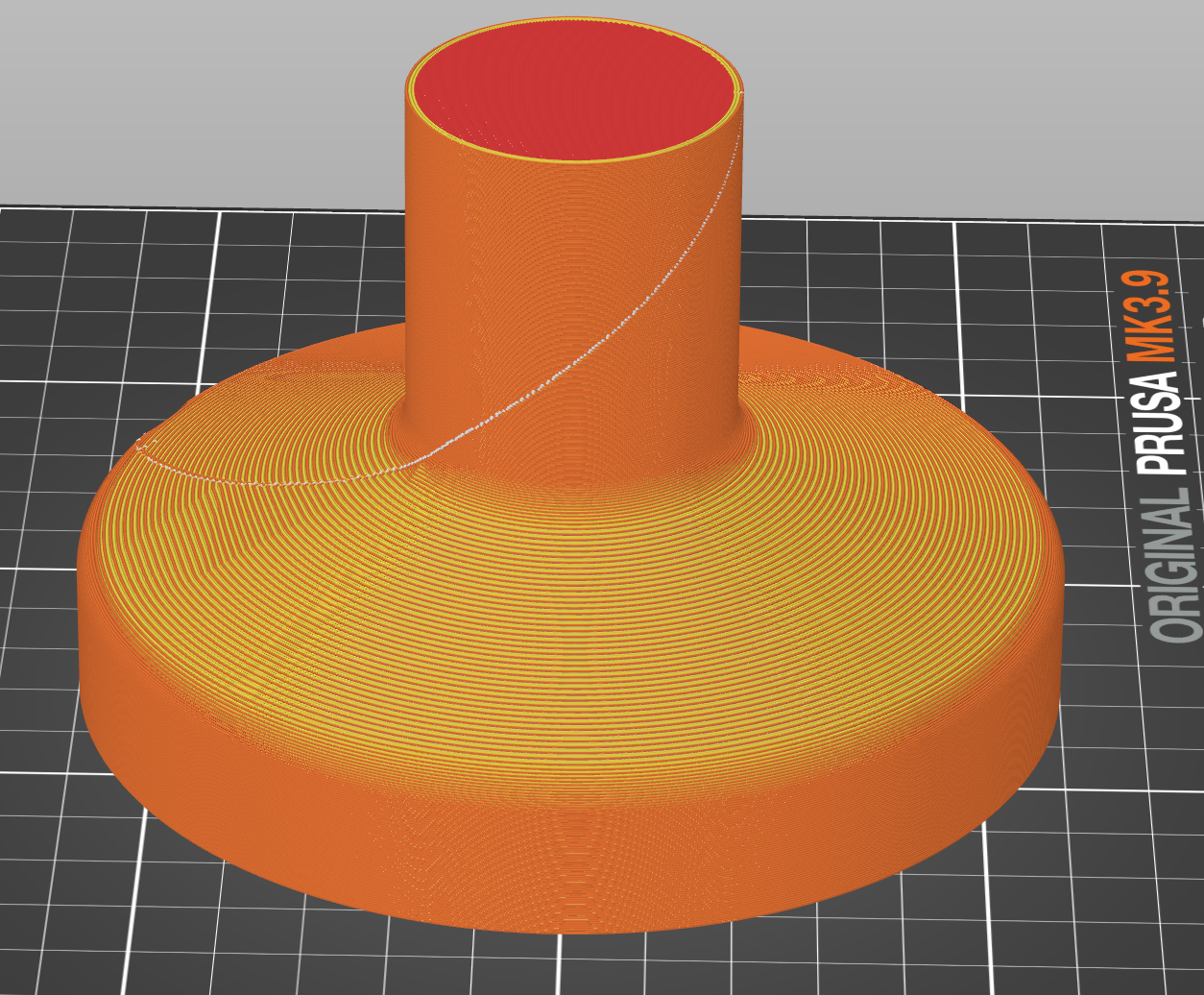

    I did a tiny 0.3mm diameter circle sweep accross the face to work as a 'seam attractor' and it works very well except for the steepest helical curve where the circle may need to be increased a bit (or the angle decreased).
    Prusaslicer automatically put the seam in the corner:
    They also rock a seam painter which could come in handy in this case.
    more over, how about placing the seam position random? you'll end up with a closer to perfect cylinder that way. combine that with 'scarf joints' and you're good to go without any CAD effort…
