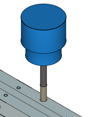

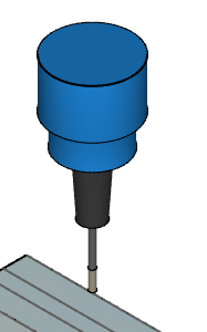

The third step in creating a Job in CS- "Create Tool" - opens a dialog that invites the user to select an entity referred to as a "cutter" from a list referred to in CS documentation as a "Tool Library"' . Once the cutter is selected, the user can either confirm and exit (OK) or open other dropdown selctions to enable and define an Arbor and/or a Holder. The final dropdown - Assembly- reveals a single input field - Number* - which defaults to the value 1 but can be overridden by user input. When the dialog is confirmed, the tool entry appears as shown.

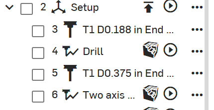

However, in a job that requires multiple tools to be defined for different toolpaths, CAM Studio accepts redundant assignments of the Assembly Number, leading to the following result:
Two different tools assigned the same tool number!! Verification finds nothing amiss- tools are obviously different

The machine is commanded to change to T1 for the Drill operation and to T1 for the subsequent profile, even though the tools are different. This situation could ruin a job, or worse, damage a machine. CAM studio puts the burden on the user to avoid this ambiguity. Furthermore, while cutters are stored in a library and can be selected for different jobs, a new assembly must be created each time a new job is created. CS is apparently fine with one-to-many relationships between tool numbers and tools. There is no way to reconcile this situation with the tool libraries associated with Tormach and other machines.
