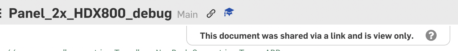

    FYI, I couldn't export, I think because the doc was shared via a link, but wasn't made public. Here's what I see as my only option.

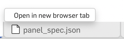

    Thanks for your answer! What I could identify is that it crashes at index i=4, j=1 even thought its the same form as the index before, just on the next position. I actually manged to extrude all sketches with NewBodyOperationType.NEW so maybe I find a workaround for now if I just subtract those from the part. Could you not just download the json file from the project? I attached it anyway.
