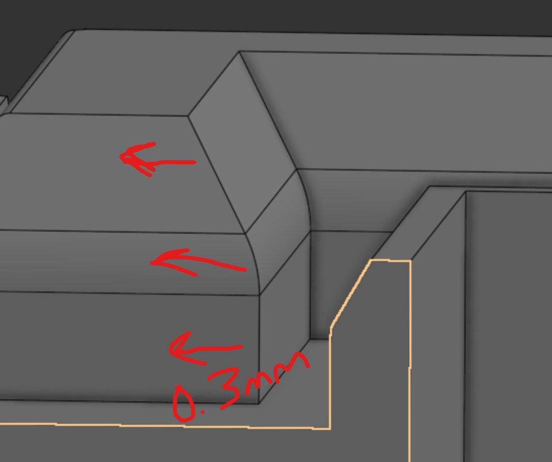

Hi all,
I have a section wall with the center portion being curved. I want to remove 0.3mm from each face. I can get the top and bottom moved fine with extrude, but the curved middle I cannot extrude. Move face will let me grow it, but will not let me remove material. Any help would be great!

  • jelte_steur_infojelte_steur_info Member Posts: 642 PRO
    I don't see why move face wouldn't work. just hit the 'other direction' toggle. just move all three faces in one go.

  • ry_gbry_gb Member, csevp, pcbaevp Posts: 177 PRO
    Did you try using Transform instead of Offset in the dropdown for Move Face? I know Offset is ideal, but if it doesn't work, then I would try an alternative.

  • wayne_sauderwayne_sauder Member, csevp Posts: 639 PRO
    It's a little unclear what the exact end goal is, but you may need to use a couple of move face commands. Don't forget to use up to entity whenever possible. Check this document for some ideas.
  • GregBrownGregBrown Member, Onshape Employees, csevp, pcbaevp Posts: 375 image
    Try the Move face again, but with Translate option and Up to entity as shown below.

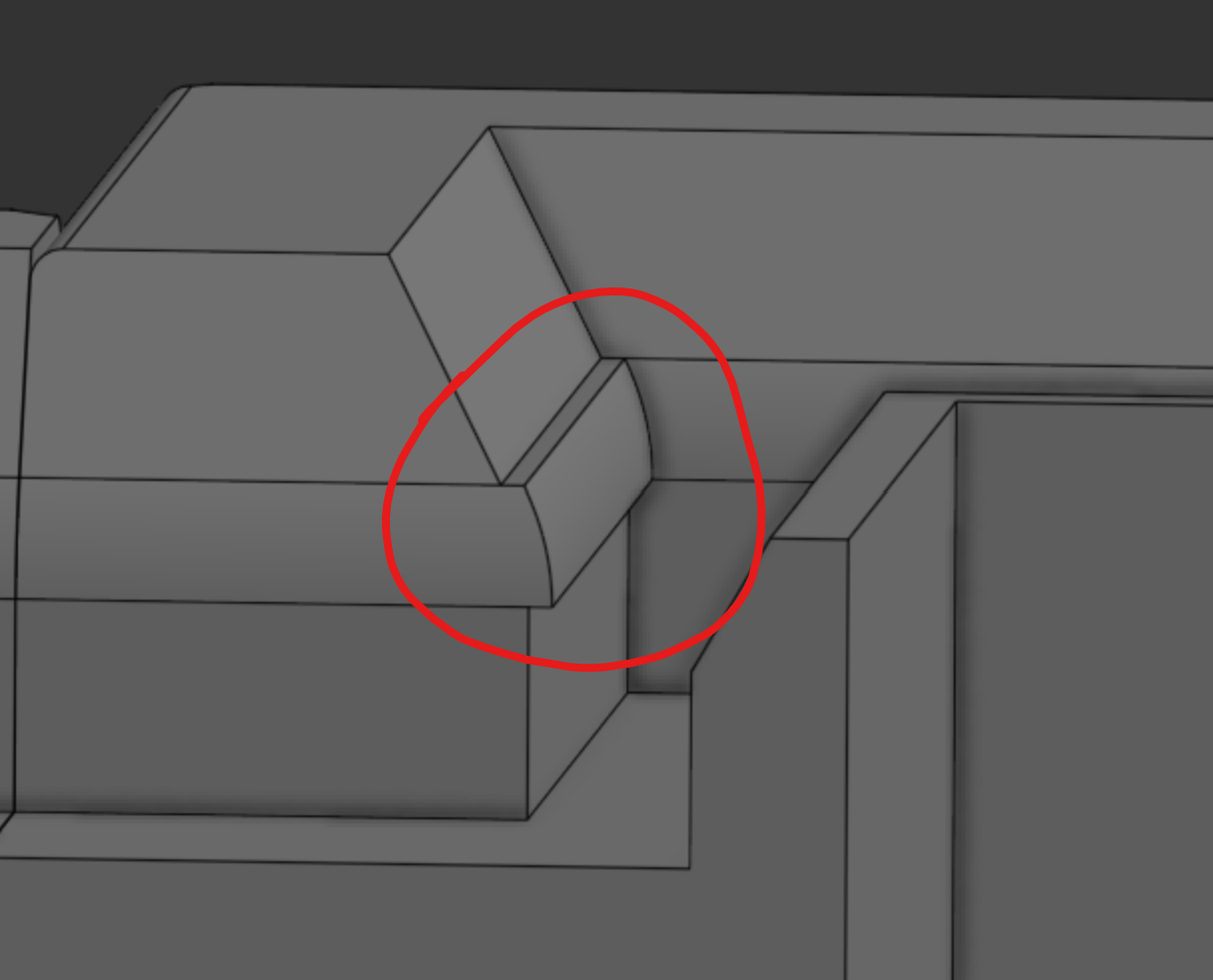

  • jason_ryan337jason_ryan337 Member Posts: 63
    Thank you kindly for looking. When I try to reverse it, I get this regeneration error. I am sorry I did not leave a good path, I thought the link would take you directly there. Here is an image showing it's percise location. I would truly appreciate any continued support.
    If needed, I can walk back to the origin that I used to create the fillet, but it may wreck some stuff if I unwind that far, lol.
    That worked, thanks! I had no idea you could do that!
