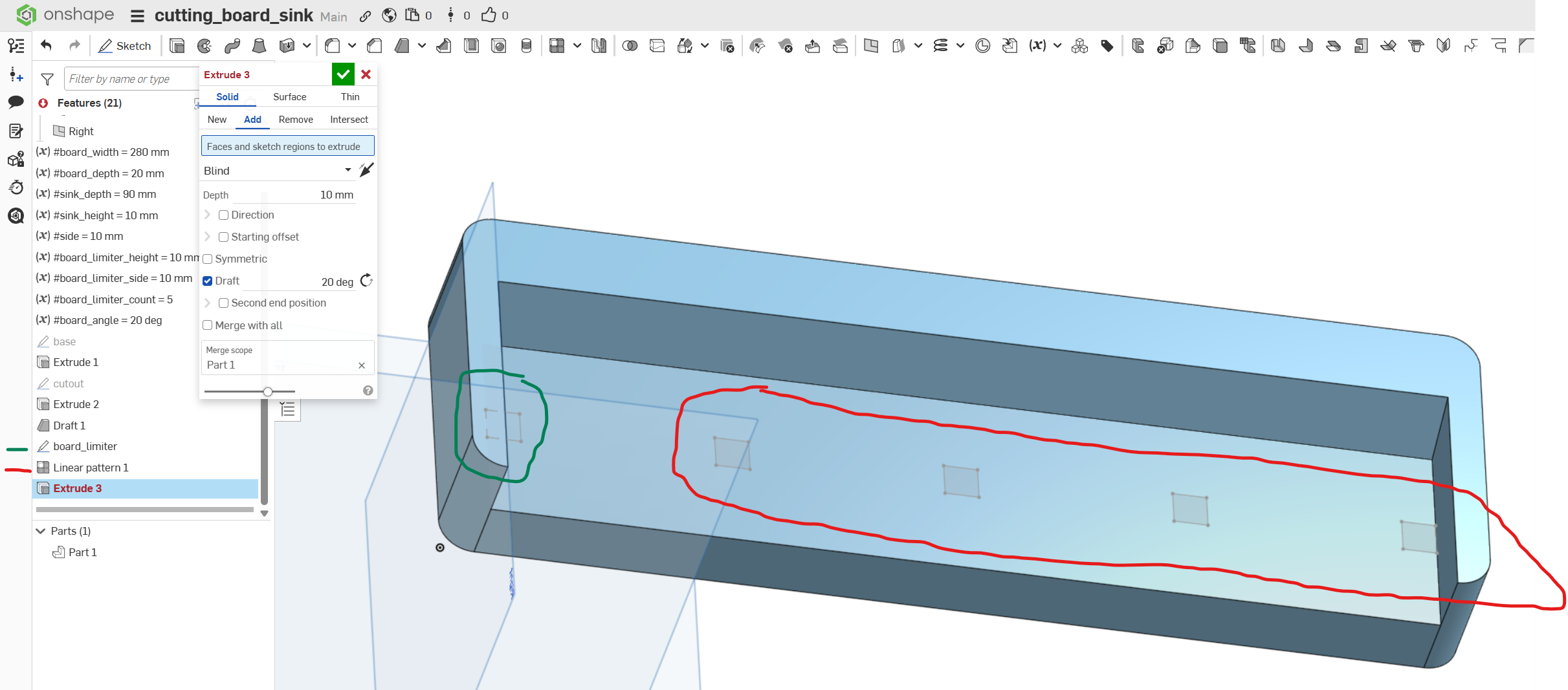

Hello, I have a simple linear patter that duplicates sketch into multiple entities depending on count variable. I want to extrude all the entities. Is there a way to select all of them instead of selecting one by one?
The problem with selecting them one by one is that if I change count variable, I get more or less of them, which breaks extrusion.
  • S1monS1mon Member Posts: 3,914 PRO
    It would be much better to do this as a feature pattern instead of a sketch pattern. Sketch patterns have gotten more and more flexible and capable over time, but in general if you can use a feature pattern you probably should.
