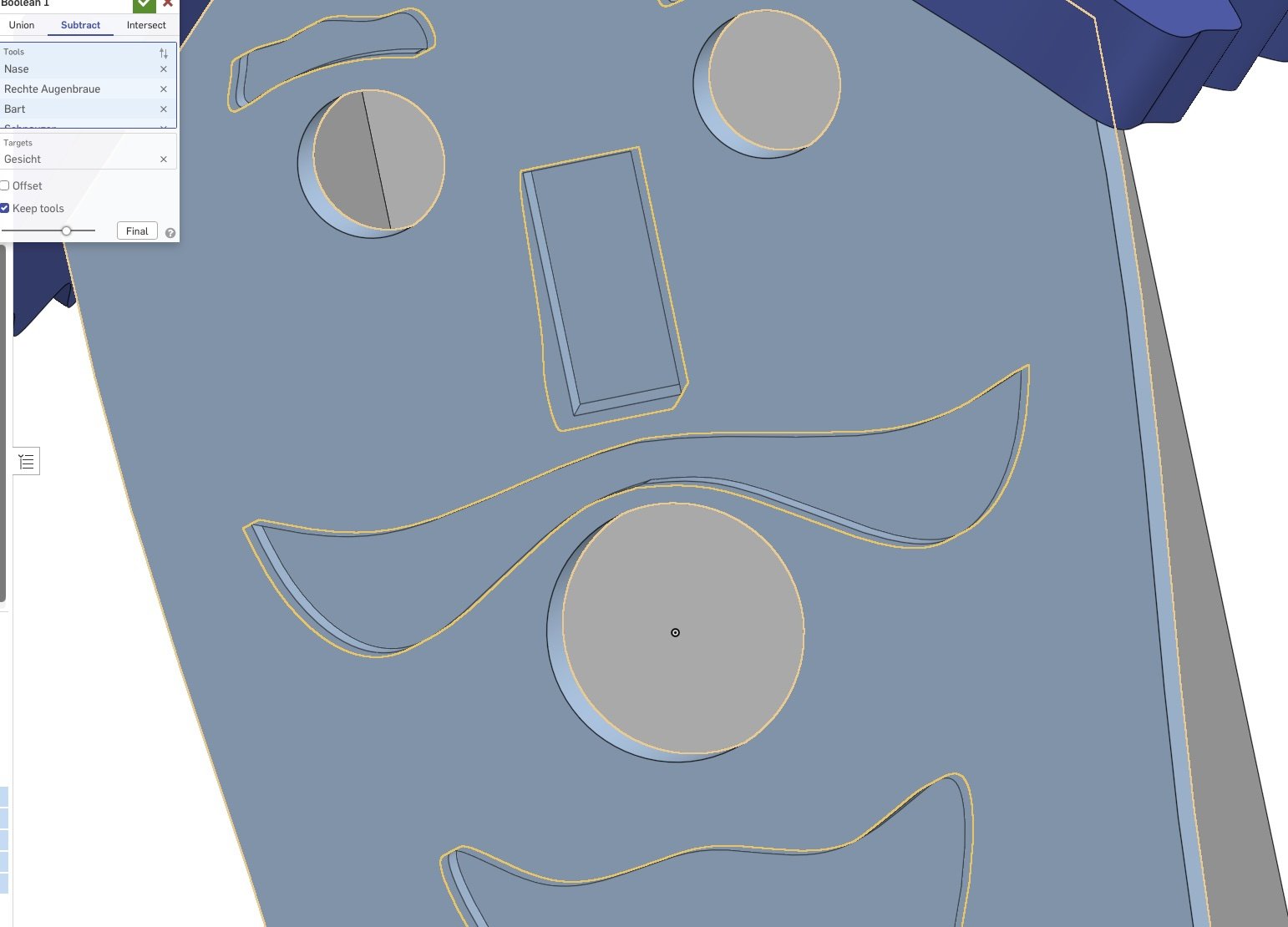

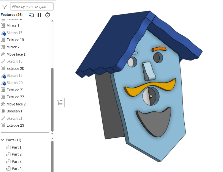

Hello,
I would like to mill a few millimetres into the front of this birdhouse to create the shape of the eyebrows, moustache, nose and beard so that they are easier to attach.
How do I transfer these shapes to the surface?
Please note that many sketches are red, but they still work.
I keep getting the message ‘Some external references are missing’ even though there are none. How can this be explained?
Kind regards
Proape

    How can I enlarge these recesses by 0.1 mm so that the parts fit in without having to grind them down?

  • robert_scott_jr_robert_scott_jr_ Member Posts: 743 ✭✭✭
    Move Face should do it. However, the Boolean Subtract feature you used has an 'offset' selection that'll do the job. - Scotty

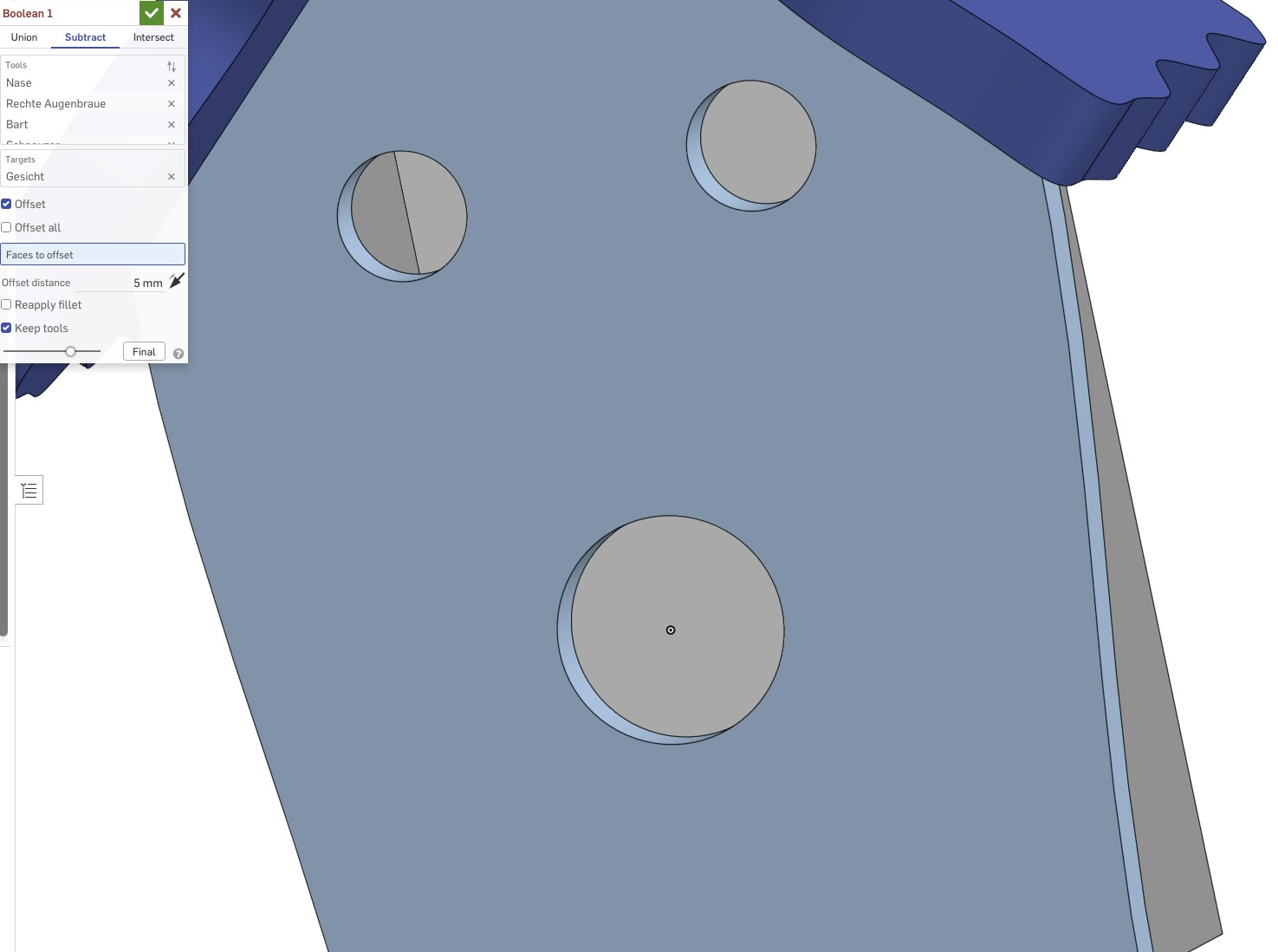

  • ProApeProApe Member Posts: 231 ✭✭
    When I open Boolean, these sections are there, but as soon as I tick the box next to Offset, they disappear.
    But Move Surface works very well and is easy!

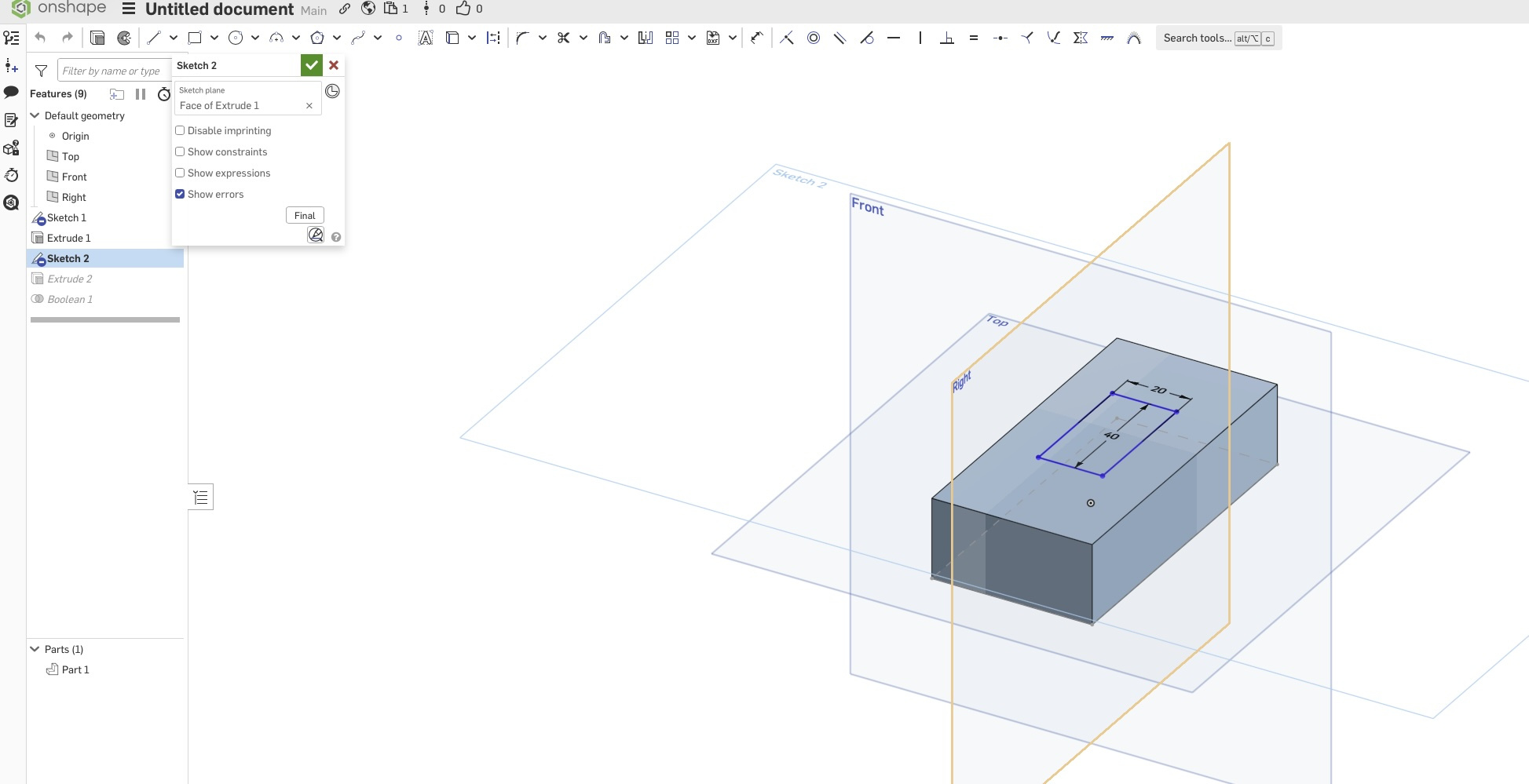

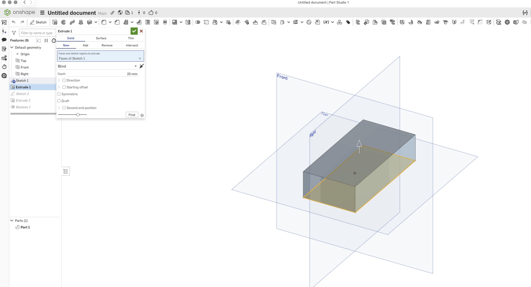

    So I wanted to test this and created a new document with an extruded rectangle (Extrude 1) and a smaller extruded rectangle on top of it (Extrude 2). I wanted to subtract the smaller one from the larger one using a subtract Boolean operation, then enlarge the area of the section with Move Face so that it was visible (and I could measure it because the lines are straight).
    But now the large extruded rectangle disappears, and I don't understand why.
    Why does it disappear?

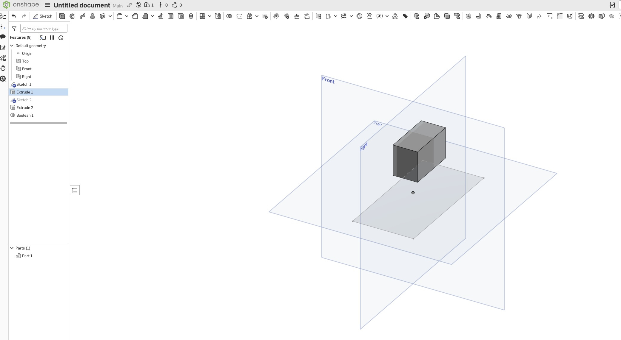

    The 2 parts you drew do not overlap. Nothing to subtract. Your Boolean selects the same part as tool and affected part.
    Notice in my sample that the extrude of part 2 is in 2 directions to provide the overlap.

    But I put the sketch of the smaller part straight on the top of the bigger one.
    And why doesn't it appear when I select Extrude 1? It only appears when I make a double click to open the extrusion dialogue.

    Your Boolean subtracts part1 from part1. Your target needs to be part1 and tool is part2 with keep tools checked. Part2 needs to be extended into part1. I used second extrude distance to overlap the parts and new for part2. For the clearance use offset during the Boolean. You'll have to select the faces around part1 for the offset.

    Okay, that's understandable and logical, but in my example there is only one part, even though I created two. So I can't subtract one from the other if there is only one in the Boolean dialogue.
    Get rid of your boolean and restart with a new boolean following instructions above. When you subtract part1 from part1 you eliminate part1 and part2 steps up in the list to become part1.

    Here's an other version that may help to understand. Open each feature in order so you can see the build method. This one uses a move face to get the overlap instead of extrude in both directions which may be easier to understand. 😀

    Okay, I think I finally understand: it's not enough that the small part was created on the large part, there must also be an intersection between the two, and this intersection corresponds to the material that is removed from the large part by the Boolean abstraction.
