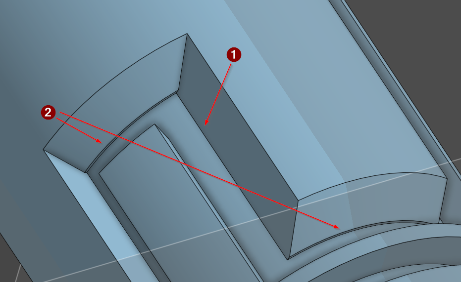

→ Problem: I want to chamfer the outline like in the above example. I know i can do that after wrapping, but the remove option of the wrapping does not create 'straight' walls (size of the cutout is bigger on the cylinder surface as it is on the bottom of the cutout). So when i do a chamfer on the edges of the cutout, the chamfer does not go all the way to the bottom everywhere. it is a little bit hard to describe, so i post a picture to show:
The depth of the cutout is 3mm
  1. Vertical chamfers go all the way to the bottom
  2. Horizontal chamfers don't
In the particular case of the puzzle box, this may work anyway, but it doesn't seem to be the right way to do this, as for another application, this may not work. For example if i want the cutout to be round, have a T-shape or a dovetail. In those cases, I would need another approach.

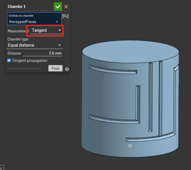

    I finally figured it out. It's a bit of a weird workaround, but the trick is to use select Tangent instead of Offset in your Chamfer feature.
    Link to Onshape doc

    edited December 9 Answer ✓
    Link to Onshape doc

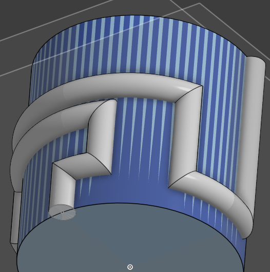

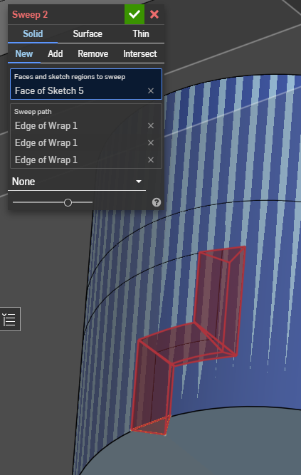

    i got it to work this way, but only with a circle face. when i tried it with a triangle shape, the sweep cannot generate properly. i think the reason is the curved path, as the first straigt section works with the triange aswell.
    circle face sweep::
    triangle face sweep:
    your two suggestions give me two ways to achieve a clean result for the current project. but i still would really like to know how i can do this with various faces.
