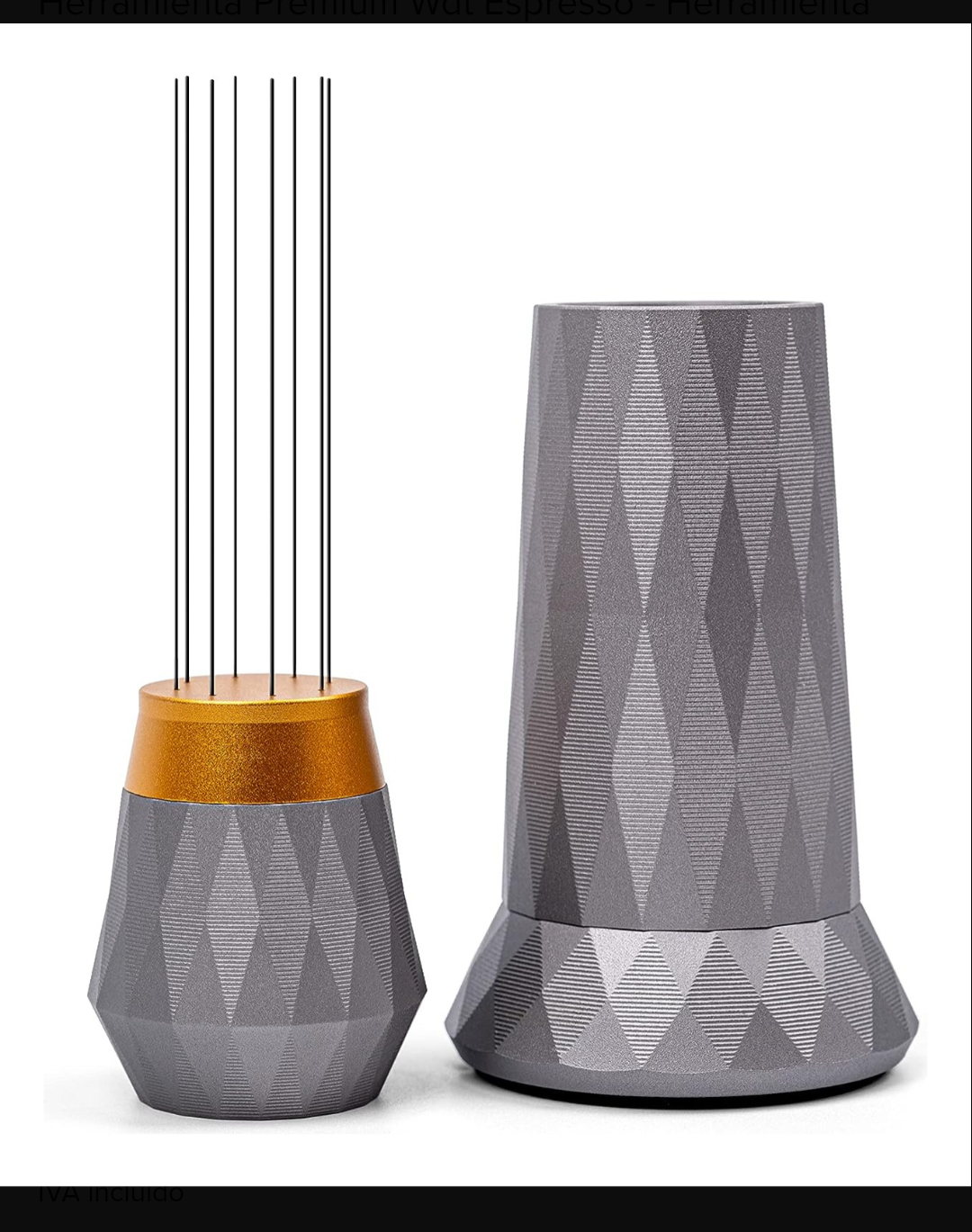

Hey Guys,
Is there any easy way to achieve something like this? Is this called like a diamond cut shape?
coulnd't help but try it. had to think a bit about sketch 3 and what to project/cut. but once you see it, it's simple.
https://cad.onshape.com/documents/3169b539bcda7d1f08db63ad/w/01054d503e668672f9baf05e/e/2ab4e8a01165995f5c71abab0
you could try this:
https://forum.onshape.com/discussion/27998/new-feature-delaunay-triangulation
Sometimes a very course STL export/import does the trick, but that's crude.
I you want full control: draw one or half of a rhombus width of the outer section manually for the full height, then mirror and circular pattern0 -
https://cad.onshape.com/documents/3169b539bcda7d1f08db63ad/w/01054d503e668672f9baf05e/e/2ab4e8a01165995f5c71abab0 -
Thank you very much for your help. Its exactly what i was looking for!
