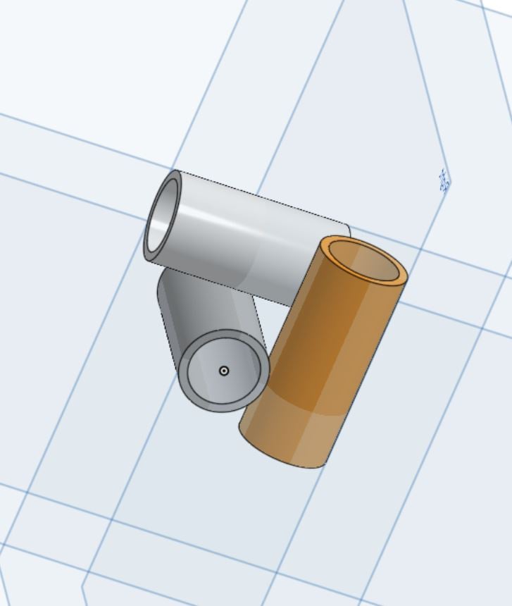

I have 3 cylinders and I want to provide extra support in the form of a rib or gusset between them. But neither of these seems to want to draw. What terminology should I be using to describe this? (See attached draft).
Thanks, Spencer
  • jelte_steur_infojelte_steur_info Member Posts: 603 PRO
    best to just sketch the section of the rib and extrude it symmetric) and then unite it to the cylinders.
  • robert_scott_jr_robert_scott_jr_ Member Posts: 695 ✭✭✭
    Hey Spencer. The terminology you used is understood. This document demonstrates how to create the rib(s). - Scotty
  • spencer_arnoldspencer_arnold Member Posts: 10
    jelte / robert,
    Grasped the concept now, thank you for your kind support! Spencer
