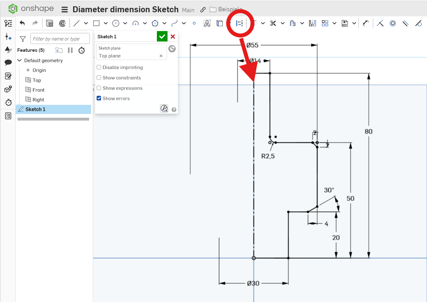

    Thanks @martin_kopplow, line with midpoint is new to me thank you. The midpoint is very important to me and you said "….I always use an explicit axis for this reason." How do make an explicit axis?
  • martin_kopplowmartin_kopplow Member Posts: 1,290 PRO
    @troy_ostrander Just draw a line and make it 'construction', maybe even constrain it fix it in the sketch. A construction line used as an axis will allow you to dimension to diameter, even if you only draw one side of a rotational or symmetrical body. I guess that this will also eliminate the need to dimension to midpoint in 99% of the possible cases.
