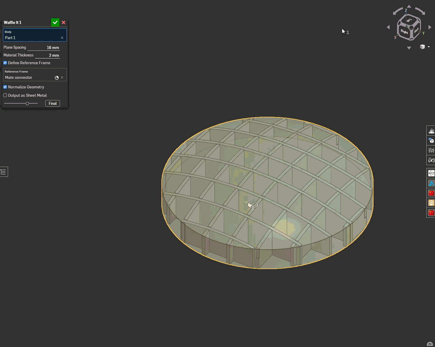

Kicking off things with the first of many slicing features comes Waffle It which takes a solid body and turns it into cross cut slices that fill out the volume of the target body. Now, there are other features that do this, so why did I go to the trouble of writing my own version as the intro to this suite? Two reasons. The first reason is that unlike all other attempts I have found in Onshape's featurescript library, I'm thinking inside the box.
Due to the methods I'm using, no edges of my slices exceed the bounding volume of the original input part. All other featurescripts I found used an intersection method that had material sticking out of the input solid. This makes for extra cleanup work if you need these slices to fit into an assembly. The second reason to use Waffle It is that it can output a sheet metal context for easy exports or drawings. Right click the context and export every slice as its own .dxf and send it.
You don't have to use this feature for sheet metal or laser cutting though, even the normalization step is optional if you'd prefer to use this as a structural springboard for plywood with mitered ends for weird corners.

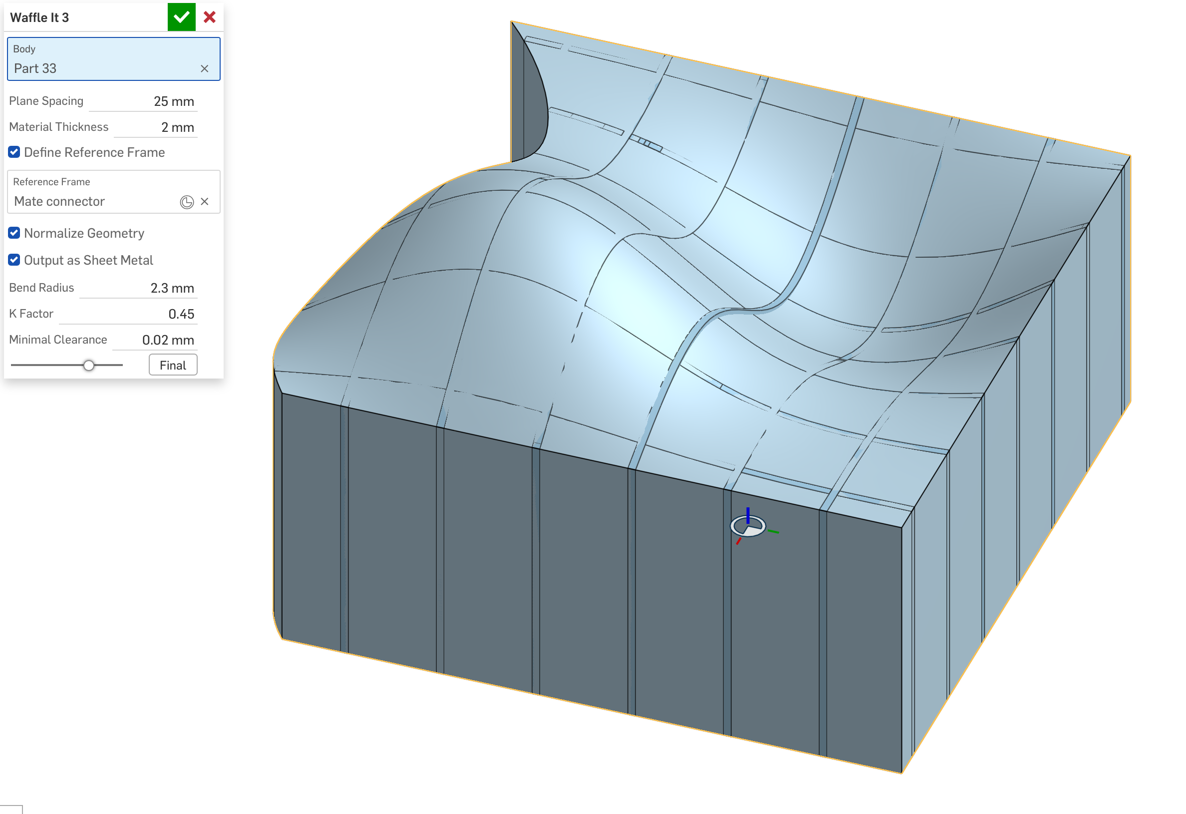

    It seems like there are still some issues with parts protruding through the exterior with Normalize and Sheet metal turned on.

    @S1mon That block is around waiting for me to figure out how to handle complex saddle curvature. There's a dumb way and a different dumb way and I didn't want to commit to either one just yet until I think of a third dumb way.
    Right now the normalization routine projects faces to the slice plane and then thickens them the direction of the face normal of the slice and removes the wonky bits. Fails on saddle faces like that one where the projection operation doesn't like the doubled back faces. I could do an isocline at 0 degrees to split those faces but that doesn't always work I've found. I could do a small thicken on the errant faces and project that to the slice which should resolve some issues but not all, I could copy the original solid, draw a box around that copied solid, remove the copy from the box leaving a negative, then use the hollowed box to boolean subtract the sheet metal and hope the subtractive operation cuts away all the remaining outside slice faces.
    Rest assured I'll be dealing with that slice at some point, but I published a bit early because @ry_gb mentioned waffles in the other thread and that warranted a response.
    S1mon Member Posts: 4,588 PRO
    What about creating two parts, one which is driven by the intersection of one face of the rib and the other which is driven by the other face, and then your final rib is the intersection of those two parts?
  • Derek_Van_Allen_BD
    Doesn't handle cases where the curvature dips in between the faces. Thought about that, but that would make it too easy.
    Ugh. So maybe that was dumb idea #0?
    So here's dumb idea #0.5:
    For most things that I could imagine using this tool for, sampling (so to speak) the front, back, and the mid-plane of each rib and taking the intersection of all of those might be enough. Within the tolerances of cutting such ribs and the curvature changes of the surfaces you're simulating, that might be enough.
    Yeah that's probably a good enough approximation for many workflows but I'm too stubborn to settle for the approximation. Hence why I was bothered enough to not just use the existing slicer scripts in the first place. I've actually got a decent amount of confidence in the sheet metal remove method but it's gonna be an enormous performance hog more than likely. I'm gonna keep thinking about it.

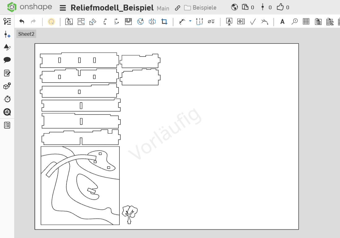

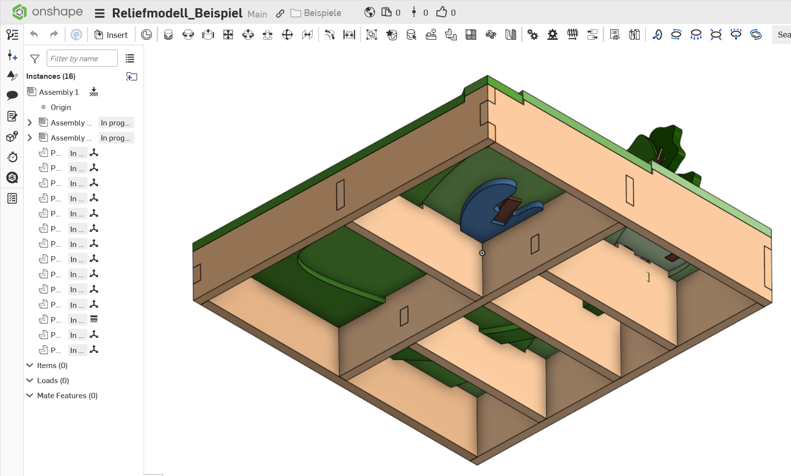

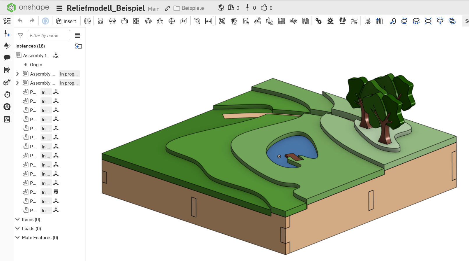

    This FS might be very helpful for those building terrain models out of laser cut wood/MDF parts.
    This is a simple sample I once made for the students. The workflow could now be made much faster.
