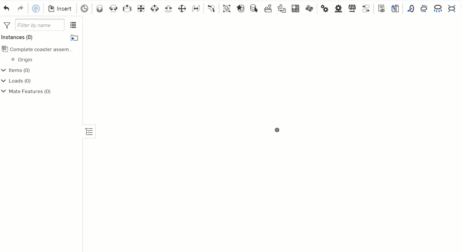

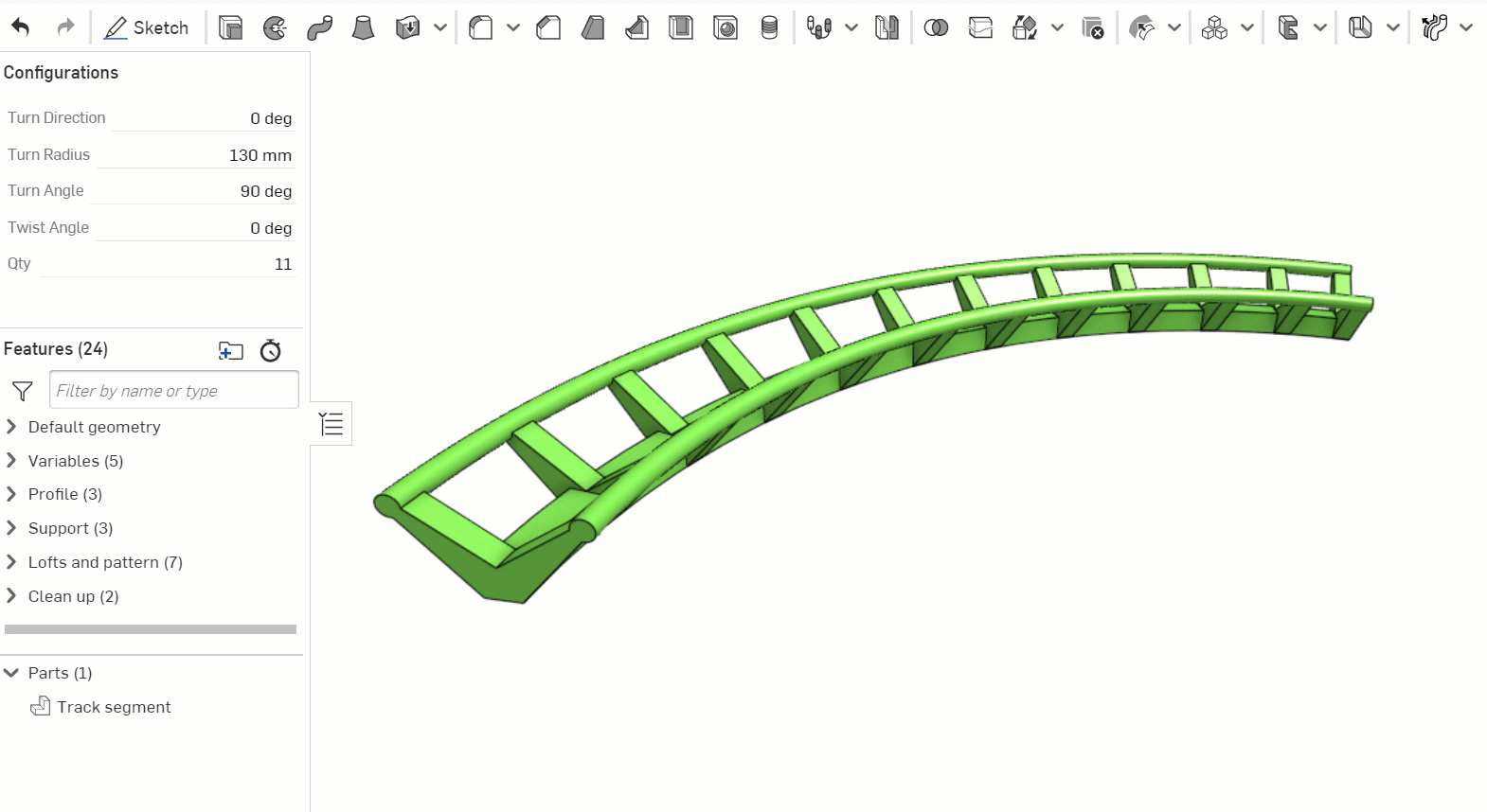

Derek Van Allen | Engineering Consultant | MeddlerUsing @Derek_Van_Allen_BD's new tweep feature, you can configure a part studio to make rail segments, then insert those segments into an assembly. Next you would need to design where the supports go and run multiple FEA on the entire thing.
Here is an example of how to insert and snap configured parts into an assembly:
https://cad.onshape.com/documents/ed4854784a976b004aa8b988/w/c903869eb24eb1923ab12990/e/640174d836e83...
And here is an example of a configured track segment part studio:
https://cad.onshape.com/documents/ed4854784a976b004aa8b988/w/c903869eb24eb1923ab12990/e/0d36e74d...

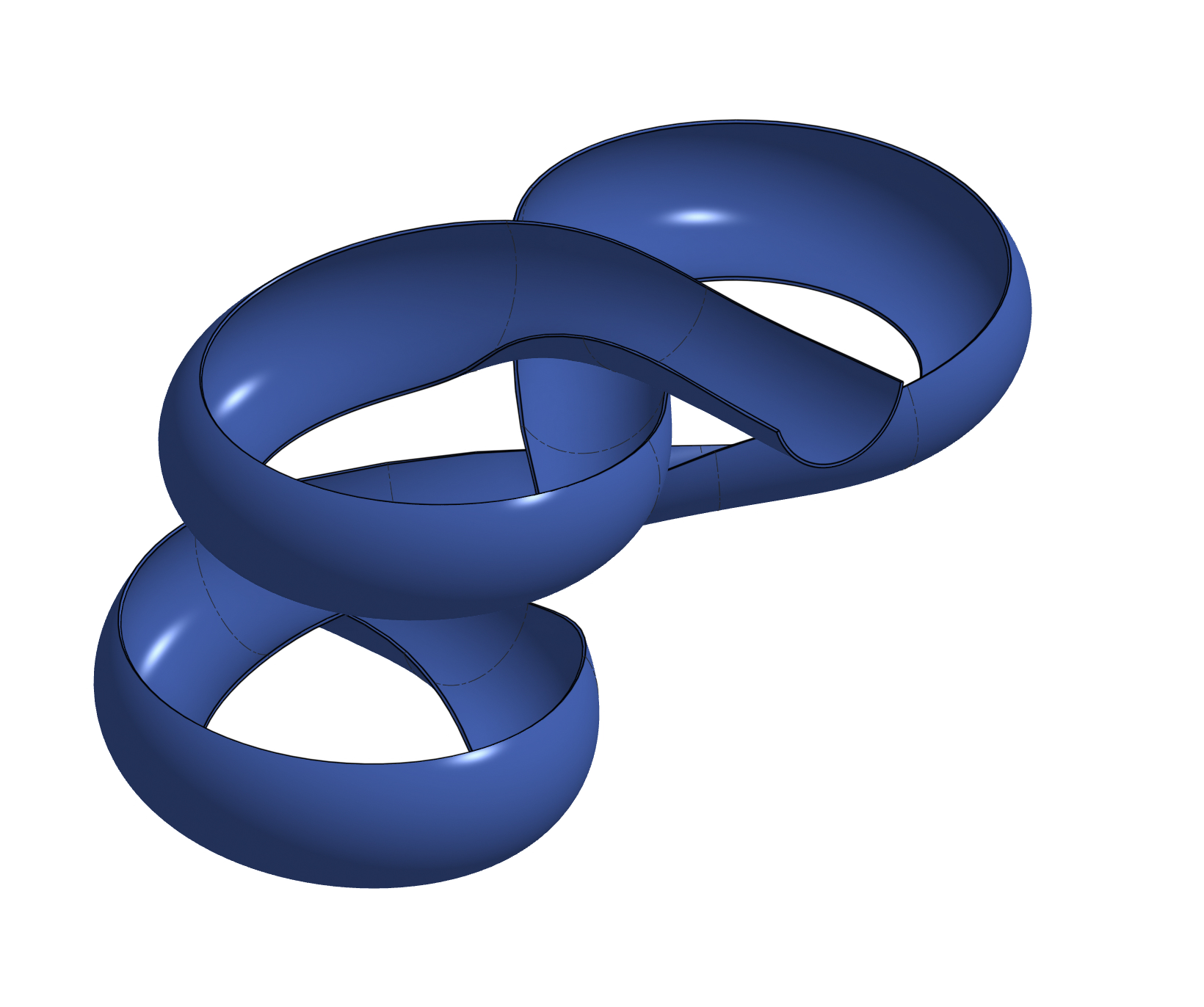

@caleb_alexis The best way I've found for good dynamic control over banking is using a Ruled Surface feature set to "angle from direction" and "cubic interpolation" then adding point overrides and using those to bank it. The ruled surface can be used as an input for Sweep later. Since you're already generating a CSV though, you might be able to also generate a curve to control banking and Loft from your center curve to this one and get the same result, but controlled only by your CSV.
