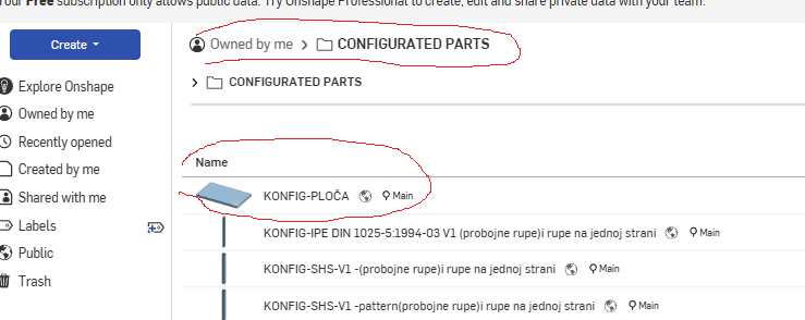

Hello,
I have some problem with configurated parts. I am on free Onshape account.I make my own configurated part with some hole and dimensions, I have it in my library folder. I duplicate it, and insert like a part in some new project in part studio give it name "PART" and use it like a base in that project . Frome that place I will duplicate It more times in different variations and every time give different name "PART2", "PART3"...with different set of holes and dimensions. That parts I will insert and make assembly of it. Problem is when I open some of these configurated parts "PART 2", "PART 3"...It will look like its not configurated any more. It lost all holes and dimensions how I set it. Goes back in some early stage, without anything. Like Onshape lost configuration. I can not use release, cause I am on free account. If someone can help me ? Thanks in advance.
Velimir

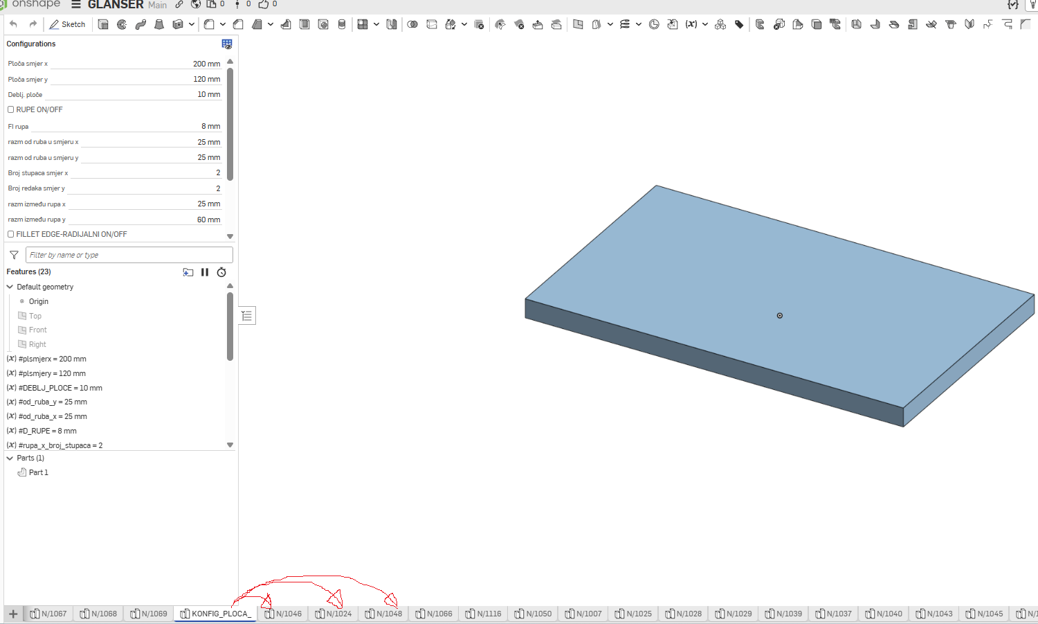

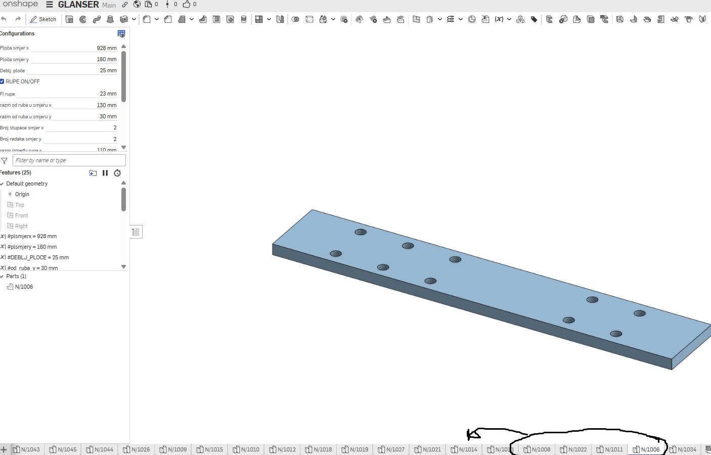

    I have problem in how to use configurated parts when created. I create first that " konfig-ploča" have it in my folder. When create some new document, I want to use it like a base, for similar parts like that.. just make more variations..So I duplicate it, rename it like N/1006, N/1011,N... all those parts I will insert in assembly later. When I close my document, open it next day, I check that part N/1006, and some others it looks like its not configurated, without holes, wrong dimenzions..I attach some screenshots

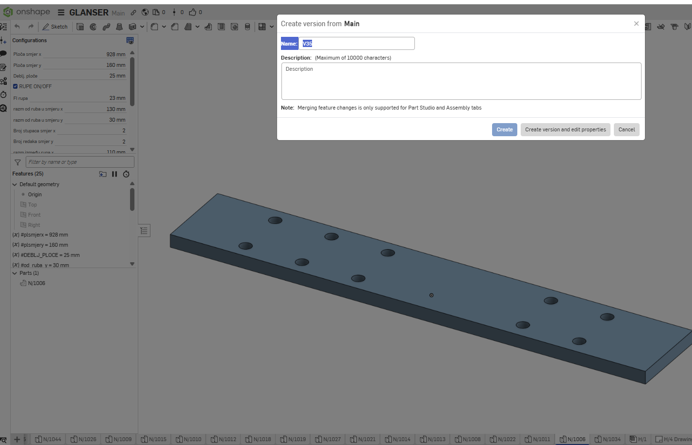

  • velimir_družinecvelimir_družinec Member Posts: 4 ✭✭
