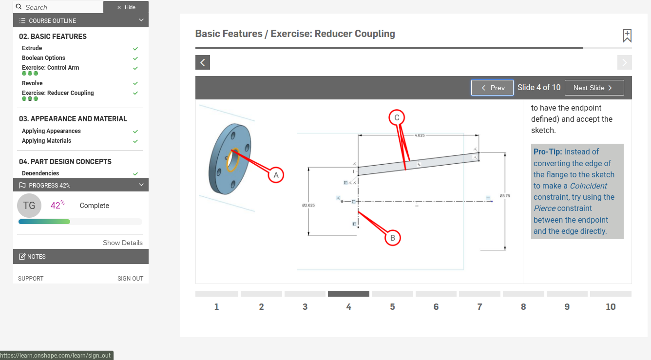

hey I currently trying to take the Introduction to Part Studios and I'm trying to make the part for it I tried to find any problems but I couldn't and I'm getting different sizes and surface area can I get some help, https://cad.onshape.com/documents/14547d652de9e1a3a496d85d/w/b2f1dea0dddd9491365aba92/e/9514e34d174575d6f8d5b0a8?renderMode=0&uiState=694438890944c63e58b70501

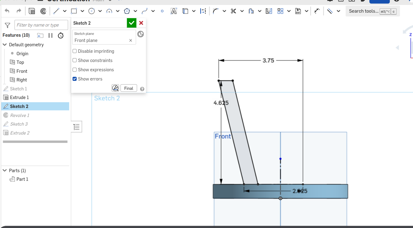

    Double-check Sketch 2. I don't think the part is supposed to look like this:

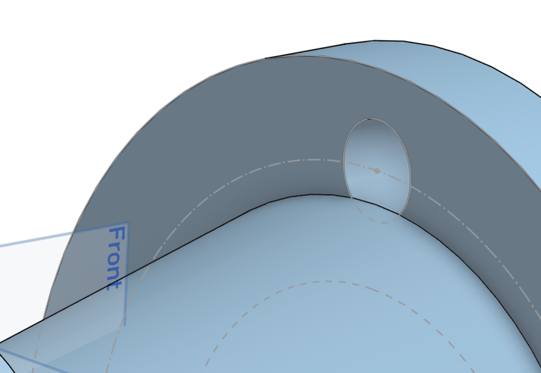

  • tyler_geiger873tyler_geiger873 Member Posts: 11
    hey I checked it and I still cant figure it out my dimensions are correct

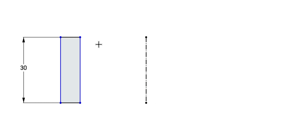

  • S1monS1mon Member Posts: 3,986 PRO
    To get diameter dimensions you need to click on the entity, the center line and then just beyond the centerline.
    thank you so much that was the problem i completely forgot about that.
