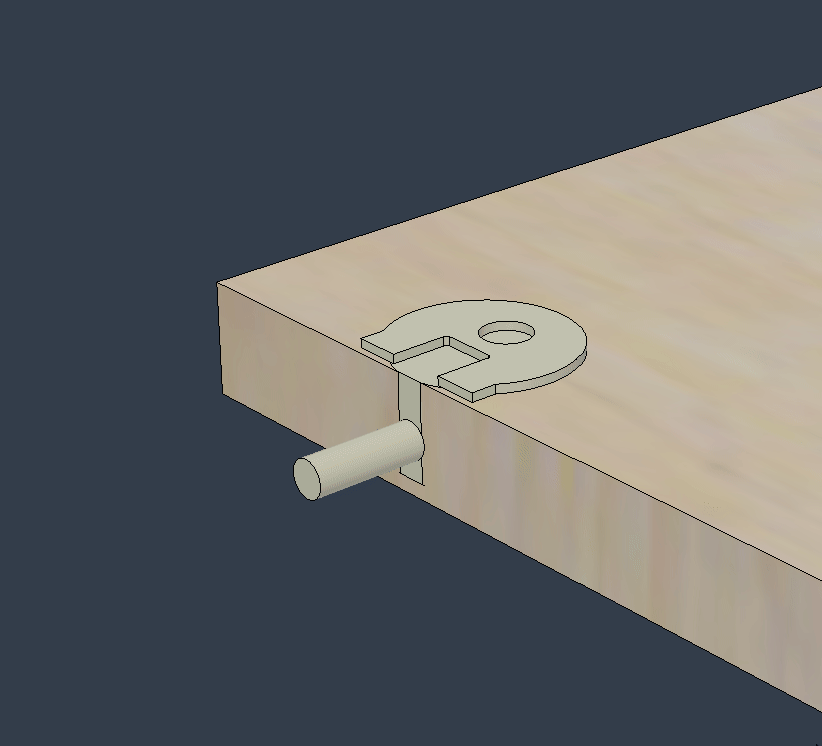

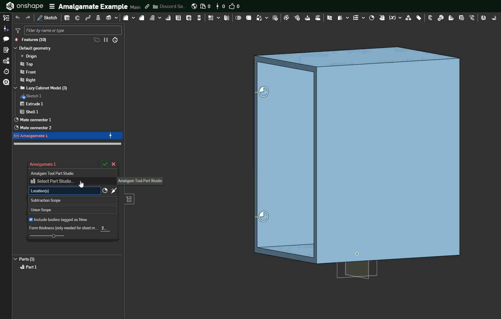

    Quick gross example of cabinet hardware I pulled from McMaster Carr and lazily slapped together with bad positioning but just to prove the concept. The same philosophy of using Super Derive or Point Derive led me to developing my custom Amalgamate feature which has the advantage of allowing you to pre-define which tool bodies are meant for subtraction operations or union operations in the seed part studio, as well as letting you do both subtractive and additive operations in the same step.
    It has the option to insert the parts from the seed studio right into your part document if you want, or not if you don't want to have a weird BOM with duplicate entries. Here's a demo video of me tagging my subtractive bodies and insertion bodies for this hinge. (No union tools because we're only cutting holes, not adding to the cabinet geometry)
    And here's a demo of the Amalgamate feature being applied (I pre-placed mate connectors to make the selection fast enough to fit in a gif)
  • Derek_Van_Allen_BDDerek_Van_Allen_BD Member Posts: 690 PRO
    If you use the insertion function of Amalgamate your inserted parts will always be synced with the geometry that goes with them. Downside is that the BOM will show all of your shelf pins as 1 of 1 so it just comes down to whether or not the BOM details are important to you or if the sync is more important to you. In my industry everything is essentially treated as 1 of 1 BOM items so we don't mind the funky way it reports at the assembly level.

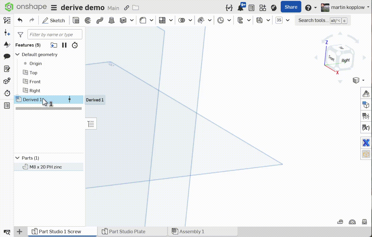

    In Context can be powerful, but if used exessively, it'll get out of hand rather sooner than later. The derive approach is more targeted and can be traced back easier than the various levels of contexts of in-context dependencies that may come into existence. I'd only use that to create assembly-driven skeleton geometry, but not details.
    You could try Derek's approach. Or, you could derive in two steps:
    1. Derive the config of fastener you want to use into your current document (separate Part Studio tab).
    2. Use that as common source for boolean (derived) and assembly (inserted).
    It all depends on complexity of the fastener model. The above will work if it is simple in a way that has identical geomery for the boolean and the assembly. You could then edit the first derive operation to drive both configurations.
    In my case , there would probably be too much detail on the fastener model (I do frequently create renderings off the same assembly) to use it for booleans anyway. I'd resort to deriving it into my part studio as decribed, but instead of doing a boolean, I'd only use certain key geometry (like diameter, depth and centerpoint) to create the cutout, or ideally only position it and then use e.g. a hole feature to remove the material. That way, I can later edit it easily, I get hole tables and hole callouts in my drawings and so on. It depends on what you are after …
    For some stuff, I have a detailed model of say the fastener and the same document also holds a simplified model that only defines the volume.
    Anyway here's a demo of the above process. I used an external document that hase a configurator to create the fastener I wanted to use/derive. Then I used that for the part studio boolean and also for the assembly. After updating the initial config, both update:
    I hope it comes clear. What a pity I cannot upload vids with audio here.

    @martin_kopplow for kicks I decided to torture test the amalgamate feature with a part using the worst performing geometry I could think of just to see how it would do. 70+ second rebuild time in the seed studio for a single knurled "bolt" with knurled threads, but with some clever configuring to simplify geometry I can get a build time of ~ .3 seconds to swiss cheese this polyhedron with perfect holes to hold a bunch of them. I also made it so the high detailed version of the studio had the tag feature suppressed just to prevent anyone from actually attempting to use the 70 second rebuild time version of the model for renders as tool geometry. The inner workings of both our methods rely on the same derive architecture in reality, all my feature is doing is wrapping that up into a tighter UI to minimize the number of extra steps you need to take on the import side of things.
