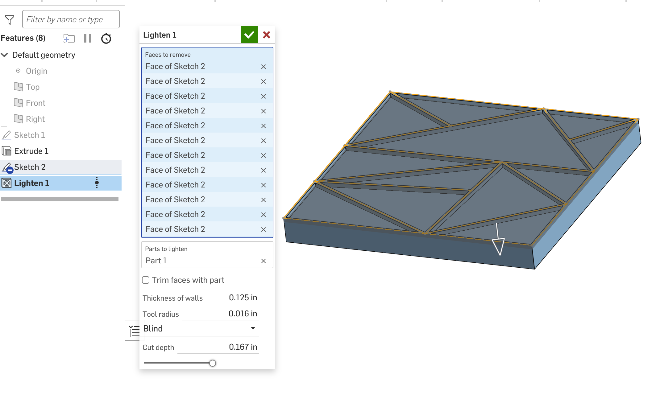

Now I got stuck in using lines along with extruding these.
I assume I have to "convert" lines to an area (e.g. rectangle) in order to extrude them. In my case this can be very time consuming so I´m looking for a batter way.
By now I tried to use different extrude-options as well as thickening lines - without luck.
In my case (see attached screenshot) I´m trying to apply a kind of "line"-texture on a small 3D-model.
What is the best approach to do so?

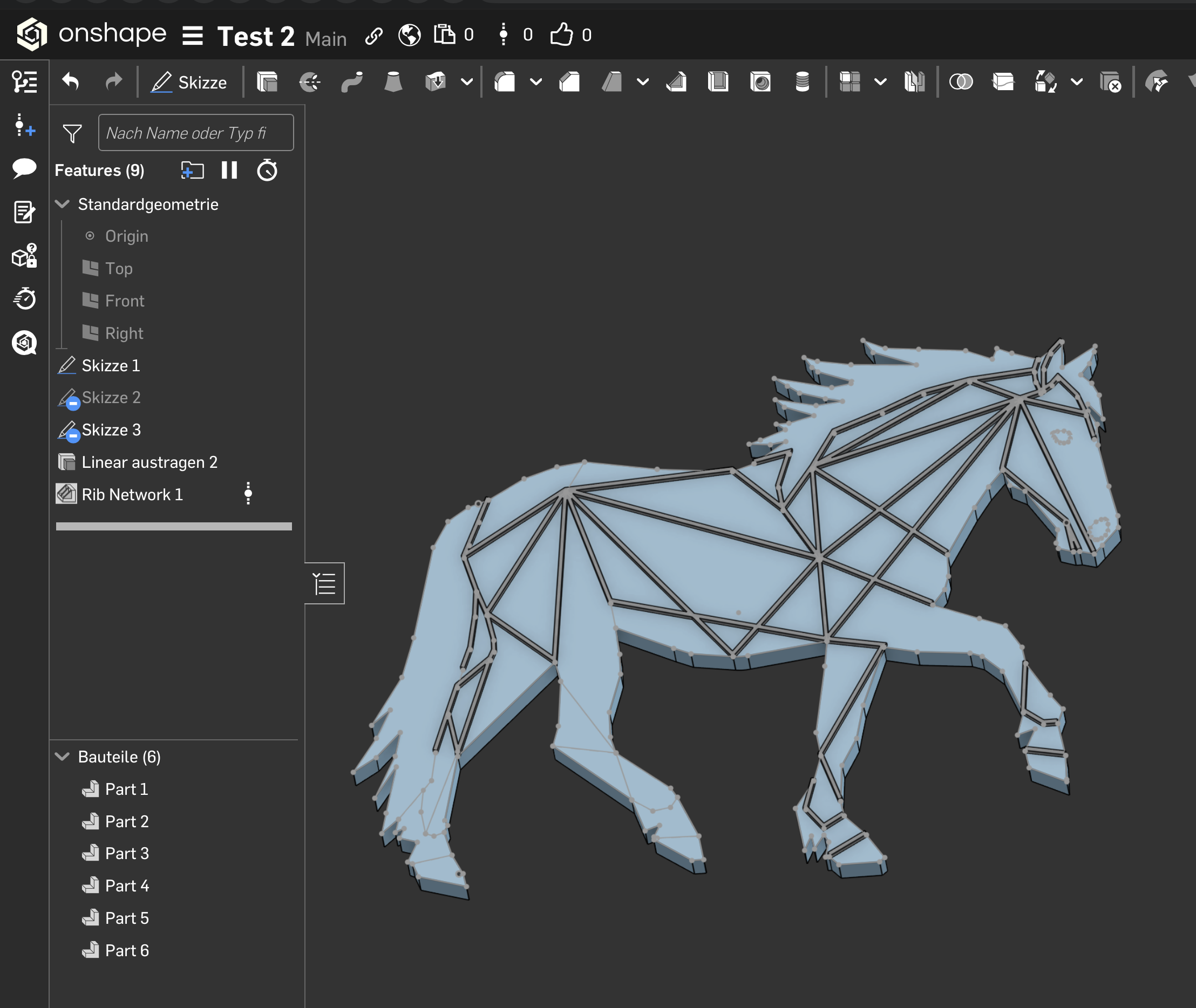

There's a FS called "rib network " that should do what you want
Bullseye! You made day!

Hey, thanks for your reply!
Unfortunately it doesn't help me out. It appears that the Lighten feature allows to select parts (areas) instead of lines.
