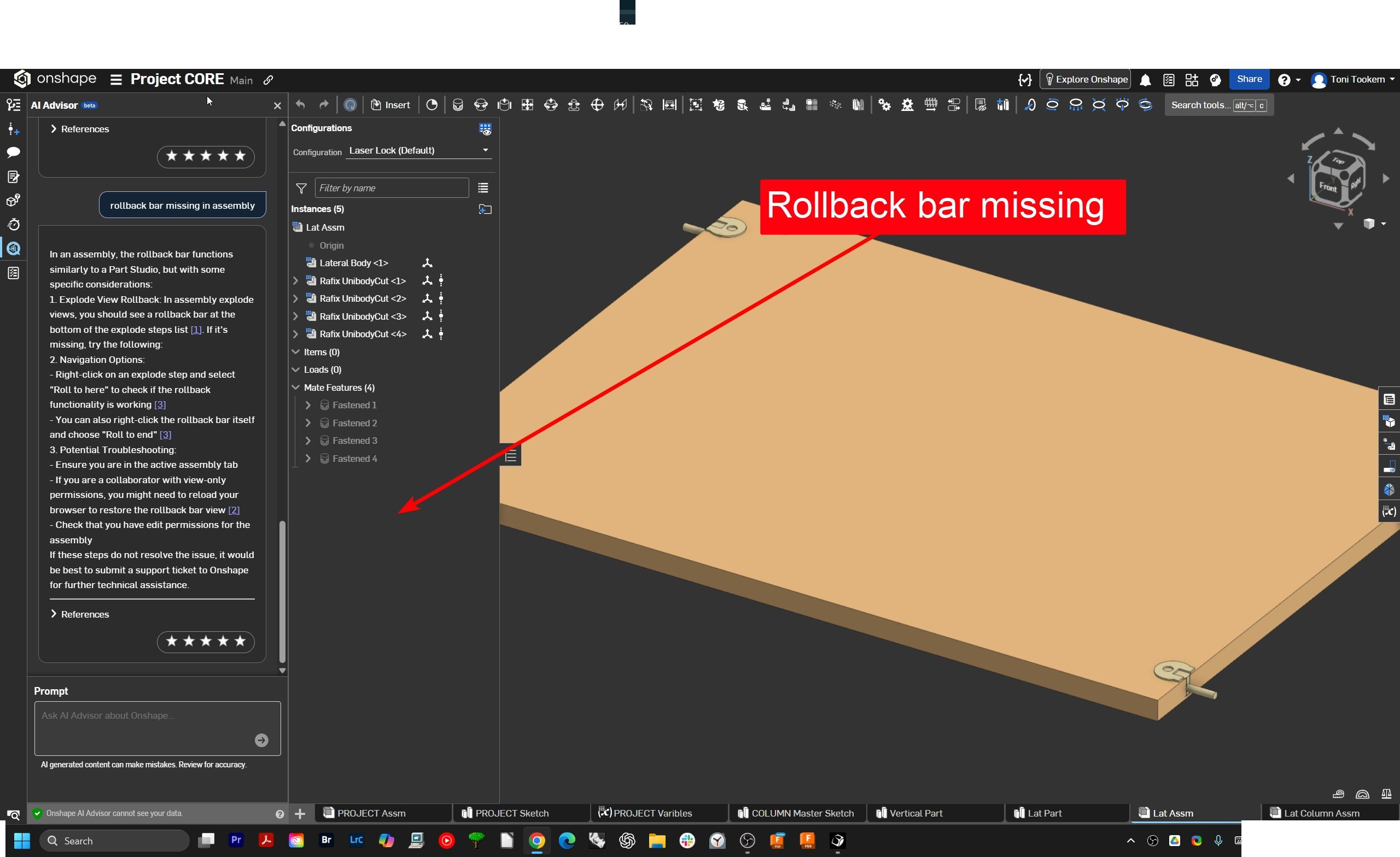

Rollback bar missing

    The rollback bar is only present in Part Studios or during in context editing (which basically a part studio overlaid over the assembly). Assemblies don't have their own history: Everything can be edited without respecting the sequence of creation.

    That's an assembly!

    OK thanks I got it. Now I know. 🙏 The AI Advisor was a little misleading.
