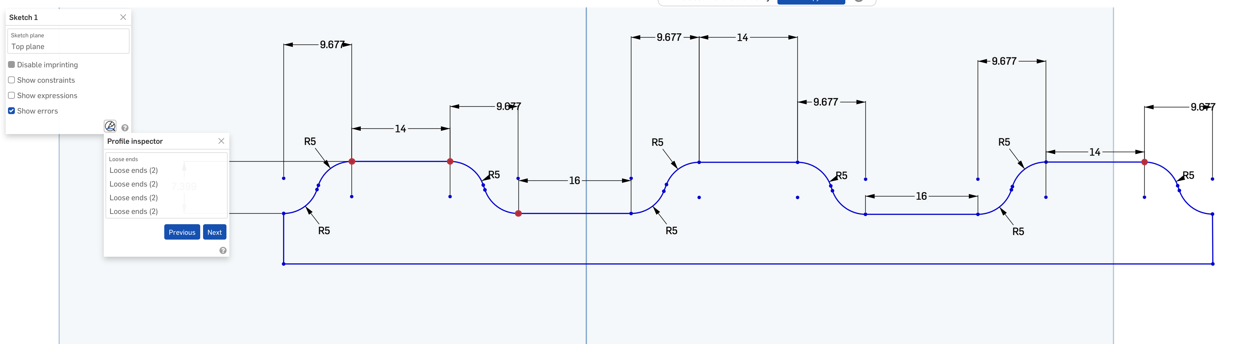

How do I make this a closed shape.
steve_western
Member Posts: 4 ✭
in Drawings
Hi there, I am new to CAD and have been using the Too Tall Toby site to learn, I have this profile which I want to extrude, however I cannot get it to a closed shape, I have redrawn it so many times and always end up here.
Any help gratefully appreciated
Link to the part I'm struggling with. https://cad.onshape.com/documents/5338f68fc35b474fe0228a45/w/42097db8f13963835a82dcea/e/6cfdcdab4b711f7d796b2161
You can use the Profile inspector to find the gaps.

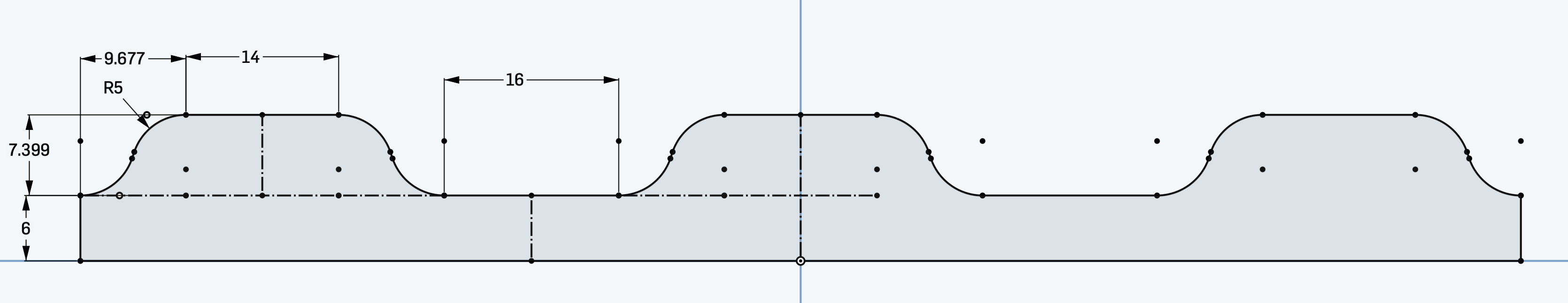

This is a pretty crazy way to construct a shape like this. Any time you find yourself repeating things this many times, it's a sign that you've more than likely done something that's overly complicated. At the bare minimum, even if you have these repetitive shapes in the same sketch because you need to construct things to find the overall length, you can set stuff equal so you don't need to dimension the same values 10 times.
Depending on what you might want to change and what you want to solve for, there are a zillion ways to model this. You could solve it all in a single sketch, or you could make the bumps as features and pattern them. You could add the fillets in the sketch or as features after the fact. Assuming you have a very good reason to do all this in a single sketch, you can take advantage of equals and mirror constraints (or you could use a sketch pattern).
https://cad.onshape.com/documents/50a201754245e798b144981d/w/3b6f2e99c88e89b1603f9ba2/e/147a49e8c341836da98d471c
@S1mon, thank you. Only been using onshape for a couple of months and every single session is a learning experience, didnt even know the profile inspector existed.
Some of the tools and methodologies you have mentioned you may as well be speaking in mandarin.
Once again thank you and Happy Christmas.
The profile inspector is a bit hidden.
