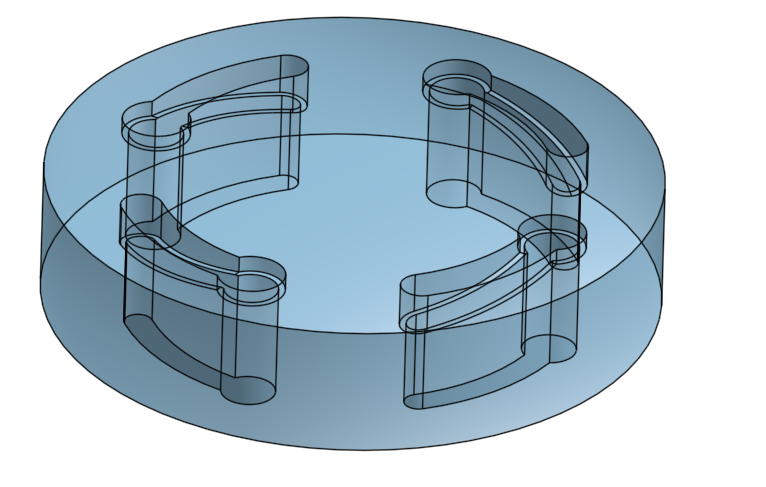

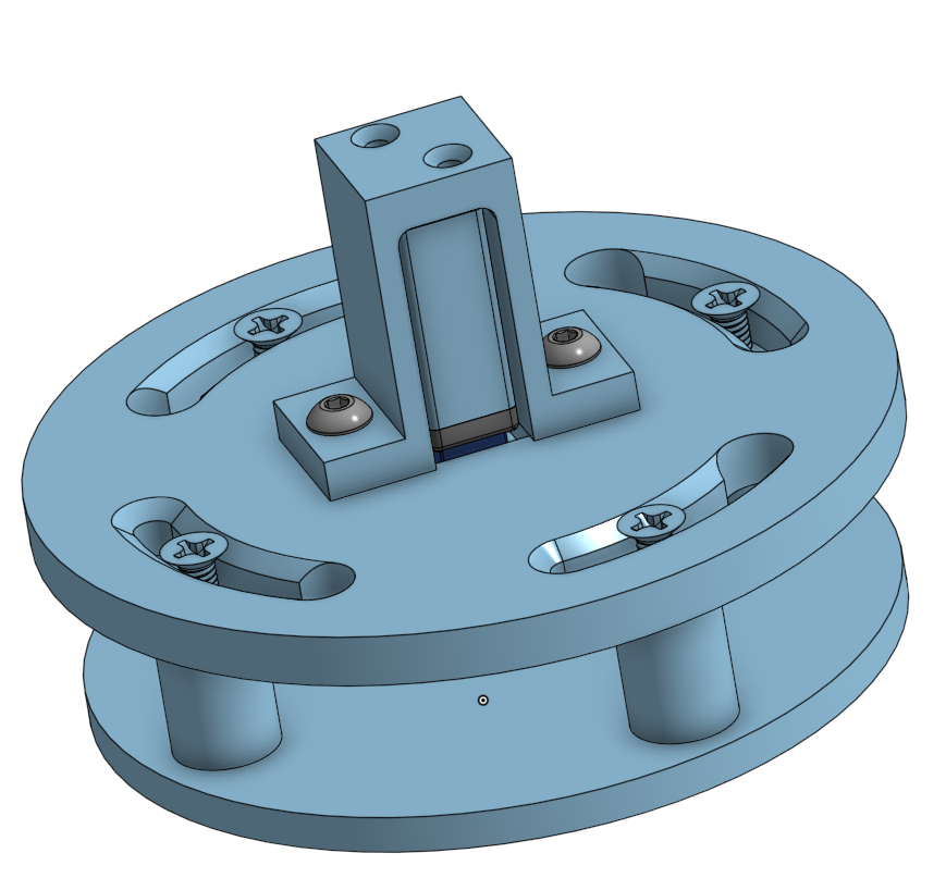

I am currently struggling with a project that I am working on, and I wanted to see if anyone had any tips for me with the right way to fix this issue I am having. I am currently trying to update a design I have been working on, which is pictured below. In this design, I am trying to create a channel in order to allow a screw to sit above it while locking this top piece into place relative to a lower piece. I am also attaching a photo of the full design to help with understanding how this piece interconnects with everything else.

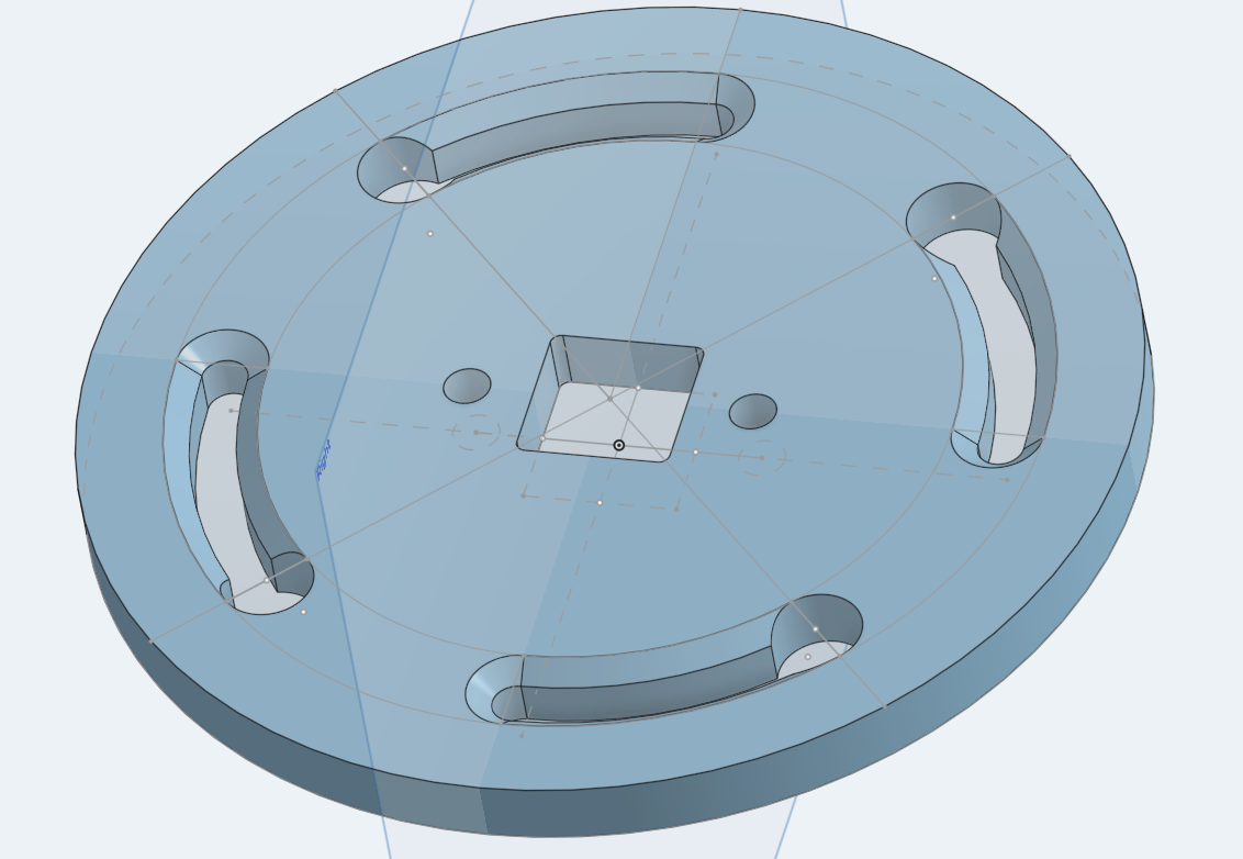

For the updated design, I am trying to give it a self-tightening mechanism as I turn the piece without needing to tighten the screw slotted in place by changing the angle between the open hole and the curved section at the other end. My current plan is to have the angle on the right be the same, but on the left side of the opening, having this be flat with the top, with a curve connecting these openings. I have tried using a bridging curve to get the specific shape I am looking for, but I am unable to extrude it in a way to get the correct shape like what I have in the original design. Does anyone know of any other tools I could use to create this curve successfully.

    Hey Zach. Check out this video. Perhaps a method you could use. - Scotty
  • John_P_DesiletsJohn_P_Desilets Onshape Employees, csevp Posts: 271 image
    edited December 2025
    @zach_oconnell Take a look at this document. Not sure if this is what you are looking to do or not but it demonstrates a few workflows for making a cam-like feature for locking. Is this what you are looking for?
